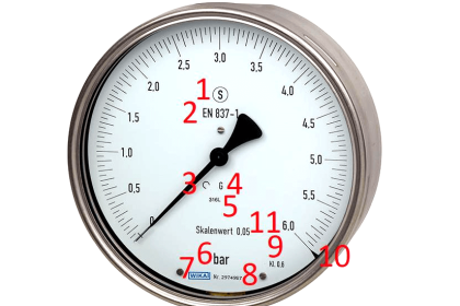

Details of UUC
Note down details of UUC as the name of Instrument (Pressure Gauge/Vacuum Gauge/Compound Gauge), Identification Number, Make, Range, Resolution, Accuracy, Calibration Date, Recommended Due Date, Environmental Conditions
Details of Master Equipment used
Note down Name of Master Equipment and Identification Number
Readings
This is the most important part of the Raw Data Sheet. As Instrument is said to be Okay or Faulty according to readings entered.
The above Raw Datasheet is for pressure Gauge Calibration of accuracy less than 0.6% (Table 1) and accuracy greater than 0.6 % (Table 2)
First Column is of Calibration Point
For Pressure gauge accuracy less than 0.6 %, it is 9 point calibration. Therefore choose 9 points covering the full range including zero. Refer Table 1
For Pressure gauge accuracy of more than 0.6 %, it is 5 point calibration. Therefore choose 5 points covering the full range including zero.  Refer Table 2
Second Column is of UUC/Master Reading
If Calibration Point is attained on UUC and corresponding reading is measure on Standard Pressure Gauge. Mark UUC Reading on above Table and note down corresponding UUC reading as Calibration point is attained.
If Calibration Point is attained on Master and corresponding reading is measure on UUC Pressure Gauge. Mark Master Reading on above Table and note down corresponding Master reading as Calibration point is attained.
