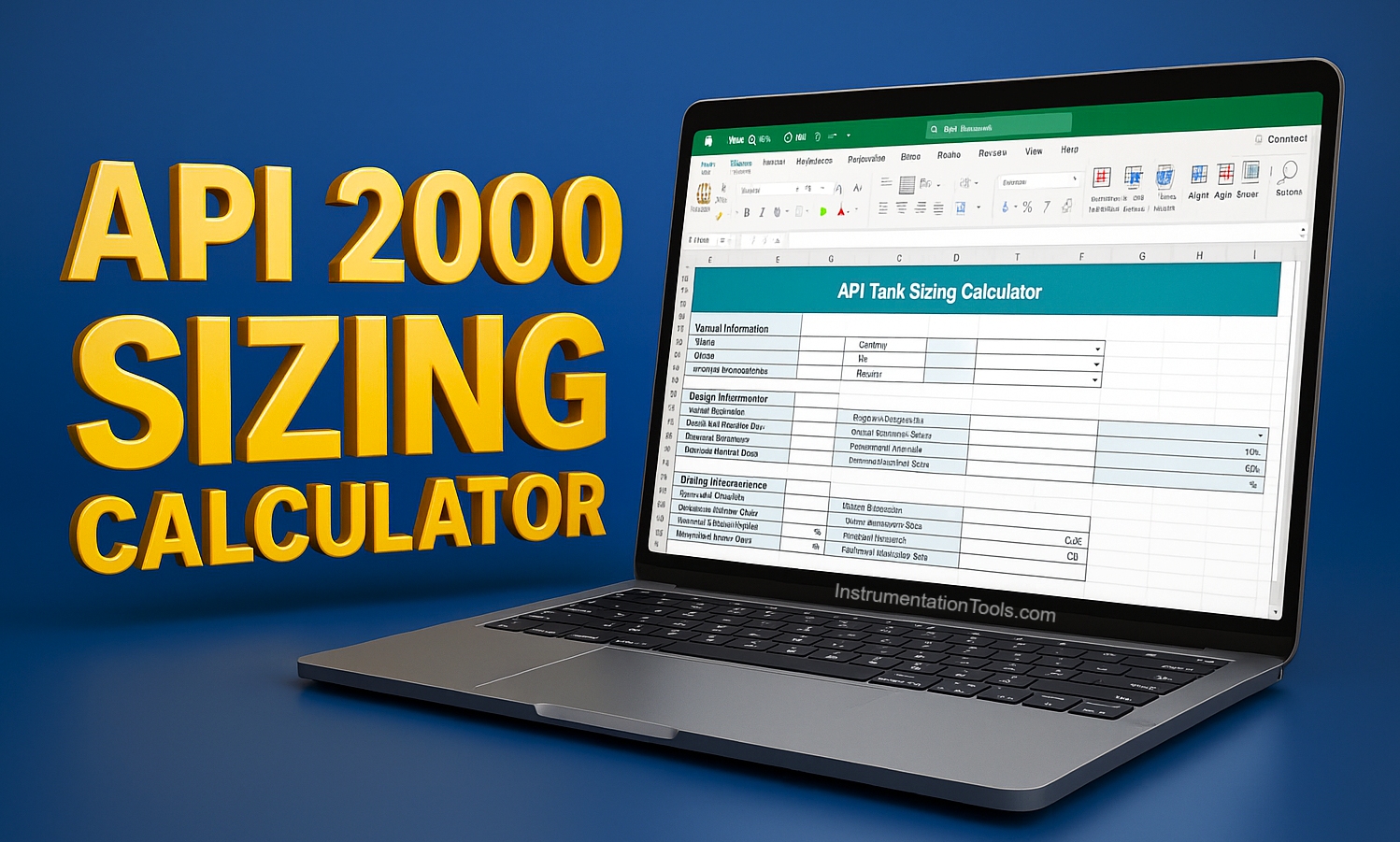

API 2000 Sizing Calculator - Tank Blanketing Valves
Open the Excel file (you may need to enable macros if prompted).
On the main page, you’ll see clearly labeled input fields.
Enter the required data:
  • Tank volume
  • Filling/emptying rate (in cubic meters/hr or gallons/min)
  • Temperature range
  • Blanketing gas info
  • Any emergency flow cases (if applicable)
The calculator automatically runs the sizing logic in the background using API 2000 formulas.
It provides:
  • Required flow capacity
  • Suggested valve size
  • Operating set points (pressure and vacuum)
  • And any warnings or limits exceeded
