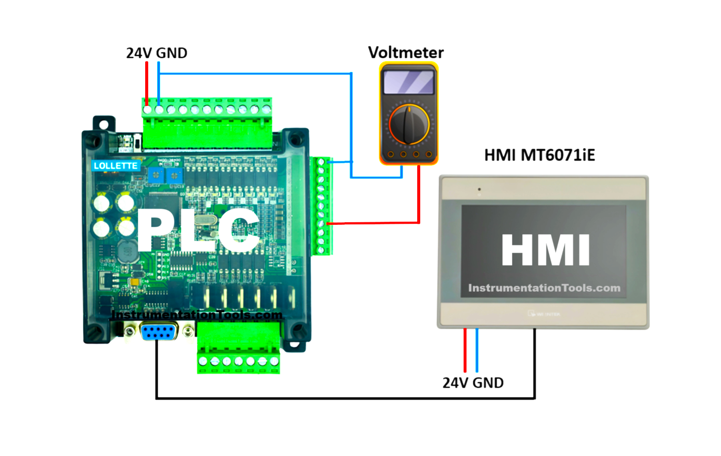

DB9 RS-232 Male to Female Cable
This cable connects PLC to HMI, where the female socket connects to the COM1 port on HMI, and the male plug connects to the RS-232 female port on PLC.

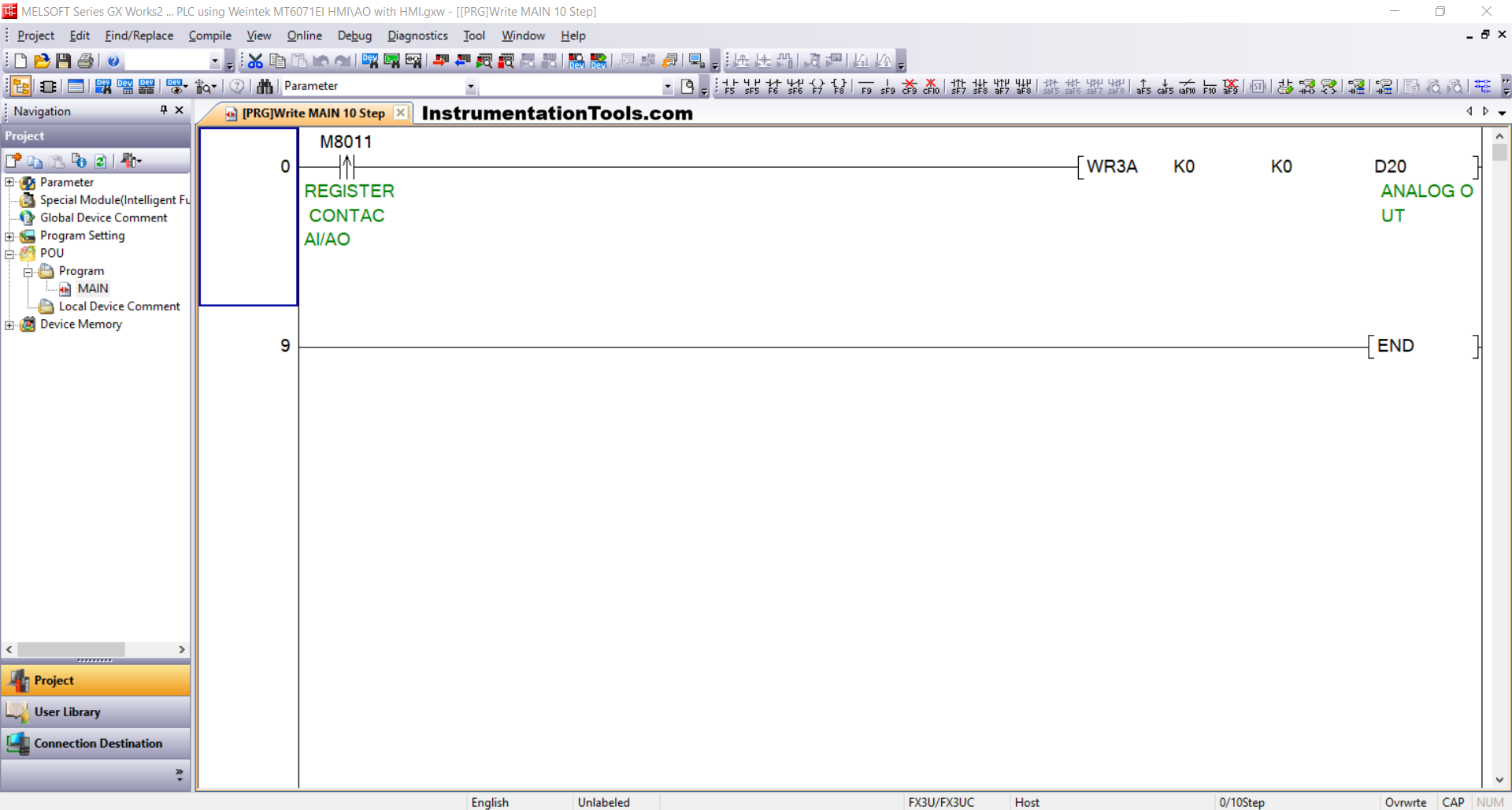

1. Create the PLC Program as Follows
Use the WR3A instruction with module setting “0/K0” and analog output address “0/K0”. The ANALOG OUT (D20) word memory is used to store analog output resolution data. The NO contact from REGISTER CONTACT AI/AO(M8011) bit memory is used to activate this instruction.

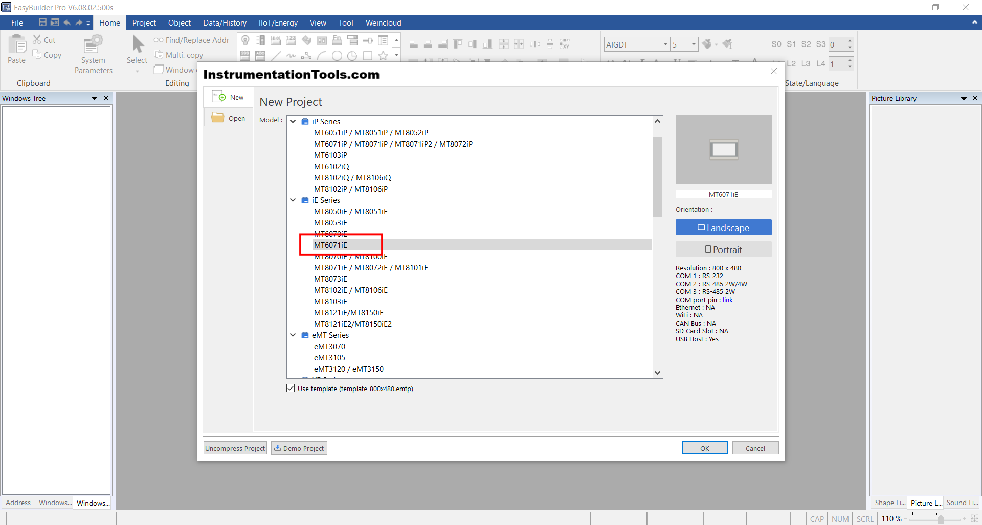

2. Create New Project
Open EasyBuilder Pro → Click [New], select HMI model [MT6071IE], then click [OK].

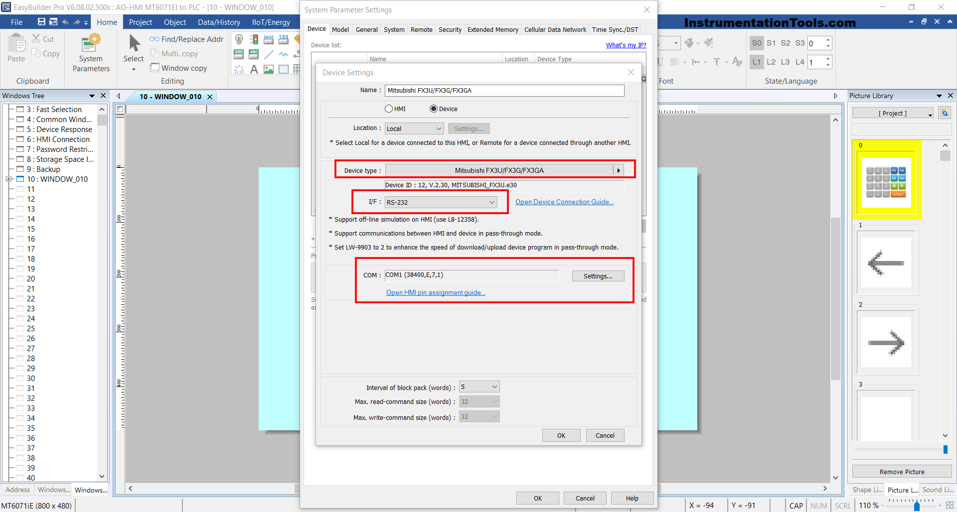

3. Add PLC Device
In the System Parameter window, click [New Device/Server], then configure:
- Port: RS-232COM: COM1(*)(38400,E,7,1)
- Device Type: Mitsubishi FX3U/FX3G/FX3GA
- Click [OK].

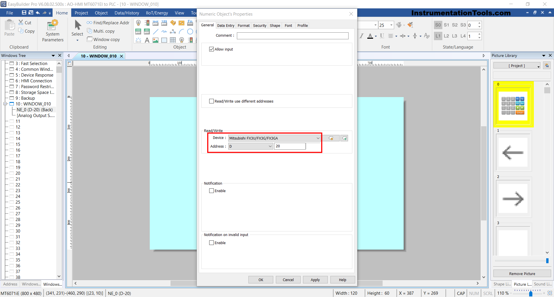

4. Design HMI Interface
Insert “Numeric Object” → Set Device to “Mitsubishi FX3U/FX3G/FX3GA” and word memory address “D20“, matching the Analog Output Resolution address in PLC.
Set Data Format to “16-bit Unsigned“, then click [OK].

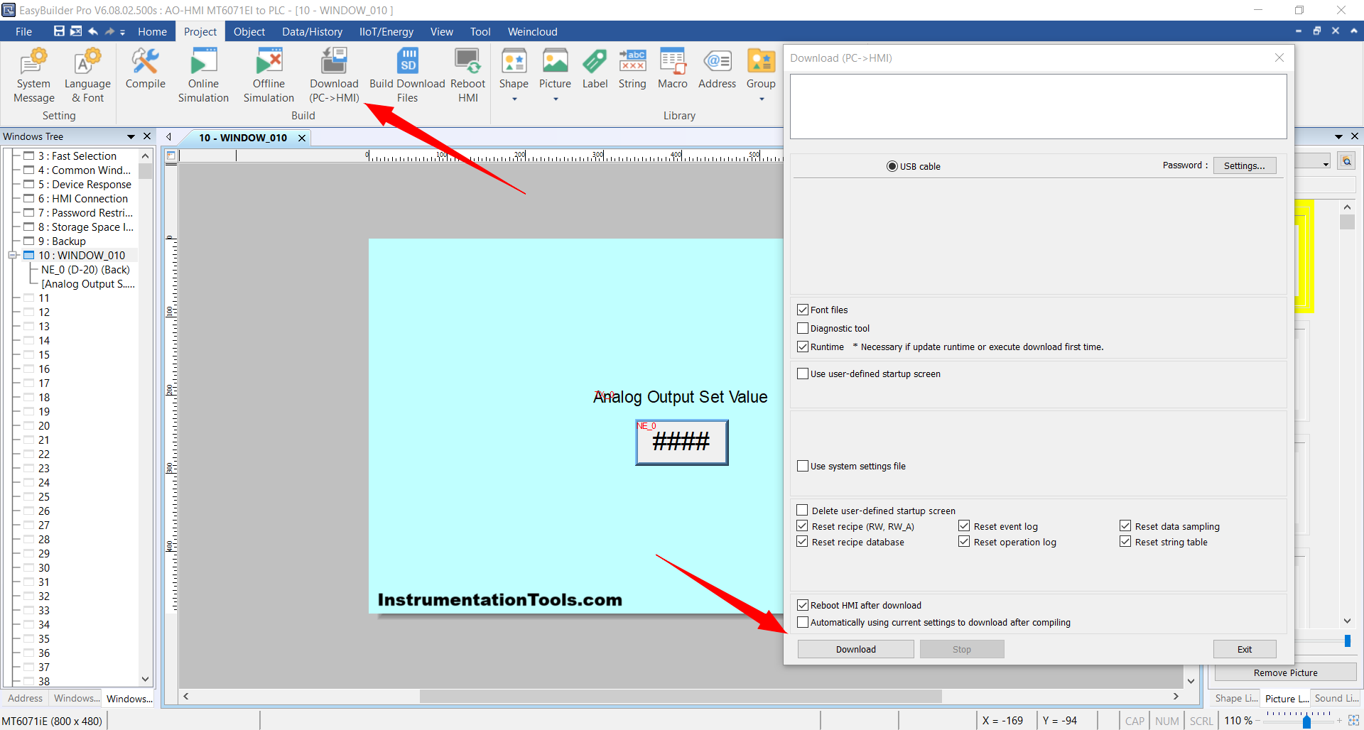

5. Transfer Design to HMI
Click menu [Project] → [Download(PC->HMI)].
6. Final Step
Disconnect the Mini USB Type B cable and connect the PLC to the HMI using a DB9 RS-232 Male to Female cable.
