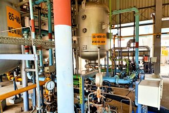

OPEN TANK CAPILLARY REMOTE SEAL LEVEL TRANSMITTERS
1. Transmitter installed exactly at HP tapping point – Open Tank
Tank span = Lmax x SG
Tank Span: (108 in. x 0.75) = 81 inH2O
4 mA = Lmin x SG + Hd x Sg
=(0 x 0.75) + (0 in x 0.934)= 0 inH2O
4mA = 0 inH2O
20 mA = Lmax x SG + Hd x 0.934
=(108in x 0.75) + (0)= 81 inH2O
20mA = 81 inH2O
2.Transmitter installed below HP tapping point – Open Tank
Tank span = (Lmax x SG)
Tank Span: 108in x 0.75 = 81inH2O
Lmin
4 mA = Lmin x SG + (Hd x Sg)
= (0 x 0.75) + (60in x 0.934)
= 56.04 inH2O
Lmax
20 mA = L max x SG + (Hd x Sg)
=(108in x 0.75) + (56.04)
= 137.04 inH2O
SPAN = 81inH2O (137.04 – 56.04)
3.Transmitter installed above the HP tapping Point – Open Tank
Tank Span: 108in X 0.75 = 81inH2O
4mA = Lmin x SG + (Hd x Sg)
= (0 x 0.75) + (120 in. x 0.934) = -112.08 inH2O
NOTE Pressure pulling down on the high sensor side will register as a negative pressure value.
20mA = Lmax x SG + (Ld X 0.934)
= (108 in. x 0.75) + (-112.08) = -31.08 inH2O
SPAN = 81 inH2O (-112.08 to -31.08 inH2O)
CLOSEDÂ TANK CAPILLARY REMOTE SEAL LEVEL TRANSMITTERS
Example A :
Transmitter installed exactly at HP tapping point – Closed Tank
Tank Span: 108in X 0.75Â = 81inH2O
4mA = Lmin x SG + (Ld x Sg)
NOTE Pressure applied to Low sensor side sensor will register as a negative digital value.
Example B :
Transmitter installed above HP tapping point – Closed Tank
4mA = Lmin x SG + (Ld x Sg) + (Hd x Sg)
= (0 x 0.75) + (60 in. x 0.934) + (60 in. x 0.934) = -112.08 inH2O
20mA = Lmax x SG + (Ld X 0.934) + (Hd X 0.934)
= (108 in. x 0.75) + (60 in. x 0.934) + (60 in. x 0.934) = -31.08 inH2O
NOTE: Pressure (Ld) is applied to Low sensor side and will register as a negative digital pressure. Pressure (Hd) is pulling down on the high sensor side therefore would also register as a negative digital pressure therefore these values are additive.
Example C :
Transmitter installed below HP tapping point – Closed Tank
4mA = Lmin x SG + (Hd x Sg) + (Ld x Sg)
= (0 x 0.75) + (60 in. x 0.934) + (180 in. x 0.934) = -112.08 inH2O
20mA = Lmax x SG + (Hd X 0.934) + (Ld X 0.934)
NOTE: The transmitter location in a closed tank does not effect the 4mA and 20mA set points as shown in example A, B & C.
Abbreviations:
Lmin = the minimum level of process and typically the 4mA lower range value
Lmax = the maximum level of process and typically the 20mA upper range value
Atm = Atmospheric pressure (vented tank)
SG = Specific gravity of the process
Sg = Specific gravity of the remote fill fluid
Hd = Capillary vertical distance from process to high side sensor
Ld= Capillary vertical distance going to low side sensor
Source : Emerson
