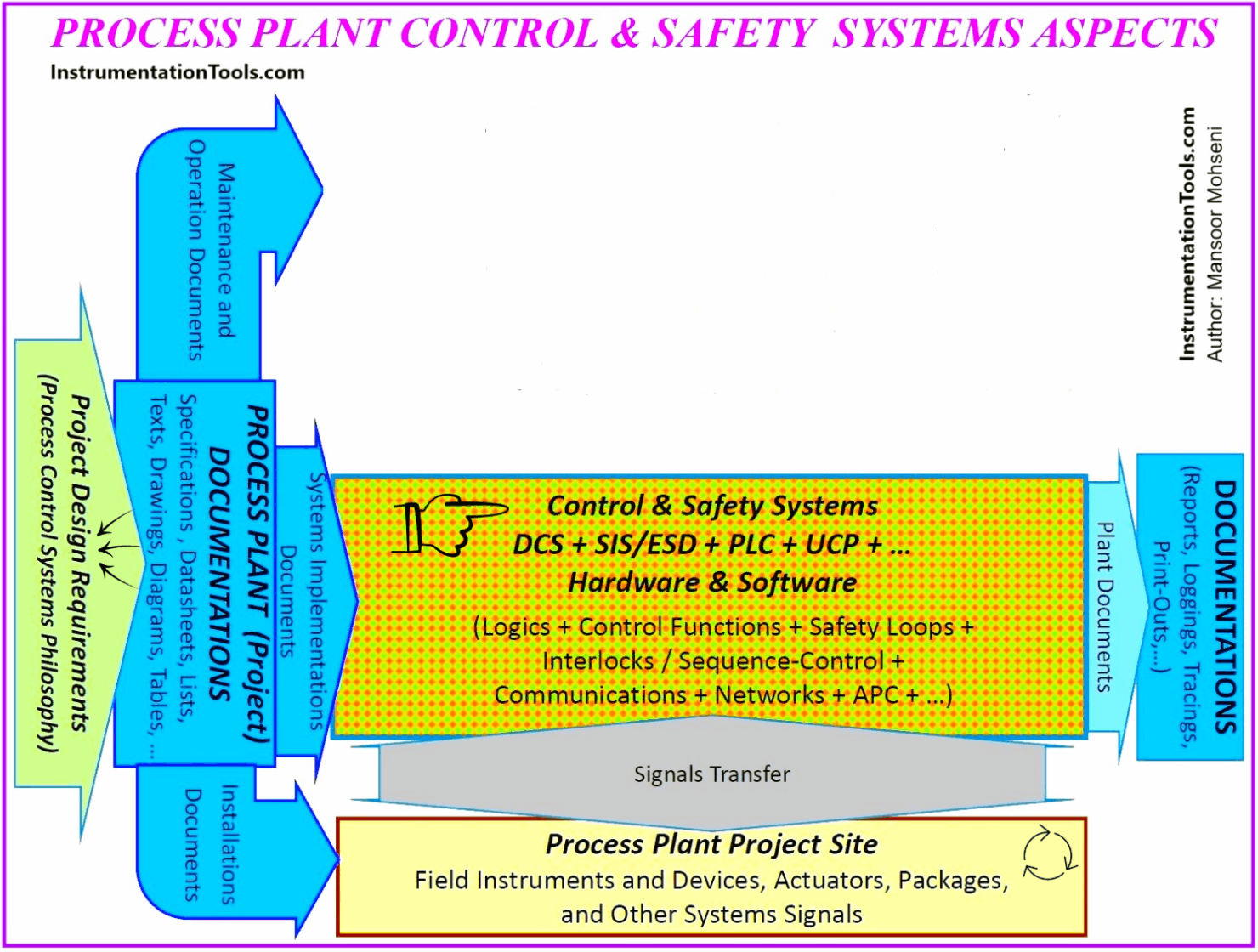

Process Plant Control & Safety Systems Aspects
Before starting our study, let us have an overview of the expected aspects of Process Plant Control & Safety Systems. Figure 1 shows generally the main items of such aspects.
 Figure-1: Process Plant Control & Safety Systems Aspects.
In fact during the execution of each Industrial Process Plant Project, by providing documents and doing different activities, some different Control & Safety Systems are installed and configured to make some facilities by which different operational and safety functions are available (as automatic or by human interactions).
Some of the main expected functional facilities (as shown in Figure 1) may include:
  • Total Functional Control
  • Total Functional Safety
  • Unit/ Package Wise Control
  • Unit/ Package Wise Safety
  • Auto/ Interlock Logics (for making some Automation)
  • Safety/ Protection Logics (for establishing different Plant Protection Layers including F&G systems)
  • Sequence Controls
  • Controllers Settings
  • Operator Actions
  • Alarm Management
  • Data Storage/ Historian (for performance or accident analysis or any comparisons on changes and modifications)
  • (Parameters Values/ Status) Monitoring
  • Data/ Signals Transfer (Communications) or Networks
  • Management Information System (MIS)
  • Asset/ Maintenance Management Systems (MMS)
  • Production Plan Control
  • Internet/ WAN (Enterprise/ Outside Work/ Distributed Plant) …
As Figure 1 shows, the provided documents for reaching the mentioned Control & Safety Systems aspects may be divided into three main targets such as:
  • Documents for Installations (Instruments, Systems, and all Auxiliaries or Accessories such as Cables, JBs, Trays/ Ladders, Tubing, …)
  • Documents for Systems Implementations (Design and Configurations)
  • Documents for Plant Maintenance & Operations (daily plant operations)
 In fact, Detail Design (Engineering) documents in the form of specifications, datasheets, lists, texts, drawings, diagrams, and tables,… transfer the Project Design Requirements (Process Control Systems Philosophies) to the required aspects that were expected.
However during Plant Operation & Maintenance phase provided systems can produce some actual documentation (such as reports, loggings, tracings, and print-outs …) too.
