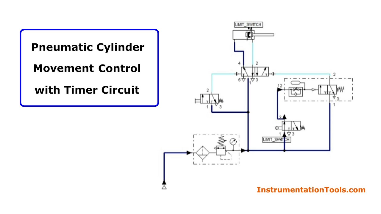

This article is about controlling the double-acting pneumatic cylinder movement with a timer. In this forward actuation is started by the push button and it will automatically return to its original position after reaching the limit after some delay with the help of a timer.

Pneumatic system control with timer
Working
The compressed air supply is produced by the compressor & given to the Air supply unit which filters, regulates, and gives lubrication to the compressed air for the operation.
The output of the air service unit is connected to the 3/2 DCV push button which starts the controls of the whole operation.
By pressing the push button, the compressed air was moved to the 5/2 pilot valve signal and the received signal moves the cylinder forward.
Pneumatic Cylinder Movement Control with Timer
Once the cylinder moves forward, it automatically touches the roller valve and it will produce the signal. The produced signal was passed to the timer which creates the delay.
Then the output of the timer was connected to the other side of the signal of the 5/2 pilot valve which moved the cylinder to backwards. Thus one stroke was completed by creating the delay in the reverse direction.
Double-Acting Pneumatic Cylinder Circuit
Then the process was continued by pressing the push button again. This type of circuit was used in industrial pressing, shearing, and bending operations.
