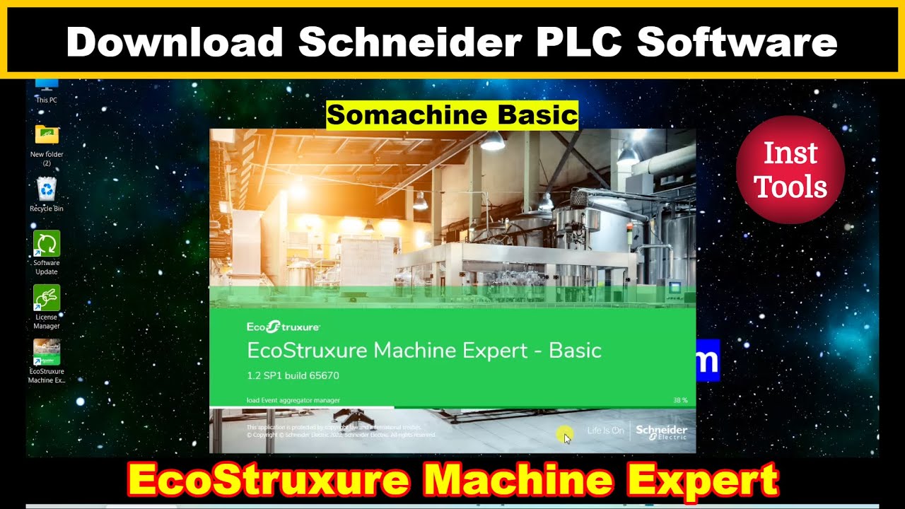

  • For this application, we have used EcoStruxure Machine Expert Basic v1.2 software for the PLC programming.
