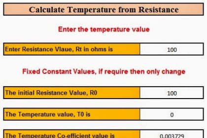

  10. Now wait till you get 95 degree Centigrade in the display of the temperature bath as well as from the RTD (you can measure RTD’s resistance and then calculate the temperature from it or attach an indicator to the RTD which shows the temperature)
