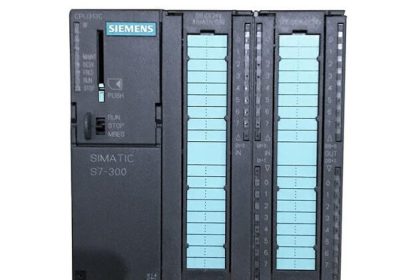

The following PLC ladder program explains the operation of the gas detection system with three (3) sampling points using Siemens CPU 314C-2 DP.
