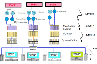

Figure-1: Three Different Types of Control & Safety Systems of Packages (Diagrams)

Figure-1 shows some sample cases for applying three different possible methods on Package Control and Safety Systems.
As the Figure-1 shows, such methods may be
- Very simple (completely in Process Plant DCS and ESD Systems), or
- Completely by separate UCP which may have some limited communications (or interfacings) with DCS/ESD systems, or
- Complex arrangement and interfacings of AUX. Panel with DCS/ESD systems. Figure-2 shows some actual selected systems for Package Control & Safety Systems (by explained different methods).
