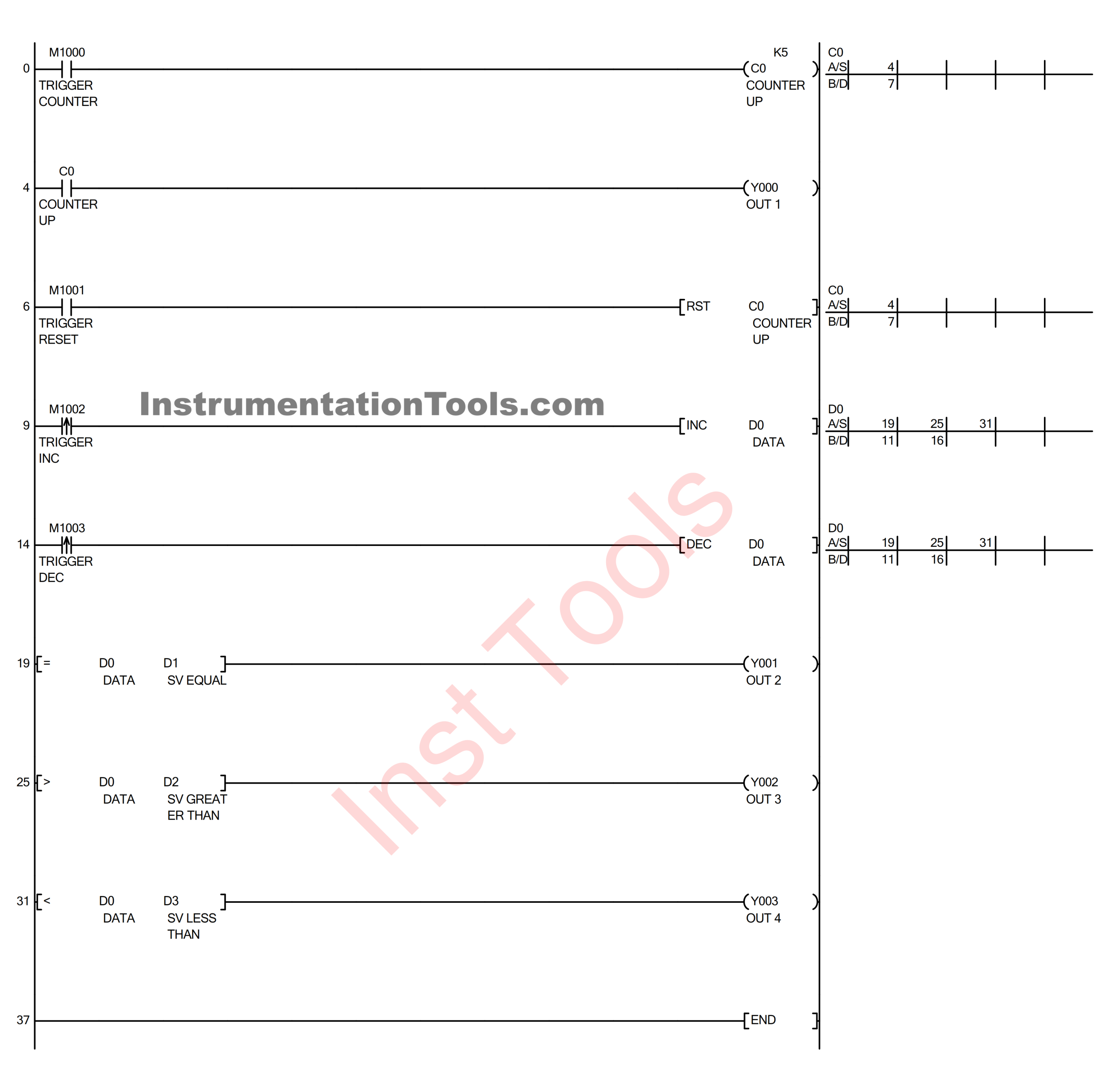

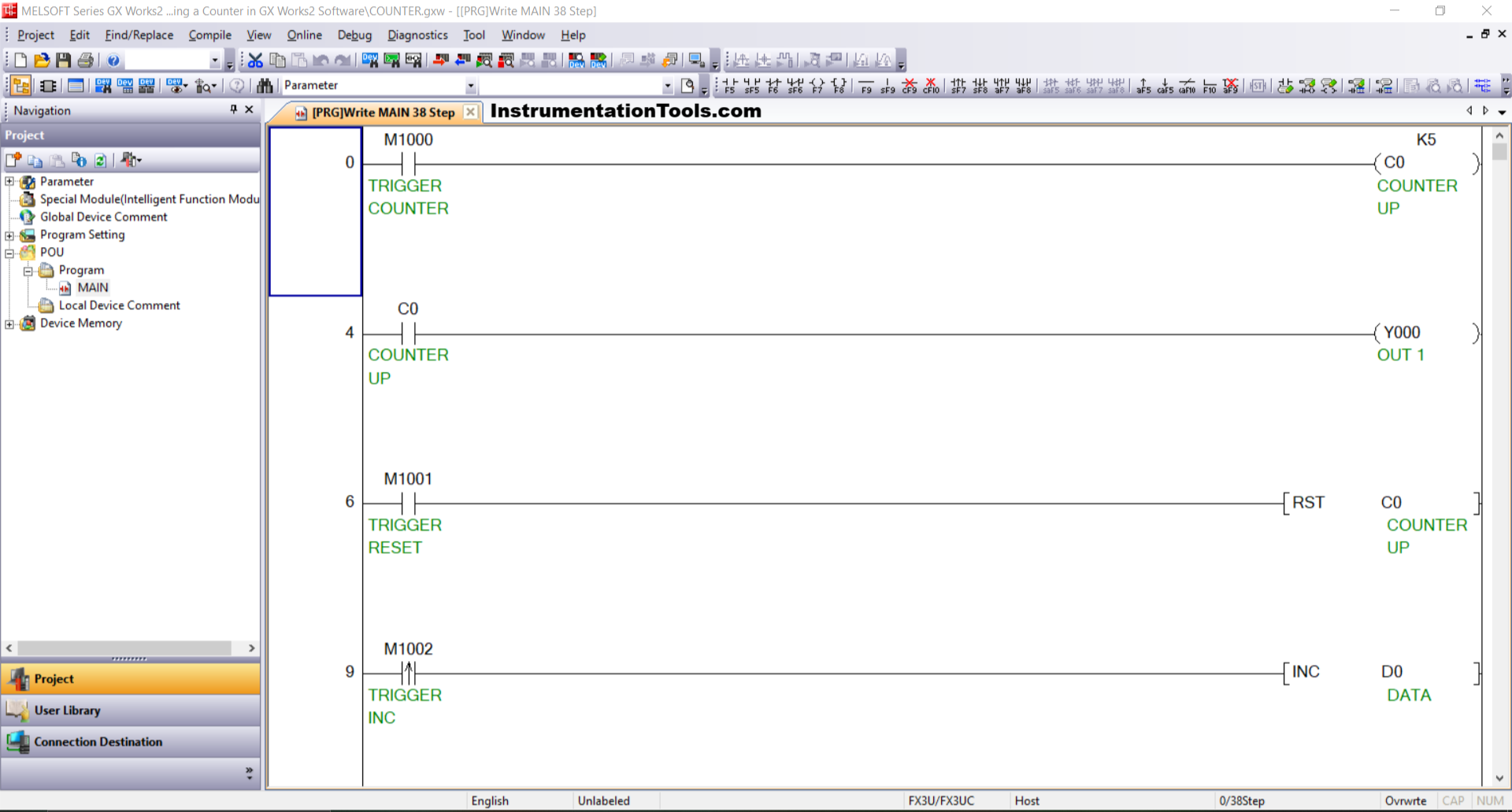

COUNTER Instruction
This counter instruction is an upward-counting type of counter instruction.
This instruction counts events and stores the value in a counter memory (e.g., C0). The CNT instruction has one input parameter to increment the counter’s present value (PV). The counter’s PV can only be reset using the Reset (RST) instruction with the same counter memory address. Numeric values in GX-Works software must be written with the prefix “K”.
In this instruction, the counter’s set value (SV) is set to 5 (K5), and it will activate Output 1 after receiving 5 trigger signals.

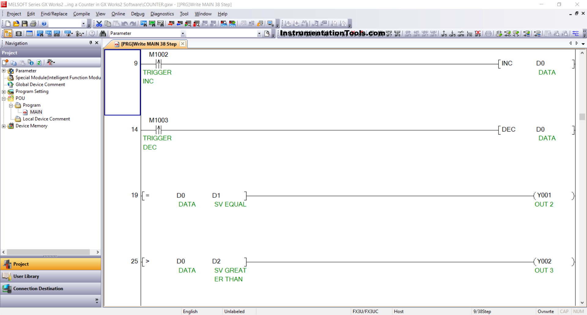

INCREMENT (INC) and DECREMENT (DEC) Instructions
The INC and DEC instructions are used to increase or decrease the value stored in a word memory, functioning similarly to a reversible counter.
These instructions store the counted value in word memory (e.g., D0). Both INC and DEC instructions have one input parameter used to increase or decrease the value. In this program, the word memory value is combined with comparison instructions (=, >, <).
Each comparison instruction has its own set value (SV) parameter and will be used to activate an output.
Mitsubishi Counter Programming Using Ladder Diagram

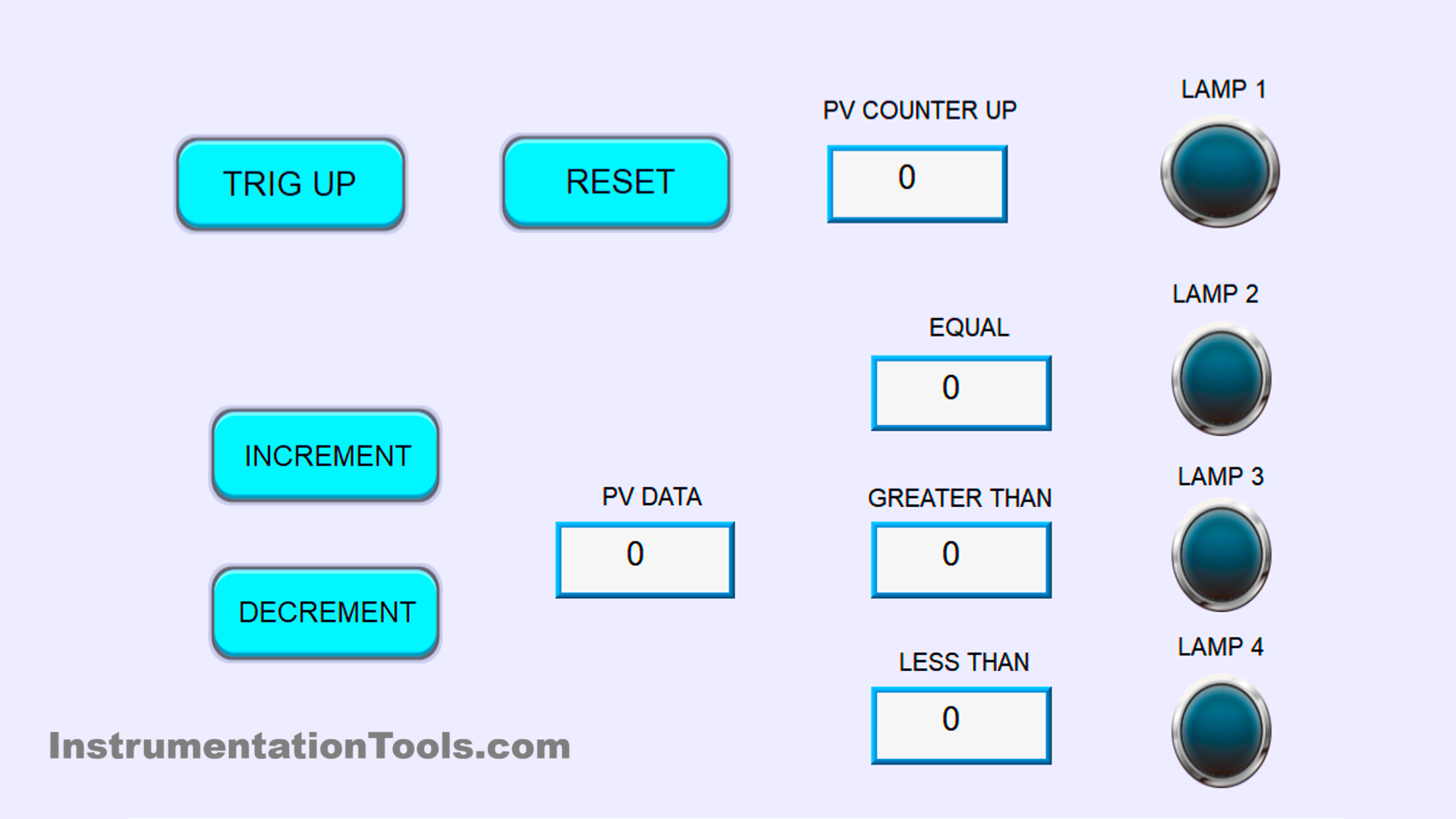

Simulation Video
In the video below, we showed you the Mitsubishi counters program simulation in GX-Works2.
Mitsubishi PLC Counter in GX Works2 Simulation
IO Mapping
S.No.CommentInputOutputCounterMemory Word
1TRIGGER COUNTERM1000
2TRIGGER RESETM1001
3TRIGGER INCM1002
4TRIGGER DECM1003
5Y001 OUT 1
6Y002 OUT 2
7Y003 OUT 3
8Y001 OUT 4
9COUNTER UP  C0
10DATA   D0
11SV EQUAL   D1
12SV GREATER THAN   D2
13SV LESS THAN   D3

RUNG 0
In this rung, when the TRIGGER COUNTER button (M1000) is pressed, the value of the COUNTER_UP (C0) instruction will increment by “+1”.
When the value of COUNTER_UP (C0) reaches “5”, the counter instruction will turn ON.
RUNG 4
In this rung, Output OUT_1 (Y000) will turn ON if the normally open contact of COUNTER_UP (C0) is in a HIGH state.
RUNG 6
In this rung, if the TRIGGER_RESET button (M1001) is pressed, the value of COUNTER_UP (C0) will be reset to zero (0).
RUNG 9
In this rung, when the TRIG_INC button (M1002) is pressed, the value in the word memory DATA (D0) will increment by “+1”.
Practical Counter Example in Mitsubishi PLC
RUNG 14
In this rung, when the TRIG_INC button (M1002) is pressed, the value in the word memory DATA (D0) will decrease by 1.

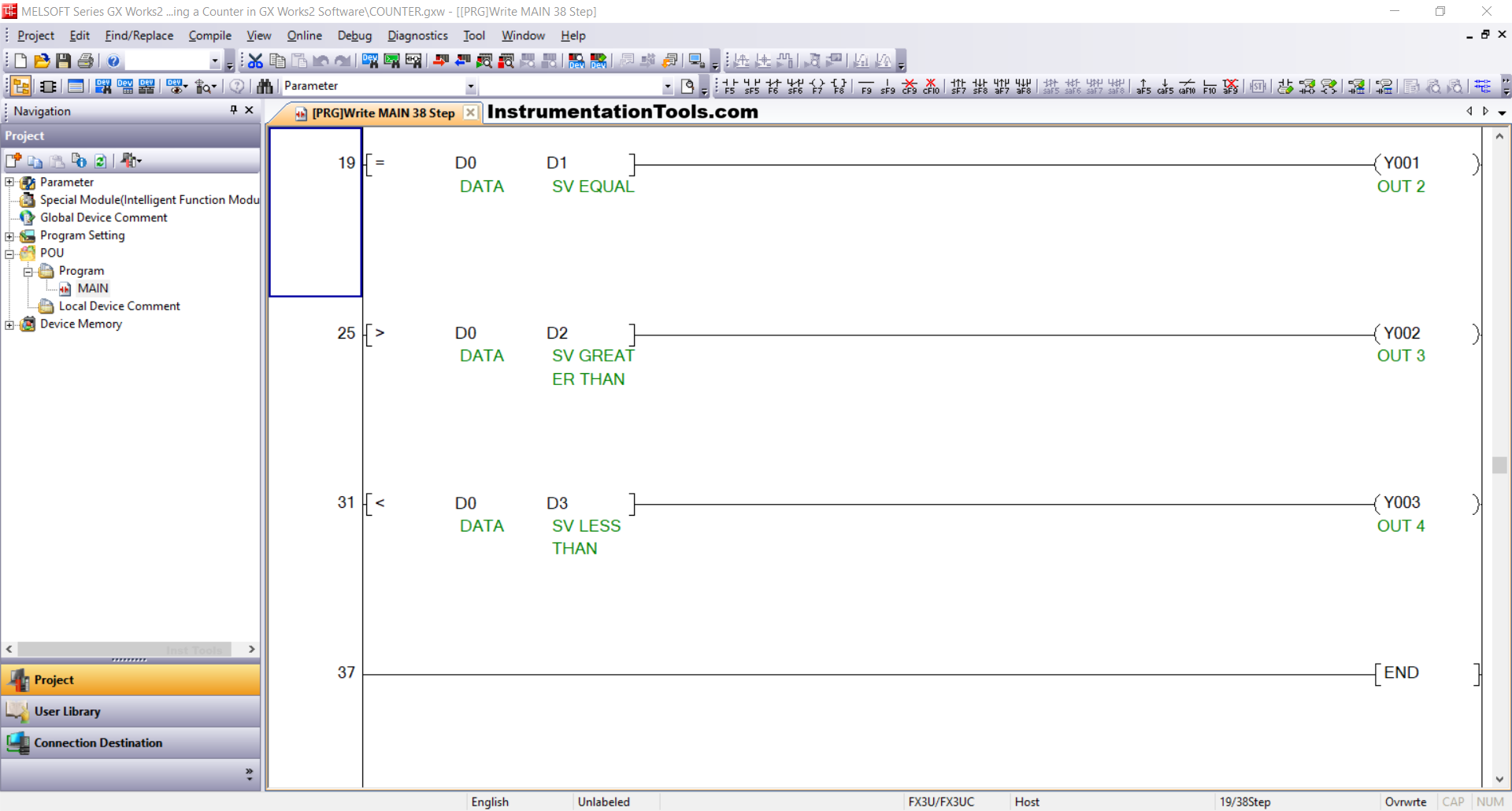

RUNG 19
When the value in word memory DATA (D0) is equal to SV_EQUAL (D1), Output OUT_2 (Y001) will turn ON.
RUNG 25
When the value in word memory DATA (D0) is greater than SV_GREATER_THAN (D2), Output OUT_3 (Y002) will turn ON.
Introduction to Counter Blocks in Mitsubishi PLC
RUNG 31
When the value in word memory DATA (D0) is less than SV_LESS_THAN (D3), Output OUT_4 (Y003) will turn ON.
