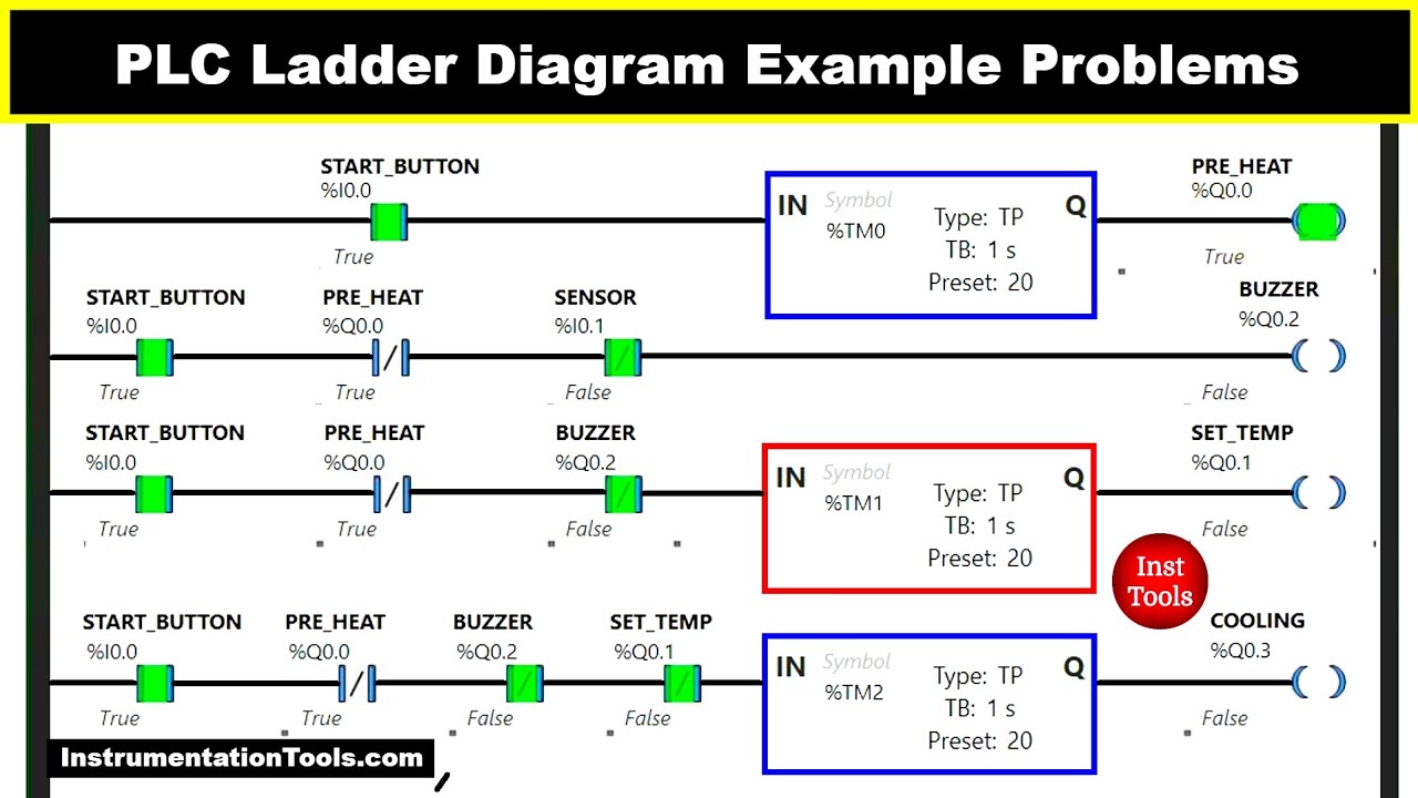

Problem Statement:
We are using one toggle switch to Control Preheat, Buzzer, Set Temperature, and Cooling.
The Oven should preheat for 10 seconds, then a buzzer will turn ON. The food tray should be placed inside and then only, the buzzer will turn OFF and maintain the set temperature for 20 seconds and then cool down for 30 seconds.

Inputs and Outputs
Digital Inputs:
Start Button: I0.0
Digital Outputs:
Preheat: Q0.0
Set Temp: Q0.1
Buzzer: Q0.2
Cooling: Q0.3

Program Description
We have used Normally Open Contact for the Start Button(I0.0).
We have used Normally Closed Contacts for Preheat (Q0.0), Sensor (I0.1), Buzzer (Q0.2), Set Temperature (Q0.1) and Cooling (Q0.3).
In Rung 0:
  1. Normally Open Contact is used for the Start Button (I0.0) to Turn ON the output Preheat (Q0.0).
  2. Timer Function Block type TP is used to Turn ON the output Preheat (Q0.0) for a limited time.
In Rung 1:
  1. Normally Open Contact is used for the Start Button (I0.0) to Turn ON the output Buzzer (Q0.2).
  2. Normally Closed Contact is used for Preheat (Q0.0) to turn ON the output Buzzer (Q0.2).
  3. Normally Closed Contact is used for Sensor (I0.1) to turn OFF the output Buzzer (Q0.2).
In Rung 2:
  1. Normally Open Contact is used for the Start Button (I0.0) to Turn ON the output Set Temperature (Q0.1).
  2. Normally Closed Contacts are used for Preheat (Q0.0) and Buzzer (Q0.2) to turn ON the output Set Temperature (Q0.1).
In Rung 3:
  1. Normally Open Contact is used for the Start Button (I0.0) to Turn ON the output Cooling (Q0.3).
  2. Normally Closed Contacts are used for Preheat (Q0.0), Buzzer (Q0.2), and Set Temperature (Q0.1) to turn ON the output Cooling (Q0.3).
Simulation Results
We will simulate the PLC program and analyze the results. We may show the partial logic instead of the complete PLC program.
Rung 0:
When the Start Button (I0.0) is turned ON, the output Preheat (Q0.0) turns ON (Oven starts Preheating) but for a limited time as Timer Function type TP is used to turn ON the Output Preheat (Q0.0) or Preheat the Oven for a limited time.
PLC Programming for Industrial Oven Control
The time is set to 10 seconds. So after 10 seconds, the output Preheat (Q0.0) will turn OFF, or after 10 seconds Preheating of the Oven finishes.
PLC functions in industrial furnace control systems
Rung 1:
Also, when the Start Button (I0.0) is turned ON, the output Preheat (Q0.0) is OFF (Preheating of Oven finishes) and the Sensor (I0.1) gets activated (Sensor detects tray).
plc program oven
The output Buzzer (Q0.2) turns OFF as Normally Closed Contact used for Sensor (I0.1) will be in True state and does not allow the signal to pass through it and the output Buzzer (Q0.2) will turn OFF.
Toaster oven control using PLC
Rung 2:
When the Start Button (I0.0) is turned ON and the outputs Preheat (Q0.0) and Buzzers (Q0.2) are OFF in Rung1 and Rung2.
The output Set Temperature (Q0.1) turns ON as normally Closed Contacts used for Preheat (Q0.0) and Buzzer (Q0.2) in Rung2 will be in a false state and passes the signal to turn ON the output Set temperature (Q0.1) and the output Set Temperature (Q0.1) turns ON (Oven maintains set temperature).
Controlling a oven with PLC Logic
The output Set Temperature (Q0.1) will turn OFF after some time as Timer Function Block type TP is used to turn ON the output Set Temperature (Q0.1) for a limited time.
The time is set to 20 seconds. After 20 seconds, the output Set Temperature (Q0.1) turns OFF (Maintaining Set Temperature ends).
PLC Oven temperature control
Rung 3:
When the Start Button (I0.0) is turned ON and the outputs Preheat (Q0.0), Buzzers (Q0.2), and Set Temperature (Q0.1) are OFF in Rung1, Rung2, and Rung3.
The output Cooling (Q0.3) turns ON as normally Closed Contacts used for Preheat (Q0.0), Buzzer (Q0.2), and Set Temperature (Q0.1) in Rung3 will be in a false state and passes the signal to turn ON the output Cooling (Q0.3) and the output Cooling (Q0.3) turns ON (Oven starts Cooling).
Industrial Oven Programming
The output Cooling (Q0.3) will turn OFF after some time as Timer Function Block type TP is used to turn ON the output Cooling (Q0.3) for a limited time.
The time is set to 30 seconds. After 30 seconds, the output Cooling (Q0.3) turns OFF (Cooling of Oven ends).
