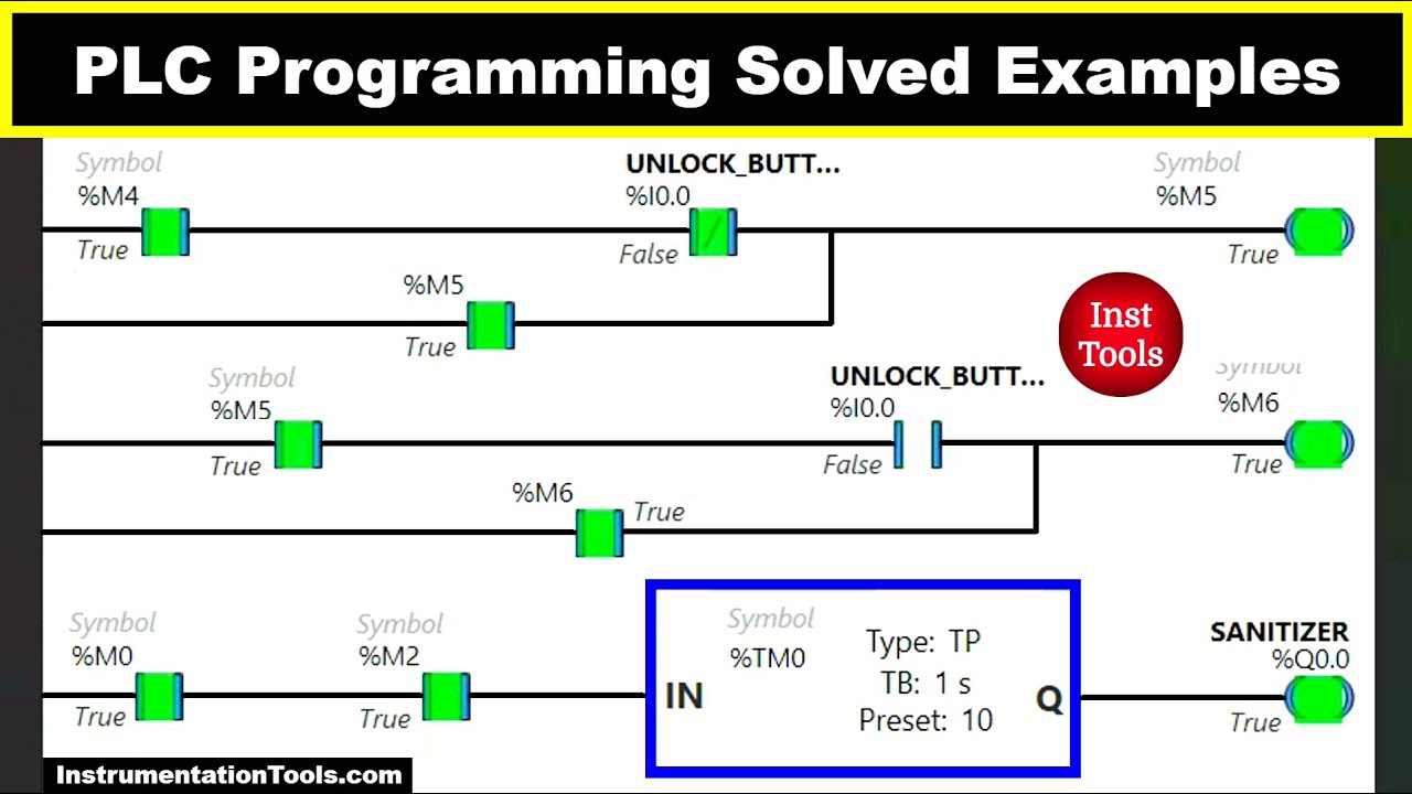

This is a complex ladder logic PLC examples for automatic sanitizer. The sanitization process runs when the door is used as per the program.

We are using one Push Button to control Sanitizer.
The sanitization process should run for 10 seconds when the door is used 4 times.

Inputs and Outputs
Digital Inputs:
Unlock Button: I0.0
Digital Outputs:
Sanitizer: Q0.0

We have used Normally Open Contacts for the Unlock Button(I0.0) and Memory Bits.
We have used Normally Closed Contacts for Unlock Button (I0.0).
In Rung 0:
  1. Normally Open Contact is used for the Unlock Button(I0.0) to Turn ON Memory Bit 1 (M0).
  2. Memory Bit 1 (M0) is latched so that when the Unlock Button(I0.0) turns OFF, Memory Bit 1 (M0) still remains ON.
In Rung 1:
  1. Normally Open Contact is used for Memory Bit 1 (M0) to Turn ON Memory Bit 2 (M1).
  2. Normally Closed Contact is used for Unlock Button (I0.0) to Turn ON Memory Bit 2 (M1).
  3. Memory Bit 2 (M1) is latched so that when Memory Bit 1 (M0) turns OFF, Memory Bit 2 (M1) still remains ON.
In Rung 2:
  1. Normally Open Contacts are used for Unlock Button (I0.0) and Memory Bit 2 (M1) to turn ON Memory Bit 3 (M2).
  2. Memory Bit 3 (M2) is latched so that when the Unlock Button (I0.0) or Memory Bit 2 (M1) turns OFF, Memory Bit 3 (M2) still remains ON.
In Rung 3:
  1. Normally Open Contact is used for Memory Bit 3 (M2) to Turn ON Memory Bit 4 (M3).
  2. Normally Closed Contact is used for Unlock Button (I0.0) to Turn ON Memory Bit 4 (M3).
  3. Memory Bit 4 (M3) is latched so that when Memory Bit 3 (M2) turns OFF, Memory Bit 4 (M3) still remains ON.
In Rung 4:
  1. Normally Open Contacts are used for Unlock Button(I0.0) and Memory Bit 4 (M3) to turn ON Memory Bit 5 (M4).
  2. Memory Bit 5 (M4) is latched so that when the Unlock Button(I0.0) or Memory Bit 4 (M3) turns OFF, Memory Bit 5 (M4) still remains ON.
In Rung 5:
  1. Normally Open Contact is used for Memory Bit 5 (M4) to Turn ON Memory Bit 6 (M5).
  2. Normally Closed Contact is used for Unlock Button (I0.0) to Turn ON Memory Bit 6 (M5).
  3. Memory Bit 6 (M5) is latched so that when Memory Bit 5 (M4) turns OFF, Memory Bit 6 (M5) still remains ON.
In Rung 6:
  1. Normally Open Contacts are used for Unlock Button (I0.0) and Memory Bit 6 (M5) to turn ON Memory Bit 7 (M6).
  2. Memory Bit 7 (M6) is latched so that when the Unlock Button (I0.0) or Memory Bit 7 (M6) turns OFF, Memory Bit 7 (M6) still remains ON.
In Rung 7:
  1. Normally Open Contact is used for Memory Bit 1 (M0), Memory Bit 3 (M2), Memory Bit 5 (M4), and Memory Bit 7 (M6) to Turn ON the output Sanitizer (Q0.0).
  2. Timer-type TP is used to Turn ON the output Sanitizer (Q0.0) for a limited time.

Also, when Memory Bit 1 (M0) turns ON in Rung0, Memory Bit 3 (M2) turns ON in Rung2, Memory Bit 5 (M4) turn ON in Rung4, Memory Bit 7 (M6) turn ON in Rung6 or Door opens four times.
Normally Open Contact used for Memory Bit 1 (M0), Memory Bit 3 (M2), Memory Bit 5 (M4), and Memory Bit 7 (M6) in Rung7 will be in True State and will pass the signal to turn ON the output Sanitizer (Q0.0).
The output Sanitizer (Q0.0) will turn ON for 10 seconds as Timer Function Block type TP is used to turn ON the output Sanitizer (Q0.0) for Limited time. The time is set to 10 seconds. After 10 seconds, the output sanitizer (Q0.0) will turn OFF.
