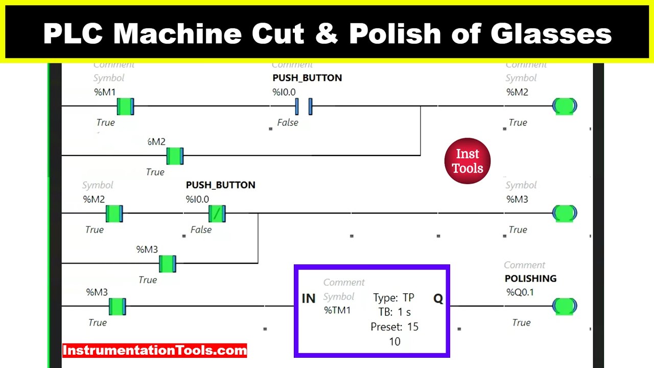

We are using one Push Button to control Glass products’ Cutting and Polishing.
A Machine is used to cut and polish glasses.
Push Button by pressing and releasing is used to carry on the cutting the glass process which takes 10 seconds.
Then again on pressing and releasing the same push button for the second time, we will be able to polish the glass which takes place for 15 seconds.

PLC Ladder Logic
Glass Cutting and Polishing Machine PLC Automation Solution
Program Explanation
We have used Normally Open Contacts for Push Button(I0.0) and Memory Bits.
We have used Normally Closed Contacts for Push Button (I0.0).
In Rung 0:
  1. Normally Open Contact is used for Push Button (I0.0) to Turn ON Memory Bit 1 (M0).
  2. Memory Bit 1 (M0) is latched so that when the Push Button (I0.0) turns OFF, Memory Bit 1 (M0) still remains ON.
In Rung 1:
  1. Normally Open Contact is used for Memory Bit 1 (M0) to Turn ON Memory Bit 2 (M1).
  2. Normally Closed Contact is used for Push Button (I0.0) to Turn ON Memory Bit 2 (M1).
  3. Memory Bit 2 (M1) is latched so that when Memory Bit 1 (M0) turns OFF, Memory Bit 2 (M1) still remains ON.
In Rung 2:
  1. Normally Open Contact is used for Memory Bit 2 (M1) to Turn ON the output Cutting (Q0.0).
  2. Timer Function Block type TP is used to turn ON the output Cutting (Q0.0) for a limited time.
In Rung 3:
  1. Normally Open Contacts are used for Push Button (I0.0) and Memory Bit 2 (M1) to turn ON Memory Bit 3 (M2).
  2. Memory Bit 3 (M2) is latched so that when the Push Button (I0.0) or Memory Bit 2 (M1) turns OFF, Memory Bit 3 (M2) still remains ON.
In Rung 4:
  1. Normally Open Contact is used for Memory Bit 3 (M2) to Turn ON Memory Bit 4 (M3).
  2. Normally Closed Contact is used for Push Button (I0.0) to Turn ON Memory Bit 4 (M3).
  3. Memory Bit 4 (M3) is latched so that when Memory Bit 3 (M2) turns OFF, Memory Bit 4 (M3) still remains ON.
In Rung 5:
  1. Normally Open Contact is used for Memory Bit 4 (M3) to Turn ON the output Polishing (Q0.1).
  2. Timer Function Block type TP is used to turn ON the output Polishing (Q0.1) for a limited time.

Cutting and Polishing Machine Program
When Push Button (I0.0) is released first time in Rung0, Normally Closed Contact used for Push Button (I0.0) in Rung1 will be in a false state and will pass the signal to turn ON Memory Bit 2 (M1).
When Memory Bit 1 (M0) turns ON in Rung0, Normally Open Contact used for Memory Bit 1 (M0) in Rung1 will be in True State and will pass the signal to turn ON Memory Bit 2 (M1), and Memory Bit 2 (M1) will turn ON in Rung1.
Ladder Logic Example of Machine Cutting and Polishing
Memory Bit 2 (M1) will store the data that Push Button (I0.0) is released the first time. Memory Bit 2 (M1) is latched so that when Memory Bit 1 (M0) turns OFF, Memory Bit 2 (M1) still remains ON.
When Memory Bit 2 (M1) turns ON in Rung1, Normally Open Contact used for Memory Bit 2 (M1) in Rung2 will be in True state and pass the signal to turn ON the output Cutting (Q0.0) and the output Cutting (Q0.0) will turn ON (Machine starts cutting glass).
Glass Products Making Machine
The output Cutting (Q0.0) will turn OFF after some time as Timer Function Block type TP is used to turn ON the output Cutting (Q0.0) for a limited time.
The time is set to 10 seconds. After 10 seconds, the output Cutting (Q0.0) will turn OFF.
When the Push Button is pressed and released the Second time
When the Push Button (I0.0) is pressed the Second time,  Memory Bit 3 (M2) turns ON as Normally Open Contact used for Push Button (I0.0) will be in True state and will pass the signal to turn ON Memory Bit 3 (M2).
Glass Polishing Machine Logic
When Memory Bit 2 (M1) turns ON in Rung1, Normally Open Contact used for Memory Bit 2 (M1) in Rung3 will be in a True state and will also pass the signal to turn ON Memory Bit 3 (M2), and Memory Bit 3 (M2) will turn ON.
Memory Bit 3 (M2) stores the data that Push Button (I0.0) is pressed the Second time as Memory bits stores the data. Memory Bit 3 (M2) is latched so that when the Push Button (I0.0) is released, Memory Bit 3 (M2) still remains ON.
PLC Control Automatic Glass Processing
When the Push Button (I0.0) is released the Second time, the Normally Closed Contact used for Push Button (I0.0) in Rung4 will be in a false state and will pass the signal to turn ON Memory Bit 4 (M3).
Also, When Memory Bit 3 (M2) turns ON in Rung3, Normally Open Contact used for Memory Bit 3 (M2) in Rung4 will be in True State and will pass the signal to turn ON Memory Bit 4 (M3), and Memory Bit 4 (M3) will turn ON in Rung4.
PLC Solutions for the glass industry
Memory Bit 4 (M3) will store the data that Push Button (I0.0) is released Second time. Memory Bit 4 (M3) is latched so that when Memory Bit 3 (M2) turns OFF, Memory Bit 4 (M3) still remains ON.
When Memory Bit 4 (M3) turns ON in Rung4, Normally Open Contact used for Memory Bit 4 (M3) in Rung4 will be in True state and passes the signal to turn ON the output Polishing (Q0.1) and the output Polishing (Q0.1) will turn ON ( Machine starts polishing glass).
The output Polishing (Q0.1) will turn OFF after some time as the Timer Function Block type TP is used to turn ON the output Polishing (Q0.1) for a limited time. The time is set to 15 seconds. After 15 seconds, the output Polishing (Q0.1) will turn OFF.
