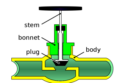

Full bore Valve :-
The I.D of the Valve is equal to the ID of the Pipe.
Reduced Bore Valve :-
The I.D of the valve is smaller than the ID of the pipe.
Refer below picture to get more clarity
Full Bore or Reduced Bore Valves
