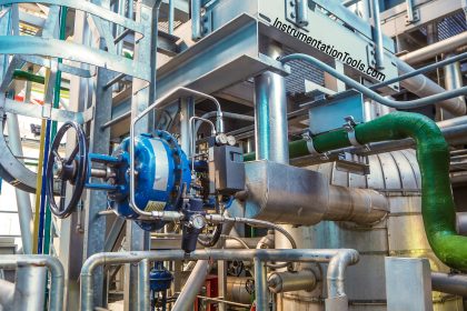

Separator vessels, storage tanks, heat exchangers, columns and certain piping segments etc. are designed to handle certain operating pressure.
However combination of a variety of causes may lead to over pressure in these equipments which may exceed the maximum allowable working pressure (MAWP) value.
Pressure Relief valves (PRV) are used to relieve the pressure in these equipments before it can cross the maximum allowable working pressure, thus protecting the equipment from damage.
The pressure relief valve set point should be such that relief valve will open before the maximum allowable accumulated pressure (MAWP) is reached in the vessel.
For this purpose usually a hydraulic calculation should be done for PRV discharge line to determine the back pressure at the relief valve, which on addition to the pressure drop across pressure relief valve gives the pressure accumulation the equipment.
Pressure Relief Valve Sizing
The PRV size is based on a minimum relieving flowrate which can prevent the build up of pressure in the protected equipment from exceeding the MAWP limit.
For several possible causes of over pressure in the vessel, relieving flowrates are calculated and the maximum of these flowrates is selected for PRV sizing. The over pressure cause corresponding to this flowrate is then known to be the governing case for pressure relief valve sizing.
Some common causes of over pressure which are considered for pressure relief valve sizing are described in this article.
