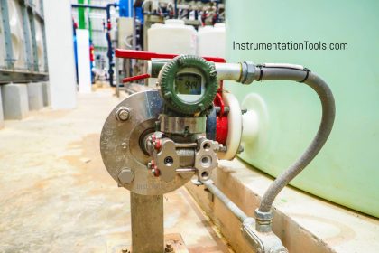

A Differential pressure transmitter is a common and well-understood technology for liquid level measurement. If the tank is closed or pressurized, a DP measurement must be made to compensate for the vessel pressure.
DP Transmitter Level Measurement for Closed Tank
In closed tank DP level measurement,  LP leg is connected to the top of tank.
There are two methods in closed tank DP Level Measurement.
Dry leg method:
Dry leg method is used in normal close tank where vapor is not condensate and temperature of process is equal to atmospheric.
Wet leg method:
Wet leg method is used where vapor has a tendency to make the condensate and temperature of process is high or low from the atmospheric .
For DP Transmitter Configuration, we have to find out Zero Level & Span Level. Accordingly we have to configure Lower Range Value (LRV) and Upper Range Value (URV) using HART communicator.
DP Transmitter Level Measurement for Closed Tank – Dry Leg Method
Simply when LP side of the DP transmitter is filled with any gas/air then we call it as Dry Leg & we apply Dry Leg Method for calculations.
DP Transmitter Level Measurement for Closed Tank Dry leg Method
At zero level (LRV) = pressure acting on HP leg – Pressure acting on LP leg
=H2 x specific gravity – 0
= 200 x 0.9 – 0
= 180 mmwc
At 100 % level (URV) = pressure acting on HP leg – Pressure acting on LP leg
= (H2+H1) x specific gravity – 0
= (200 + 500) x 0.9 – 0
= 630 mmwc
Range = URV – LRV = 630 – 180 mmwc = 450 mmwc
So, we have to set Lower Range Value (LRV) = 180 mmwc and Upper Range Value (URV) = 630 mmwc in the DP Transmitter using HART communicator.
DP Transmitter Level Measurement for Closed Tank – Wet Leg Method
Simply when LP side of the DP transmitter is filled with liquid then we call it as Wet Leg & we apply Wet Leg Method for calculations.
DP Transmitter Level Measurement for Closed Tank Wet leg Method
Y = H1 +H2 = 500 + 200 = 700 mm
= H2 x SG1 – Y x SG2
= 200 x 0.9 – 700 x 1.0
= 180 – 700
= – 520 mmwc
= (H2+H1) x SG1 – Y x SG2
= (200 + 500) x 0.9 – 700 x 1.0
 = 630 – 700
= -70 mmwc
Range = URV – LRV = -70 – (-520) = 450 mmwc
So, we have to set Lower Range Value (LRV) = -520 mmwc and Upper Range Value (URV) = -70 mmwc in the DP Transmitter using HART communicator.
