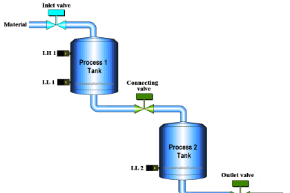

This article is about creating an application (screen) in HMI using Siemens TIA PORTAL.
We all know how much HMI is useful, it allows us to gather all the data from one location.
We can control processes, can see alarms, trends, see the level of the tanks, and can give a command to control valve to see its operation like what we do with HART to check loop.
So, HMI is all in one place where you can do any stuff just you need have to communicate it with the PLC.
In the above window, you can see an example of HMI how it carries all the information. In red symbol, you can see an error and a lot of another feature you can access within HMI.
