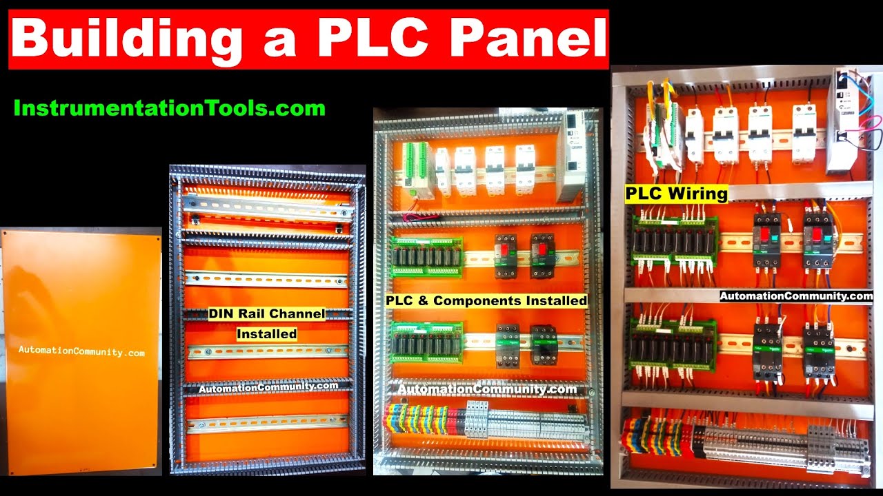

Building a PLC Panel from Scratch - Industrial Control Panel
