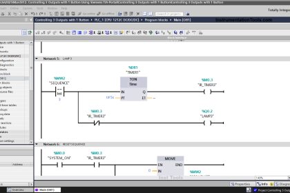

Example
One of the best PLC interview questions “How could you make a program that controls two alternative loads without using any timer” ……
Note that this example is used just for examine that you really can configure and use cyclic interrupts.
Cyclic Interrupts in TIA Portal
Steps:
First of all, select your desired CPU from “configure a new device”
1.   Select add new block
Configuring and Usage of Cyclic Interrupts TIA Portal (OB 30+)
2.   Select add new organization block
Select add new organization block in Tia Portal
3. Then select any interrupt of them, then press OK
Select any interrupt in Tia Portal
4.   After you select the desired one it will be shown under your program blocks
Select the program blocks in Tia Portal
5.   Then select your CPU properties to configure the execution time
6. Then write your program as shown in the next Figure.
Finally, you will never get 100% of understanding till you try something by your self so please try to make it on your TIA and feel free to send me back to discuss that.
