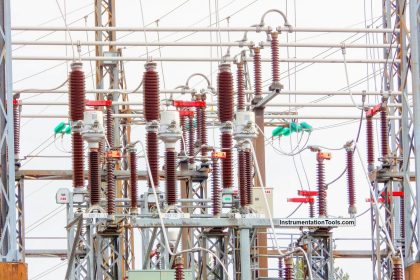

After maintenance, 11 KV bus A to B bus essential phase sequence check assures short circuit danger-free buses paralleling.

After electricity board line maintenance, 11 KV bus-A to B-bus essential phase sequence check assures short circuit danger-free buses paralleling.
Crew wary of doing this very high voltage check, even when given certified gloves, and test probes skipped it relying on electricity board assurance.
Author Solution
The author advised:
  1. Leave the 11 KV A to B bus connecting bus‑tie
  2. Check the phase sequence at any 400 V load center Bus A to Bus B. This is adequate, since all internal connections remain the same.
