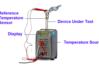

What is a Dry Block?
  • Dry Block is a kind of device that can be heated or cooled to various temperature ranges.
  • The name Dry Block suggests that it is used dry, without using any liquid materials.
  • A temperature dry block is known as a temperature calibrator sometimes it is called a dry well.
  • Generally, a Dry block consists of a removable sleeve or insert with suitable holes or bores for inserting appropriate sensors into the dry block.
  • The dry block consists of an internal temperature measurement arrangement,
  • Sometimes we may use an external reference temperature sensor to insert into holes on the dry block.
  • Commonly a dry block temperature calibrator consists of several compatible inserts.
  • Each insert is drilled with bores of different sizes to match for calibration of varying-sized temperature sensors or transducers.
  • The temperature sensor bores in the dry block are tight enough to enable low thermal resistance between the sensor and the insert provided.
  • If the bores provided are too loose then the sensor gets stabilized slowly, but sometimes they are unable to reach the insert temperature due to stem conditions.
  • Generally, when we insert a temperature sensor or transducer to be calibrated in a dry block, the temperature sensor is the principal component to calibrate a temperature loop.
  • All dry block temperature calibrators have routes to
  • Sourcing Temperature
  • Reading, Analyzing, & Reporting the Temperature.

  • This calibrator consists of built-in sensors for measuring and displaying the calibrator temperature.
  • These are considered and used as reference sensors then built-in sensors having low accuracy.
  • It is required to insert sensors having high accuracy called external reference probes such as Platinum Resistance Thermometers, or Resistance Temperature Devices to obtain more accuracy and low uncertainty.
These are inserted into the heat source along with the device under test (DUT).
Reading, Analyzing & Reporting Temperature
  • There are some common methods by that a temperature calibrator can read, analyze and report temperatures.
  • The common way for the device to source the temperature must have an input to measure the DUT sensor.
  • This Dry block temperature calibrator displays the temperature of the dry block and Device under test.
  • Another common method is inserting a sensor into the calibrator, and the sensor stays connected to the display, & transmitter.
  • This method displays both temperatures of the calibrator & DUT.
  • This method is recommended, & considered as best because it compares and verifies both temperature of the calibrator, & the DUT sensor.
  • Some temperature calibrators are built with an interface unit for the user to link a reference digital thermometer system to determine the highest accuracy

Parts of the Dry Block Calibrator
Parts of the Temperature Calibrator
The dry Block Calibrator consists of
  • A well-designed insert hole for lodging various devices under test or sensors to be calibrated.
  • Heating coils for the escalating temperature to the required value.
  • Reference thermometer fixed internally within dry block calibrator to determine and display device temperature.
  • An electronic PID controller is required to provide a temperature Setpoint and to control the temperature of the Dry Block calibrator.
