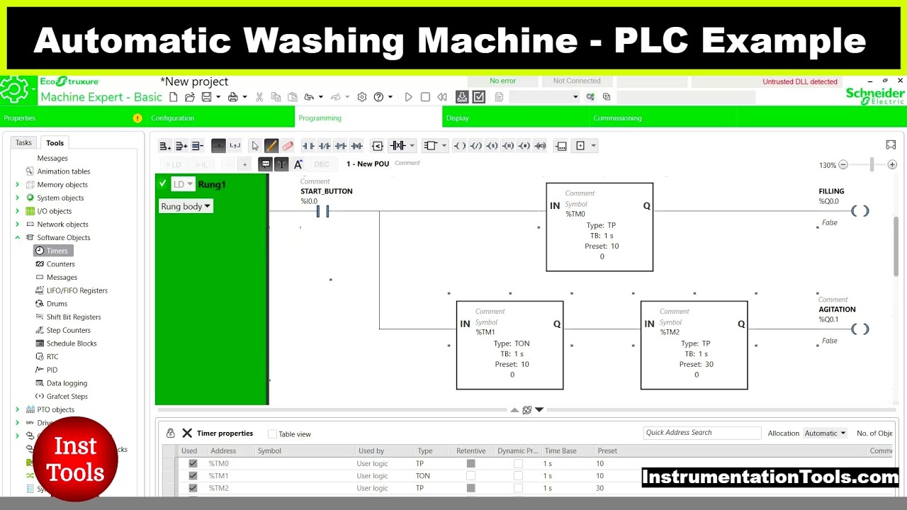

We are using one Push Button to Control the Filling, Agitate, Drain, Spin, and Buzzer.
When the Start Button is pressed, it starts filling the water for 10 seconds, then Agitate for 30 seconds, then Drain the water for 5 seconds, Spin the Drum for 10 seconds, and then Buzzer will be ON for 10 seconds.

Inputs and Outputs
Digital Inputs:
Start Button: I0.0
Digital Outputs:
Filling: Q0.0
Agitation: Q0.1
Drain: Q0.2
Spin: Q0.3
Buzzer: Q0.4

We have used Normally Open Contact for the Start Button (I0.0).
In Rung 0:
  1. Normally Open Contact is used for the Start Button (I0.0) to Turn ON the outputs Filling (Q0.1) and Agitate (Q0.1).
  2. Timer-type TP is used to Turn ON the output Filling (Q0.0) for a limited time.
  3. Timer-type TON is used to delay the turning ON time of the output Agitate (Q0.1) for some time.
  4. Timer-type TP is used to Turn ON the output Agitate (Q0.1) for a limited time.

Rung 0:
When the Start Button (I0.0) is turned ON, the output Filling (Q0.0) turns ON ( Filling of water starts ) but for a limited time as Timer Function type TP is used to turn ON the Output Filling (Q0.0) or Filling of water for limited time. The time is set to 10 seconds.
PLC Based Washing Machine
So after 10 seconds, the output Filling (Q0.0) will turn OFF, or after 10 seconds Filling of water finishes.
Automatic Washing Machine PLC Programming
Also, when the Start Button (I0.0) is turned ON, the output Agitation (Q0.1) will turn ON after 10 seconds (i.e immediately after the output Filling (Q0.0) is turned OFF or after Filling of water is finished) because the Timer Function Block TON is used to delay the turning ON time of the output Agitation (Q0.1).
Washing Machine Programed Using Ladder Logic
The time is set to 10 seconds. So after 10 seconds, the output Filling (Q0.1) will turn ON but for a limited time as Timer Function Block type TP is used to turn ON the output Agitation (Q0.1) for a limited time.
The time is set to 30 seconds. So after 30 seconds, the output Agitation (Q0.1) turns OFF.
