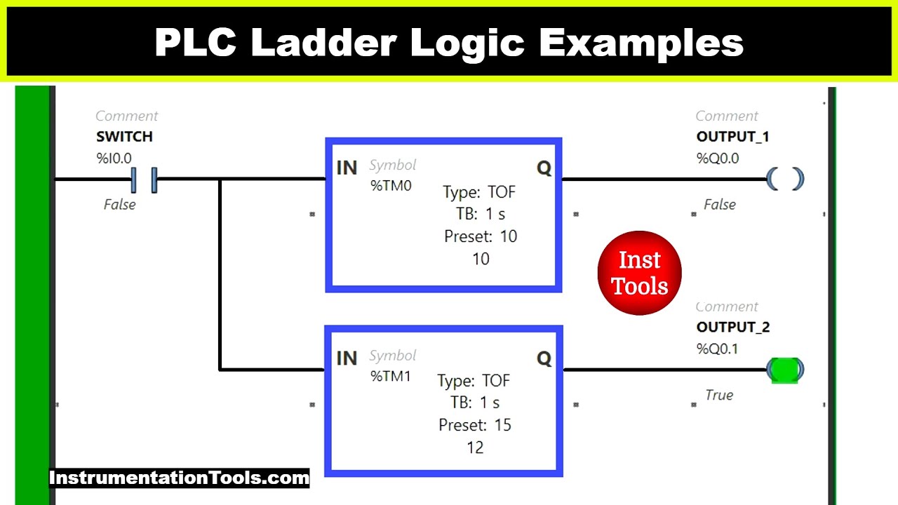

Problem Statement:
We are using one switch to control 2 outputs.
When the Switch is turned ON, Output 1 and Output 2 will be ON.
When the Switch is turned OFF, Output 1 will be OFF after 10 seconds and Output 2 will be OFF after 15 seconds.

Ladder Logic
PLC Example on Switch Program with Timers
Program Description
We have used Normally Open Contact for Switch (I0.0).
In Rung 0:
  1. Normally Open Contact is used for Switch (I0.0) to Turn ON Output 1 (Q0.0) and Output 2 (Q0.1).
  2. Timer-type TOF is used to delay the turning OFF time of the Output 1 (Q0.0) for some time.
  3. Another Timer-type TOF is used to delay the turning OFF time of the Output 2 (Q0.0) for some time.

When Switch (I0.0) is turned ON
PLC programs that use timers and switches
When Switch (I0.0) is turned ON, the signal will flow through Switch (I0.0) as Normally Open Contact used for Switch (I0.0) will be in True State and Output 1 (Q0.0) & Output 2 (Q0.1) will turn ON.
When Switch (I0.0) is turned OFF
Switches and Timers in PLC
 When Switch (I0.0) is turned OFF, the output 1 (Q0.0) remains ON but for a limited time because Timer Function Block type TOF is used to delay the turning OFF time of the output 1 (Q0.0) and time is set to 10 seconds.
Timers in PLC and ladder logic program
After 10 seconds, the output 1 (Q0.0) will turn OFF.
Also, When Switch (I0.0) is turned OFF, the output 2 (Q0.0) remains ON but for limited time because another Timer Function Block type TOF is used to delay the turning OFF time of the output 2 (Q0.0) and time is set to 15 seconds.
After 15 seconds, the output 2 (Q0.0) will turn OFF.
