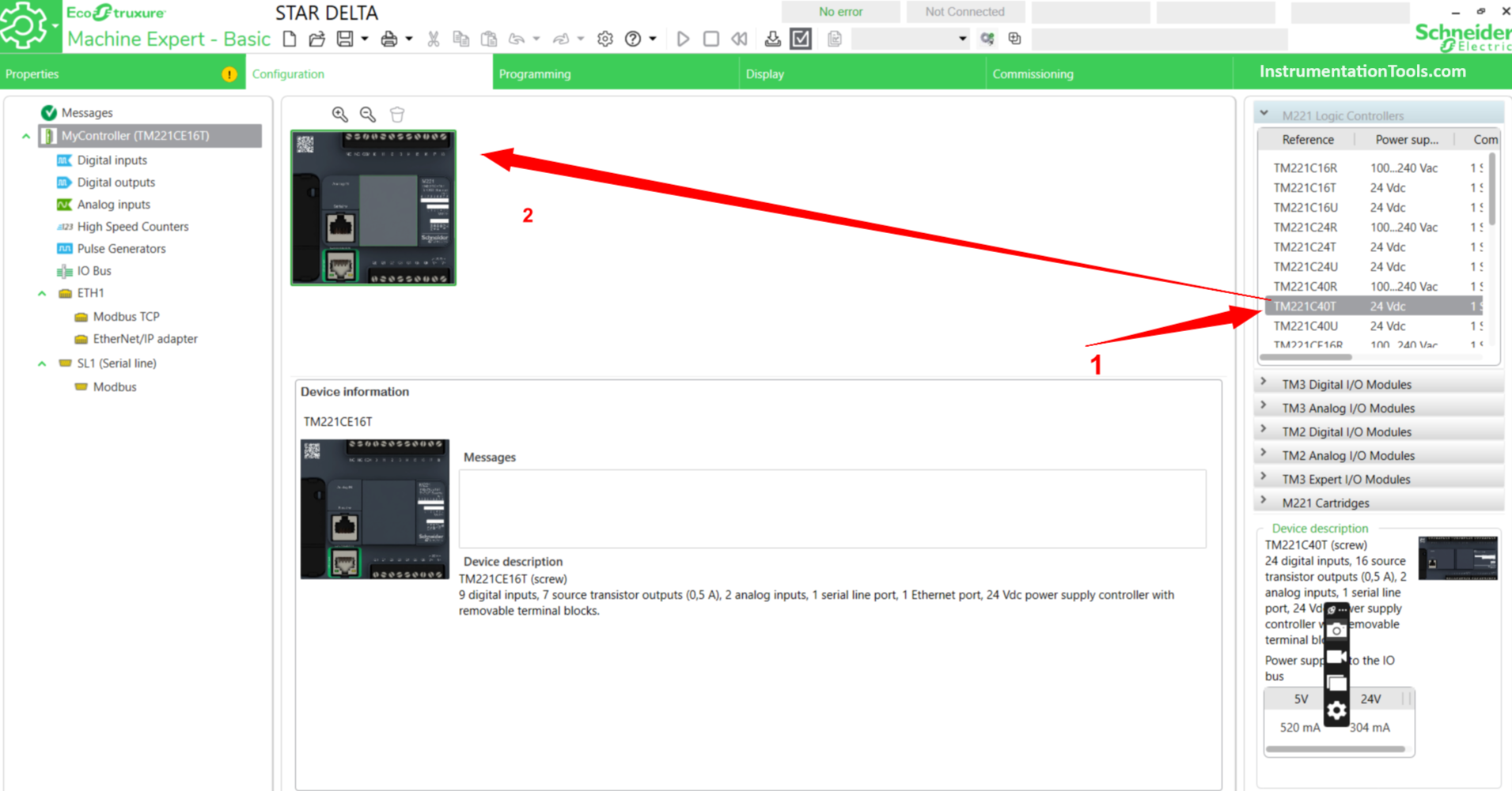

Open EcoStruxure Machine-Basic PLC Software. Enter the Configuration menu to set the type of PLC used, and Digital Input / Output contact settings to be used.
Choose PLC type, PLC as needed, in this program, I use type TM221C40T. To change or add PLC we can click the type of PLC in the list column and then drag it to the work page as shown below.
Initial Setup
