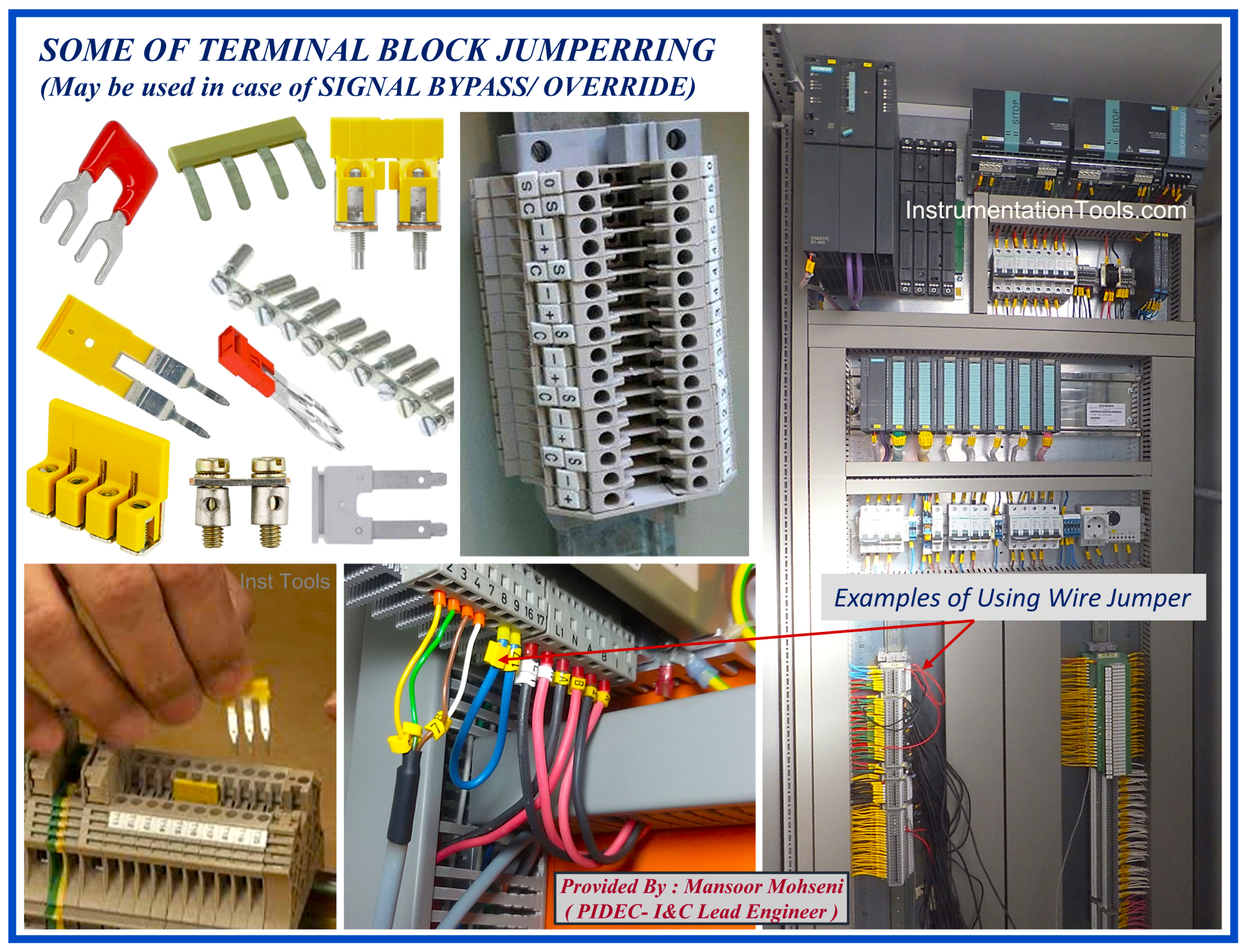

Hardwired Jumper at Termination Point Terminals
This type of bypass may be applicable to terminals at the Field Junction Box or even on the terminals of the input section of the Marshalling Cabinets of the Safety System.
This type of bypassing the signal is similar to a jumper at field instruments, while some of the weaknesses, like device proof testing, checking the real state of the instrument signal, and access problems for doing the job, are covered.
However, in these types of bypassing the signal, the Safety System is blind to the activity of bypassing too, and so there is no automatic tracing or system documentation available, and they need exact administrative controls.
These types of hardwired bypassing may be done in different ways, while Figures 3 and 4 show two common ways in this regard. As figures show, the bypassed point may not be clear at quick glance and needs exact investigation. In fact, twisting the signal wires may be missed behind the crowded/ condensed wires, and direct twisting of the wires without any cover may cause a short circuit between system powers and any grounded metallic parts or enclosures, and hence may produce system power cut-off and, accordingly, process plant shutdown.
Due to the mentioned negative points, such bypassing ways are not used nowadays either.
Figure 3: Signal Bypass by Twisting/ Joining Signal Wires.
Figure 4: Signal Bypass via Jumper on Terminal Block.

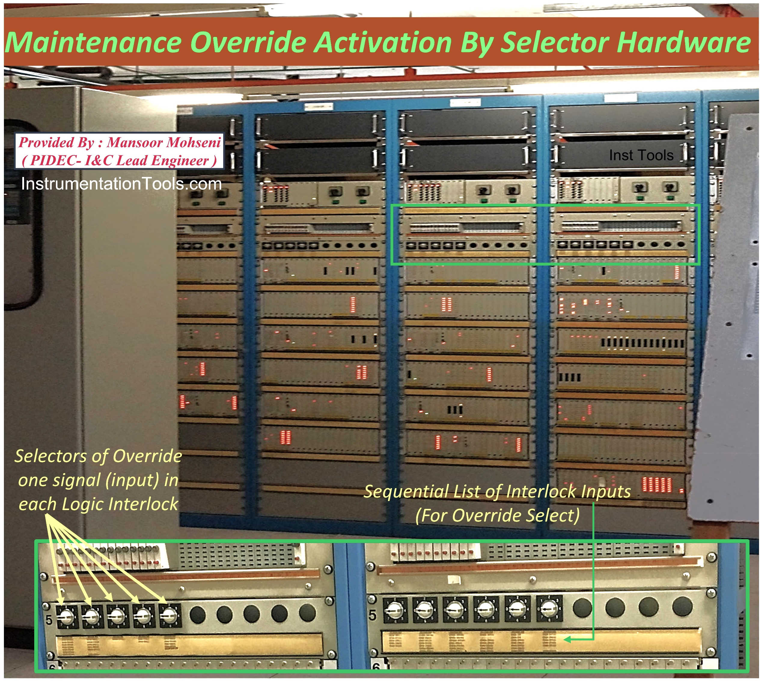

Bypass by Using a Selector Switch at the Input Panels
By inserting the Selector Switches in the system input hardwired connection, the input signal will be bypassed by regular, clean, clear, and fast pre-connected circuits (/ relays), and so it covers some weaknesses of the mentioned hardware jumpers. Figure 5 shows a sample of using selectors for bypassing the signal.
Figure 5: Using Selector Hardware for Bypassing the Signal.
Due to the critical importance of making fewer changes to safety configurations, further to space limitations (for inserting one selector on each input), as Figure 5 shows, one selector is considered for a group of interlock inputs. On the other hand, in this way, just one input of each group of inputs (to interlock) can be bypassed (although the bypassing will occur after selecting the input and then connecting the power supply to the input of the selector switch, as enabled). This type of hardware bypassing is regulated, fast, and standard way, but still in this way, the Safety System will be blind to the Bypass job, and needs exact administrative controls.
If the outputs of selector signals (without any additional relays) connected to Safety System Inputs and were combined with each input of interlock, inside the logic diagram, it would reach nearly to nowadays bypassing routine (as we see in the following). Figure 5 may even be implemented for this type of Bypassing.

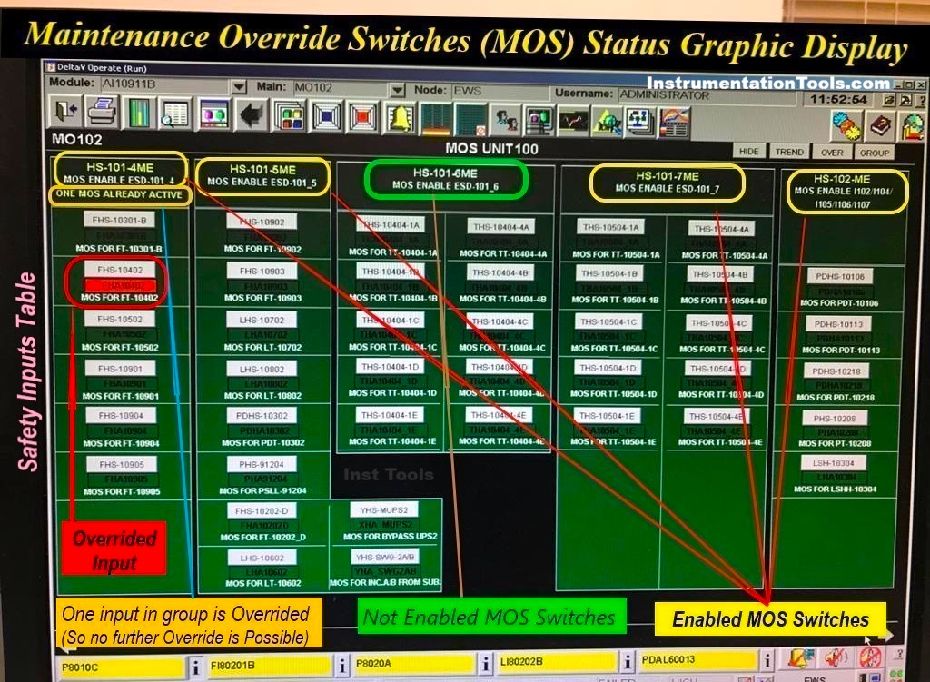

Bypass via Maintenance Override Switch (MOS)
The Maintenance Override Switch (MOS) bypass is done through the Safety System Application Program and by using some Maintenance Override Switches (MOS) and enabling conditions. There are different ways for applying this type of Bypassing (even via using Hardware or Software Switches and possible security and tracing), but the main requirements of such Bypassing are mentioned in the IEC-61511 standard.
Usually, in the MOS type of Bypassing, one hardwired (key) switch on the Safety System Hardwired Console will enable the Bypassing of input signals of one interlock, and then the I&C Engineer, through the Safety System or Process Control System Engineering Workstation (or even by secured provided HMI pages), will request the override of the subject input. This request will be processed (check for applicability) in the application program, and in the case of acceptance, Override will be activated and recorded by suitable alarms and indications for further tracing by Control and Safety Systems facilities (like alarm management and log recording). This type of Bypassing is applicable for both Digital and analog input Signals.
Figures 7 and 8 show a sample of the provided MOS Enable Hardwired Switches (on the hardwired Console) and the Relevant HMI Graphic page for monitoring the statuses.
Figure 7: Sample of MOS Enable Switches on Hardwired Console for each Safety System Interlock.
Figure 8: Sample of Graphic Display Page for Monitoring Override Status of Safety System Inputs
For a small process (or unit) project with limited I/O, instead of applying request by I&C Engineer through above mentioned items, Override Request may be done also via separate hardwired (key) switches (for each input/ device) or Interlock Selectors (as we found above) further to MOS Enable (key) Switches (but with good security protections). However, for a medium-scale process project due to physical space limitations, just the MOS Enable of each Interlock will be considered on the Hardwired Console (with above mentioned I&C actions).
For a big Process plant project with a great amount of I/O, limited MOS enable switches are considered on the Hardwired Console just for Process Units (Groups of Interlocks). Notice that, even if all process interlocks can be considered as relevant to one unit, just one MOS Enable Switch may be considered. In any mentioned cases, authentication checks and further administrative controls will be applied for authorisation security checks on applying an override of safety signals.
Let us have a more detailed investigation into this type of Bypassing/overriding.
As mentioned above, this type of Bypassing/overriding is applicable for both digital and analog signals.
This type of bypassing doesn’t cut the hardware connection of the input signal to the Safety System and will have effects on the action of input signals in Functional Safety Logics. Hence, at the same time as Bypass activation, continuous monitoring of real actual value of the input signal in Process Control System (by the Process Operator) will be continued.
In addition, since the bypassing function will occur inside the application program, Bypass Status Alarms and Indications may be easily produced and will be available inside the combined Process and Safety Systems with relevant HMI. This will help the process operators to easily trace the Bypass job status and make proper documentation via the combined Process and Safety Systems facilities.
Nowadays, bypassing the safety signals is done mainly by this type, but it should be noticed that due to project scale size, facilities of Combined Process and Control Systems, Process Safety/ Risk Analysis Conditions, and Engineering Design Practices, it can be done in different ways. (Studying one article for applying good actual practice may be helpful for finding different aspects of this type of Bypassing).
