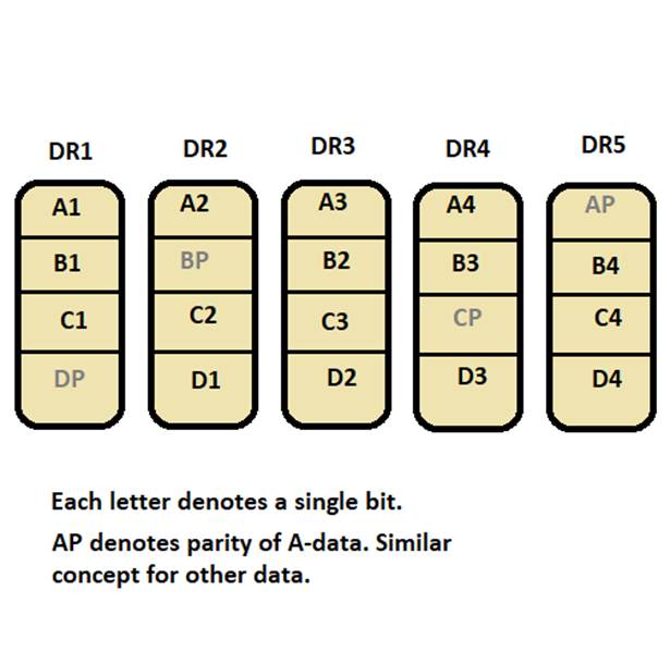

Now, let us understand what RAID is. It stands for a redundant array of independent disks. As the name suggests, data is split and stored in multiple disks. In each disk, a parity bit of each data is stored separately. This means suppose there are four amounts of data. Then, the parity bits of each of these four data will be stored in separate disks randomly. It is not like all the parity bits will be stored in a single disk.
Due to this, when any data disk fails, the data information is restored from the parity bit stored in another drive. And suppose the drive containing the parity bit fails; then your data is intact anyway in other drives. Just replace the drive and parity will be recalculated once again. The most used RAID type is RAID 5, where a minimum of three disks are required for data storage and splitting. Refer to the below image for more understanding.
What is Raid Parity? - Types, Advantages, Disadvantages
The issue in RAID arises when multiple drives fail. It is designed to handle only one disk failure. So, in case of failure of two or more drives, data redundancy is not possible and you will need the last backup if you have stored any for restoring data. One thing to note is that various error-checking algorithms are calculated before choosing the correct drive for the parity bit. The highest used RAID configuration to date is RAID 10.
