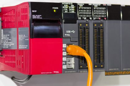

What is a Network Switch?
A network switch is a multi-port device which has multiple communication points in it for linking various Ethernet devices and making it as a central hub.
Suppose there are 4 devices on a network. Instead of using their local ports for interlinking all 4 devices, which would make the network topology literally complex to operate, a switch can be used.
In this, 4 ports will be consumed in the switch and each port will have one cable coming from the corresponding device. This will interlink all the devices with each other and make Ethernet communication easy.
