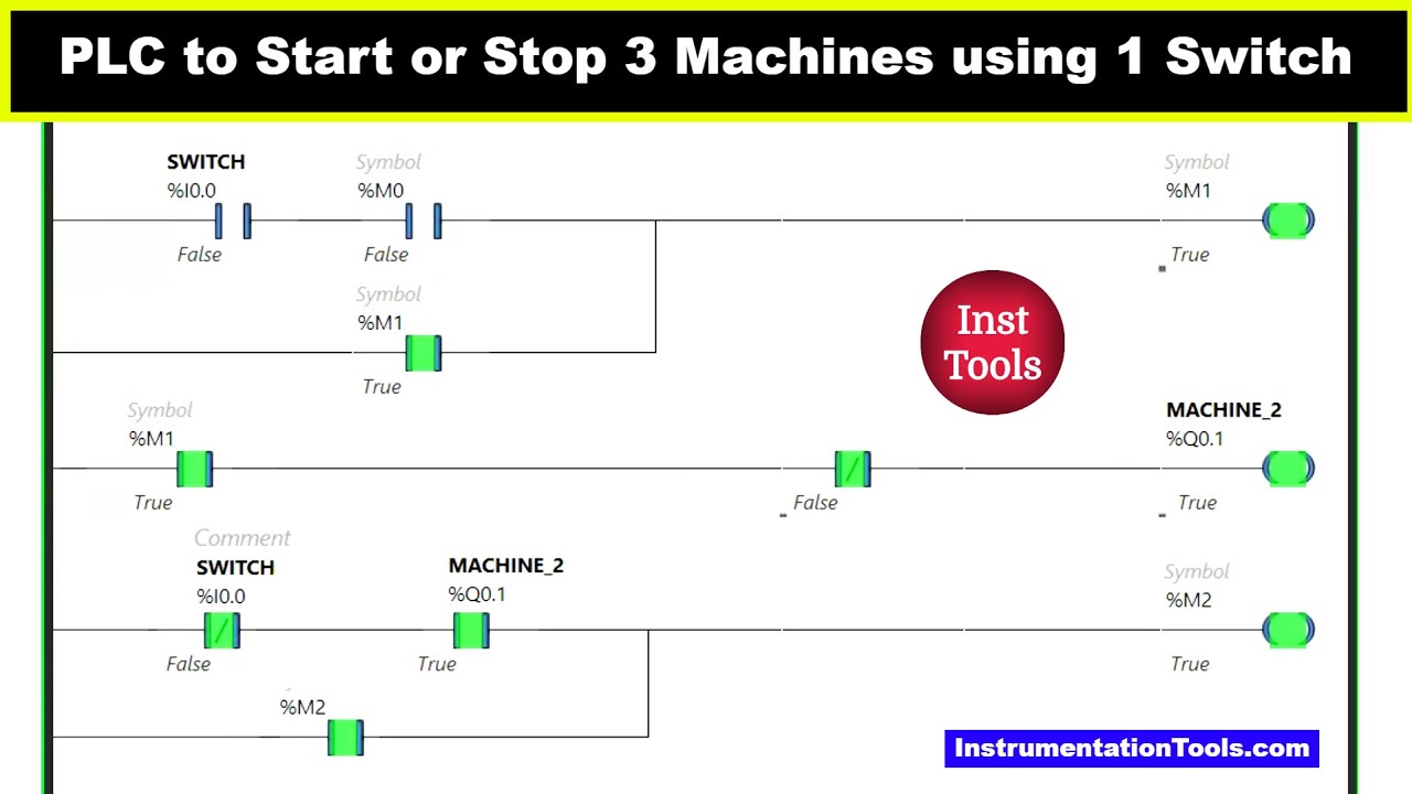

Problem Statement
We are using one push button to control three Machines.
When the Push Button is pressed and then released, then Machine 1 will be ON.
When the Push Button is pressed again and then released, then Machine 1 will be OFF and Machine 2 will be ON.
When the Push Button is pressed again and then released, then Machine 2 will be OFF and Machine 3 will be ON.

  • We used Schneider Electric PLC software.
  • In the above program, we have used Normally Open Contacts as well Normally Closed Contact and Memory Bits.
  • Normally Closed Contact is used for Memory Bit 2 in Rung0, Memory Bit 4 in Rung3 and for Push Buttons in Rung1 and Rung4.
  • In Rung0, 1) Normally Open Contact is used for Push Button  to turn ON Machine 1.
  • Normally Closed Contact is used for Memory Bit 2 to turn OFF Machine 1.
  • Latching is used for Machine 1 so that when Push Button is released, Machine 1 still remains ON.
In Rung 1:
1) Normally Closed Contact is used for Push Button and Normally Open Contact is used for Machine 1 to turn ON Memory Bit 1.
2) As Memory bit stores the data, Memory Bit 1 is used to store the data that Push Button has been released.
In Rung 2:
1) Normally Open Contacts are used for Push Button and Memory Bit 1 to turn ON Memory Bit 2.
2)  As Memory bit stores the data, Memory Bit 2 is used to store the data that Push Button is pressed a second time.
In Rung 3:
1) Normally Open Contact is used for Memory Bit 2  to Turn ON Machine 2.
2) Normally Closed Contact is used for Memory Bit 4 to Turn OFF Machine2.
In Rung 4:
1) Normally Closed Contacts are used for Push Button and Normally Open Contact is used for Machine 2 to turn ON  Memory Bit 3.
2) As Memory bit stores the data, Memory Bit 3 is used to store the data that Push Button has been released a second time.
In Rung 5:
1) Normally Open Contacts are used for Push Button and Memory Bit 3 to turn ON Memory Bit 4.
2) As Memory bit stores the data, Memory Bit 4 is used to store the data that Push Button is pressed and released third time.
In Rung 6:
1) Normally Open Contact is used for Memory Bit 4  to Turn ON Machine 3.
So, When Push Button  is pressed, signal will flow through it as Normally Open Contact is used for Push Button  in Rung0. In false state, Normally Closed Contact used for Memory Bit 2 also passes the signal and Machine 1 will turn ON.
When Push Button is released, Machine 1 will remain ON as Latching is used for Machine 1 in Rung0. When Push Button 1 is released, Normally Closed Contact used for Push Button in Rung1 will be in false state and allows the signal to pass. Normally Open Contact Used for Machine 1 in Rung1 will also pass the signal as it is in True state and Memory Bit 1 will turn ON which is connected with Push Button and Machine 1 in Rung1.
When Memory Bit 1 will turn ON, it will store the data that Push Button has been released. When Push Button is pressed again, Memory Bit 1in Rung 1 will turn OFF and Memory Bit 2 in Rung2 and Rung3 will turn ON.
So, When Memory Bit 2 will turn ON in Rung 2, Normally Closed Contact used for Memory  Bit 2 in Rung 0 will be in True state and Machine 1 will turn OFF and In Rung3, Machine 2 will Turn ON as Normally Open Contact used for Memory Bit 2 will be in True state and Normally Closed Contact used for Memory Bit 4 will be in false state.
When Push Button  is released again, Machine 2 will remain ON as Normally Open Contact used for Memory Bit 2 in Rung3  will be in True state and Normally Closed Contact used for Memory Bit 4 in Rung3 will be in false state. In Rung4, Memory Bit 3 will Turn ON and will store the data that Push Button has been released second time.
Pressing and Releasing Push Button again will turn OFF Machine 2 because Memory Bit 4 in Rung3, Rung5 and Rung5 will turn ON and will store the data that Push Button has been pressed and released third time.
So, Normally Closed Contact used for Memory Bit 4 in Rung3 will be in true state and does not allow signal to pass to Machine 2. In Rung6, Machine 3 will turn ON as Normally Open Contact used for Memory Bit 4 in Rung3 will be in True State and pass the signal to Machine 3.
