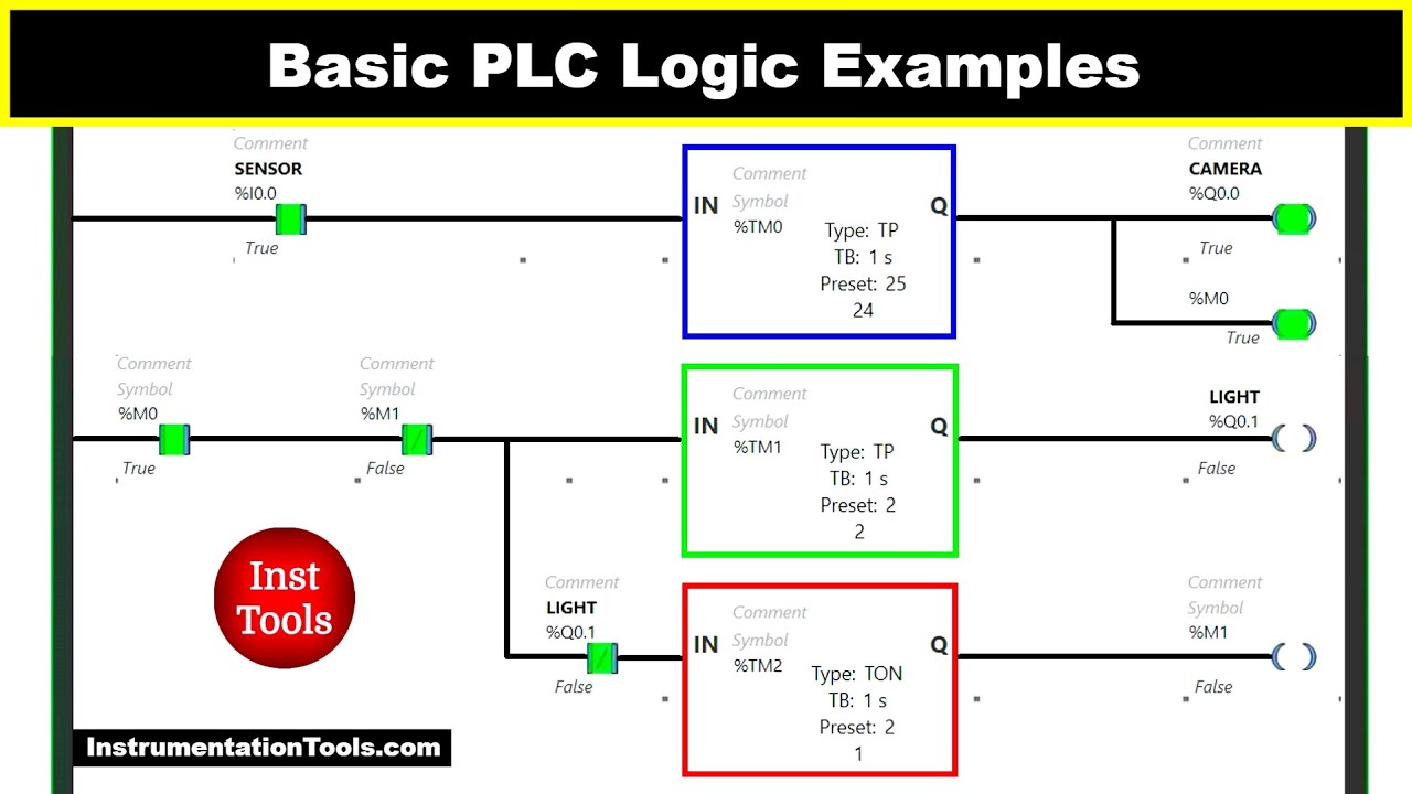

Problem Statement:
We are using one sensor to control the Camera and Light.
When motion is detected, a camera should start recording and continue for 25 seconds. With that, lights should also be turned at an interval of 2 seconds.

The inputs of the program are listed here.
Sensor: I0.0
PLC Outputs
The outputs of the program are listed here.
Camera: Q0.0
Light: Q0.1
Security Camera Ladder Logic
Program Explained
We have used Normally Open Contact for Sensor (I0.0) and Memory Bit 1 (M0).
In Rung0:
1) Normally Open Contact is used for Sensor (I0.0) to Turn ON  the output Camera (Q0.0) and Memory Bit 1 (M0).
2) Timer Function Block type TP is used to Turn ON the output Camera (Q0.0) and Memory Bit 1 (M0) for a limited time.
In Rung1:
1) Normally Open Contact is used for Memory Bit 1 (M0) to Turn ON the output Light (Q0.1) and Memory Bit 2 (M1).
2) Normally Closed Contact is used for Memory Bit 2 (M1) to turn OFF the output Light (Q0.1) and Memory Bit 2 (M1).
3) Normally Closed Contact is used for Light (Q0.1) to turn ON Memory Bit 2 (M1).
4) Timer Function Block type TP is used to Turn ON the output Light (Q0.1) for a limited time.
5) Timer Function Block type TON is used to delay the turning ON time of Memory Bit 2 (M1) for some time.
Result: When motion is detected
When Senor (I0.0) gets activated (Sensor detects motion),  the output Camera (Q0.0) turns ON (Camera starts recording) and Memory Bit 1 (M0) also turns ON in Rung0 as Normally Open Contact used for Sensor (I0.0) will be in true state and allows the signal to pass through it.
The output Camera (Q0.0) and Memory Bit 1 (M0) turn ON but only for a limited time as Timer Function Block type TP  is used to Turn ON the output Camera (Q0.0) and Memory Bit 1 (M0) for a limited time. The time is set to 45 seconds.
PLC driven camera
After 45 seconds, the output Camera (Q0.0) and Memory Bit 1 (M0) will turn OFF.  When Memory Bit 1 (M0) turns ON in Rung0, Normally Open Contact used for Memory Bit 1 (M0) in Rung1 will be in a True state and allow the signal to pass through it.
In a false state, Normally Closed Contact used for Memory Bit 2 (M1) also passes the signal to turn ON the output Light (Q0.1). The output Light (Q0.1) turns OFF after some time as Timer Function Block type TP  is used to Turn ON the output Light (Q0.1) for a limited time. The time is set to 2 seconds.
PLC Application Examples of Programming
After 2 seconds, the output Light (Q0.1) will turn OFF. When the output Light (Q0.1) turns OFF, Normally Closed Contact used for Light (Q0.1) will be in a false state and pass the signal to turn ON Memory Bit 2 (M1) and Memory Bit 2 (M1) turns ON but after a delay of 2 seconds as Timer Function Block type TON is used to delay the turning ON time of Memory Bit 2 (M1). The time is set to 2 seconds.
PLC Timer example security camera
After 2 seconds, Memory Bit 2 (M1) will turn ON but it will turn OFF within no time because in Rung1, Normally Closed Contact is used for Memory Bit 2 (M1). In Rung1, Normally Closed Contact used for Memory Bit 2 (M1) will also turn ON and OFF within no time and the whole process will restart in Rung1.
PLC sensor detects motion and turns lights on and off
In Rung0, when Timer Function Block Type TP reaches its time limit i.e. 25 seconds, the output Camera (Q0.0) will turn OFF ( Camera stops recording) and Memory Bit 1 (M0) will also turn OFF.
As Memory Bit 1 (M0) turns OFF in Rung0, Normally Open Contact used for Memory Bit 1 (M0) in Rung1 will be in a false state and does not allow the signal to pass through it and the whole process stops in Rung1.
