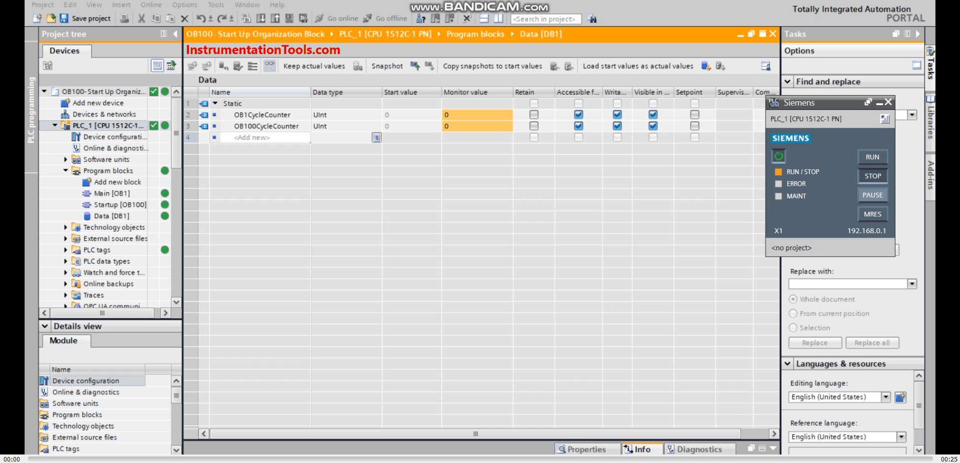

In this example, we will add a start-up OB100 to our PLC logic and see how many times the OB100 is executed. See picture 1 for adding a new OB100.
Tia Portal - OB100 Start-up Organization Block
Picture 1 – Add an OB100
As you see from the last picture, you add startup organization blocks the same way we add a function of a function block.
