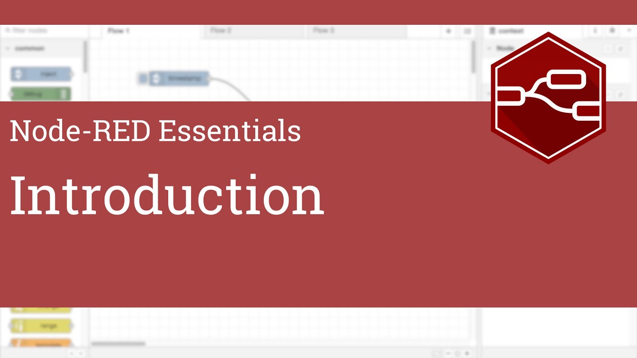

Introduction - Node-RED Essentials
In this way, we saw how to use Node-Red in industrial automation.
