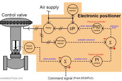

  7. The instrument team checked the positioner’s output. The output air from the positioner to the actuator was fluctuating (verified through the gauge given on the positioner). Hence instrument team removed the positioner and opened the positioner in the workshop.
Findings in the workshop after opening positioner
After opening the positioner, everything was found intact. No physical damage was found in the positioner. After disassembling each and every component of the positioner, one strange thing was observed. The I/P’s air filter was having foreign material deposited on it.
A similar observation was found in many other positioners. So, the instrument team simply replaced the I/P’s air filter in one of the positioners and installed it back. The positioner started working fine.
