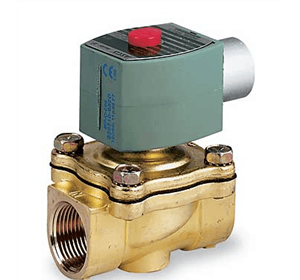

Solenoid Valve
Solenoid Valve Troubleshooting Practices
