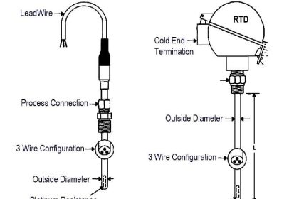

Convert 2 wire RTD to 3 wire RTD
Learn how to convert your 2 wire RTD into a 3 wire RTD.
You have to connect an extra cable between any one of the terminals of RTD and 3rd terminal of the temperature transmitter.
The temperature transmitter must be configured as a 3 wire RTD sensor.
This configuration helps you to reduce the temperature measurement error of 2 wire RTD. You can follow this procedure when you don’t have the option to use a 3 wire RTD sensor.
Note: This is procedure is not a replacement for using a 3 wire RTD sensor.
The measurement error will be reduced when compared to the 2 wire RTD. The measurement error will be more when compared to the 3 wire RTD.
