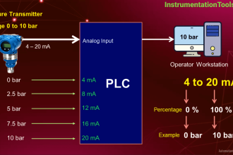

What are Analog Input/output & Digital Input/output?
4-20 mA signals from instrument (transmitters) are analog input to control system.
4-20 mA signals to instrument (I/p & electro pneumatic positioner) are analog output from control system.
Volt free (24V) contact (NO/NC) by instruments (all type of switches, ex. Limit switch, press,temp,flow,level switch) are digital input to control system.
All powered signals (24V, 48V, 110V….) from system to instruments (SOV) are Digital outputs.

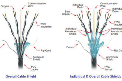

Types of instrument cables?
IS cables & NIS cables
IS – Intrinsic safety & NIS – Non Intrinsic safety
Which cable to use, depends upon hazards condition.
