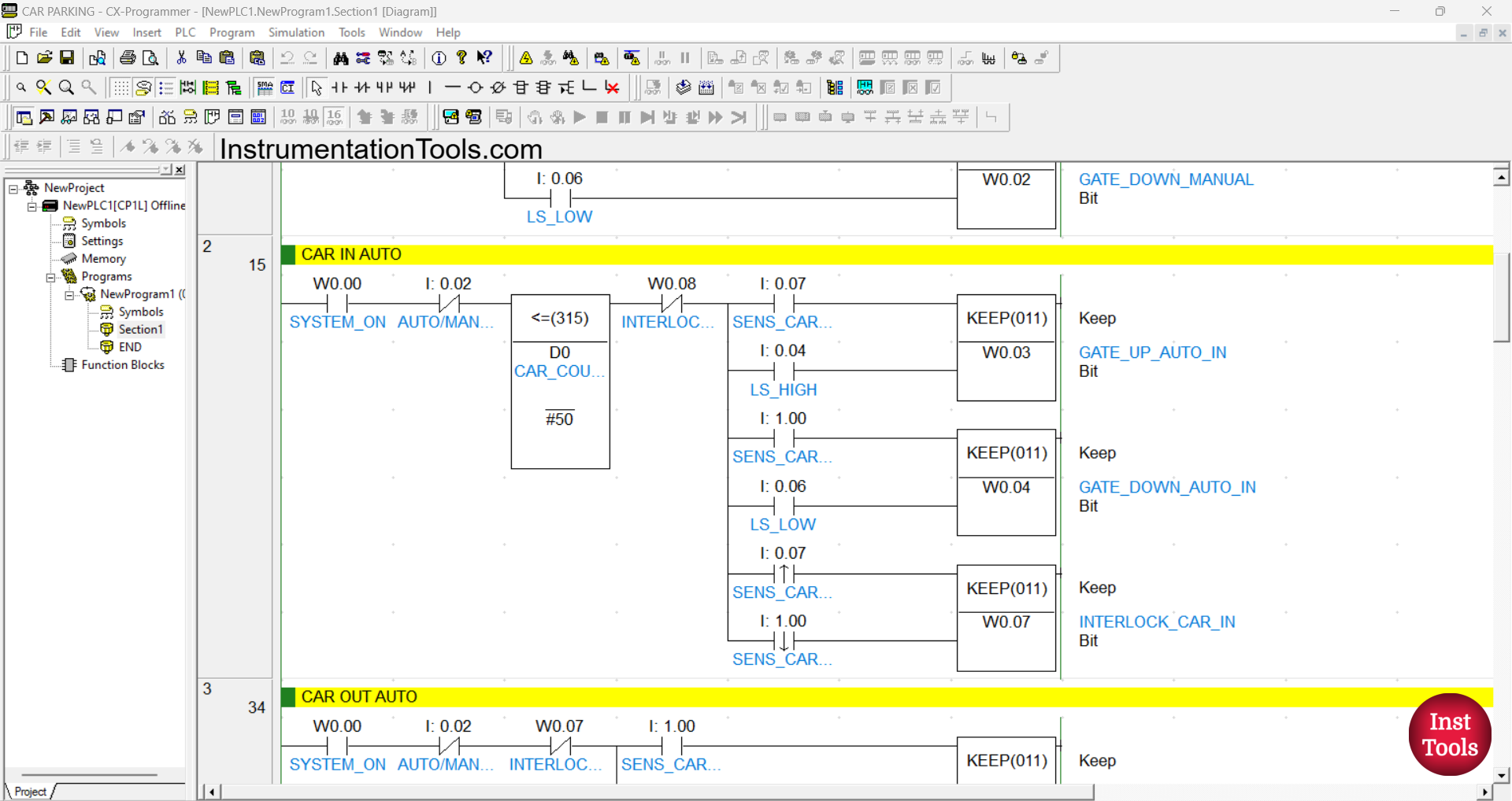

RUNG 2 (CAR IN AUTO)
In this Rung, the memory bits GATE_UP_AUTO_IN (W0.03) and INTERLOCK_CAR_IN (W0.07) will be in the HIGH state when the NO contacts of the memory bit SYSTEM_ON (W0.00) and Sensor SENS_CAR_1 (0.07) are in the HIGH state and the value of the memory word CAR_COUNT (D0) Less Than Or Equal To “50”.
The memory bit GATE_UP_AUTO_IN (W0.03) will be in the LOW state when the NO contact of the limit switch LS_HIGH (0.04) is in the HIGH state.
The memory bit GATE_DOWN_AUTO_IN (W0.04) will be in the HIGH state when the NO contact of the memory bit SYSTEM_ON (W0.00) and Sensor SENS_CAR_2 (1.00) are in the HIGH state and the value of the memory word CAR_COUNT (D0) is Less Than Or Equal “50”.
The memory bit GATE_DOWN_AUTO_IN (W0.04) will be in the LOW state when the NO contact of the limit switch LS_LOW (0.06) is in the HIGH state.
The memory bit INTERLOCK_CAR_IN (W0.07) will be in the LOW state when the NO contact of the sensor SENS_CAR_2 (1.00) changes to the LOW state.

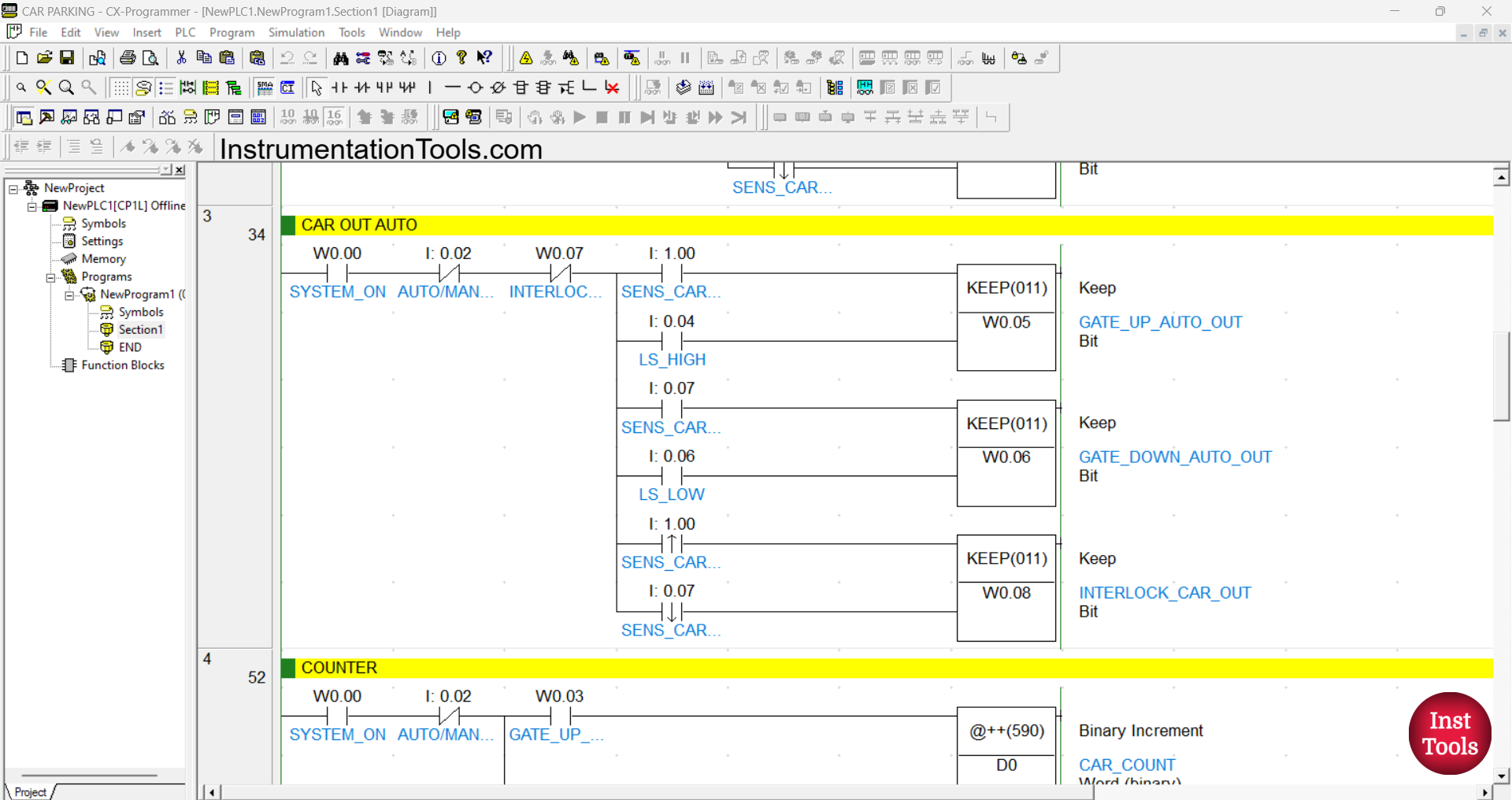

RUNG 3 (CAR OUT AUTO)
In this Rung, the memory bits GATE_UP_AUTO_OUT (W0.05) and INTERLOCK_CAR_OUT (W0.08) will be in the HIGH state when the NO contacts of the memory bit SYSTEM_ON (W0.00) and Sensor SENS_CAR_2 (1.00) are in the HIGH state.
The memory bit GATE_UP_AUTO_OUT (W0.05) will be in the LOW state when the NO contact of the limit switch LS_HIGH (0.04) is in the HIGH state.
The memory bit GATE_DOWN_AUTO_OUT (W0.06) will be in the HIGH state when the NO contacts of the memory bit SYSTEM_ON (W0.00) and Sensor SENS_CAR_1 (0.07) are in the HIGH state.
The memory bit GATE_DOWN_AUTO_OUT (W0.06) will be in the LOW state when the NO contact of the limit switch LS_LOW (0.06) is in the HIGH state.
The memory bit INTERLOCK_CAR_OUT (W0.08) will be in the LOW state when the NO contact of the sensor SENS_CAR_1 (0.07) changes to the LOW state.

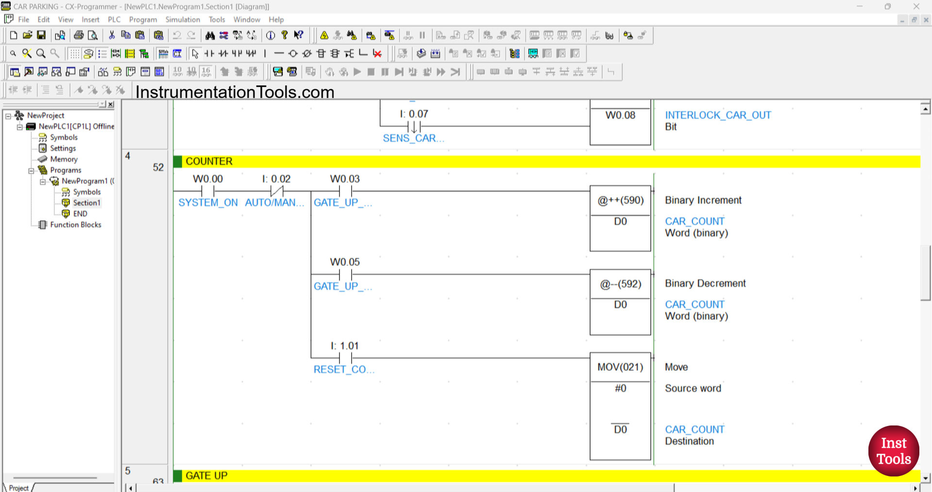

RUNG 4 (COUNTER)
In this rung, when the NO contacts of the memory bits SYSTEM_ON (W0.00) and GATE_UP_AUTO_IN (W0.03) are in the HIGH state, the value in the memory word CAR_COUNT (D0) will increase (+1).
And when the NO contacts of the memory bits SYSTEM_ON (W0.00) and GATE_UP_AUTO_OUT (W0.05) are in the HIGH state, the value in the memory word CAR_COUNT (D0) will decrease (-1).
If, when the NO contact of the memory bit SYSTEM_ON (W0.00) is in the HIGH state, and the RESET_COUNTER (1.01) button is Pressed, then the value in the memory word CAR_COUNT (D0) will be reset to zero value “0”.

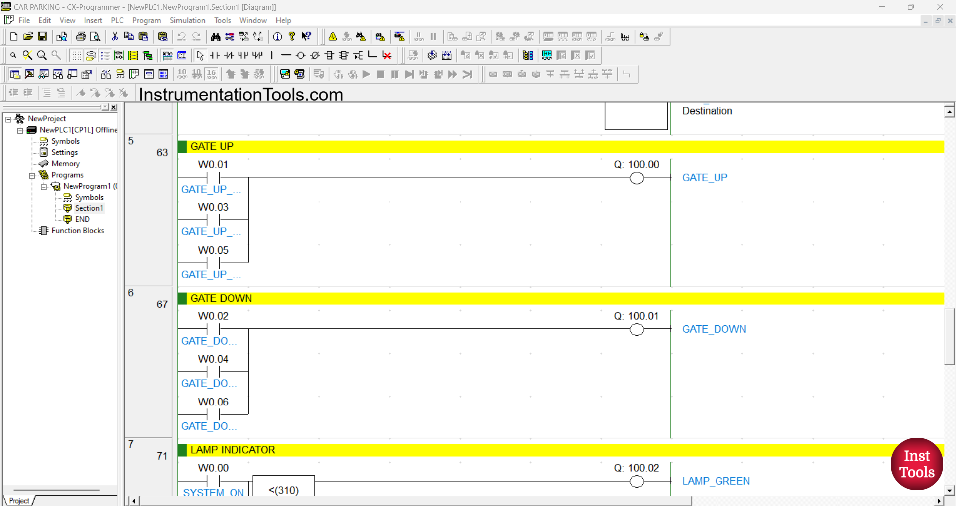

RUNG 5 (GATE UP)
In this Rung, when the NO contact of the memory bits GATE_UP_MANUAL (W0.01) or GATE_UP_AUTO_IN (W0.03) or GATE_UP_AUTO_OUT (W0.05) is in the HIGH state, the GATE_UP (100.00) output will be ON.
RUNG 6 (GATE DOWN)
In this Rung, when the NO contact of the memory bits GATE_DOWN_MANUAL (W0.02) or GATE_DOWN_AUTO_IN (W0.04) or GATE_DOWN_AUTO_OUT (W0.06) is in the HIGH state, the GATE_DOWN (100.01) output will be ON.

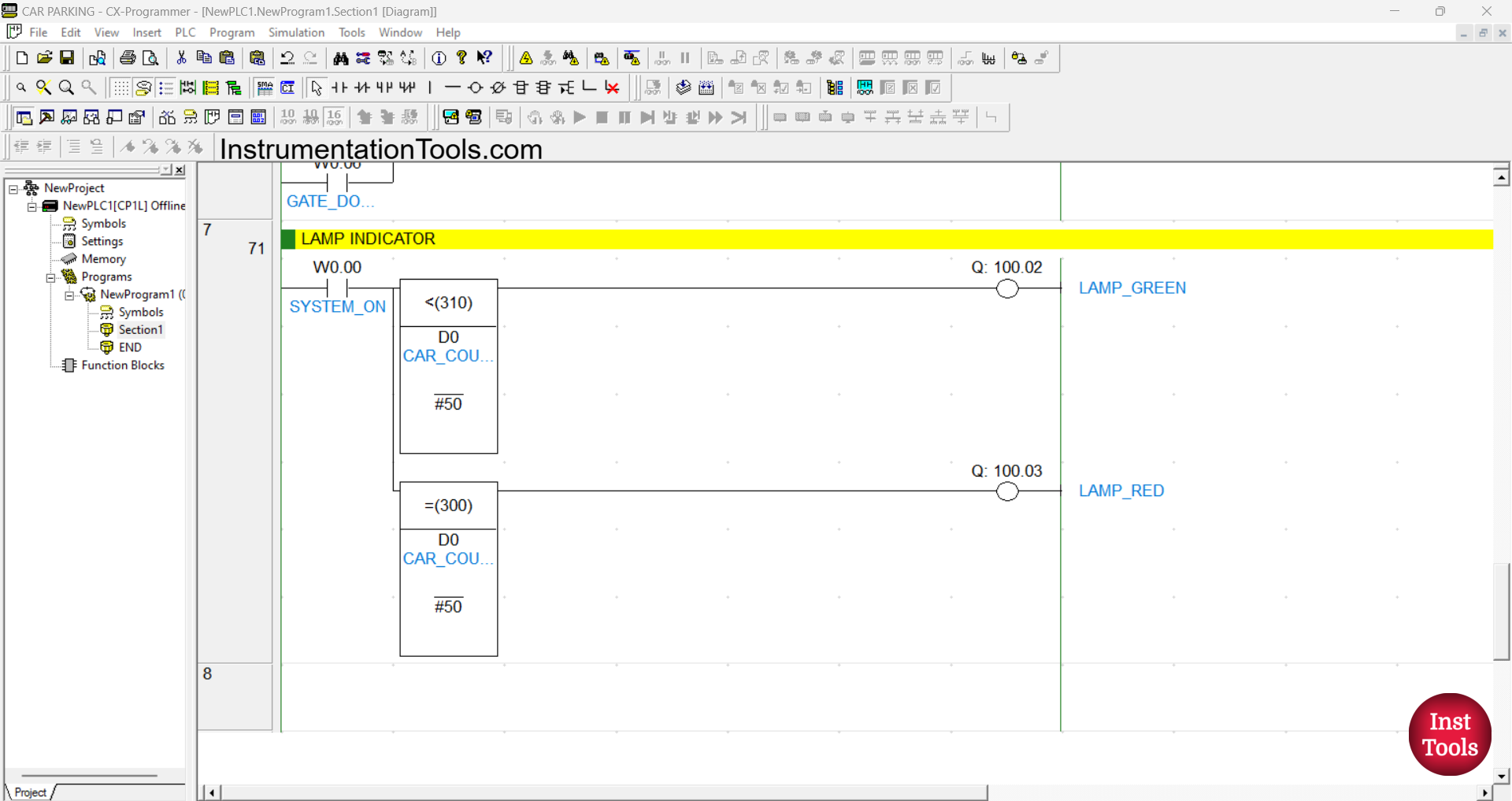

RUNG 7 (LAMP INDICATOR)
In this Rung, the output LAMP_GREEN (100.02) will be ON when the NO contact of the memory bit SYSTEM_ON (W0.00) and the value of the memory word CAR_COUNT (D0) is Less Than “50”.
The output LAMP_RED (100.03) will be ON when the NO contact of the memory bit SYSTEM_ON (W0.00) and the value of the memory word CAR_COUNT (D0) is Equal To “50”.
