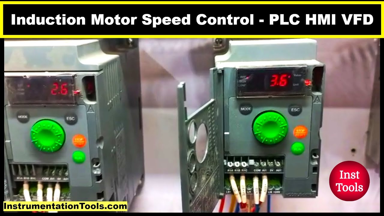

To change the motor’s speed, a 0 to 20 mA analog output signal from the PLC is sent into the analog input terminal of the VFD. The speed varies from 0 to 50 Hz as the milliamperes rise from 0 to 20. In this topic, we use six unique Analog Output points of the S7 200 smart PLC to control the speed of six motors. (each motor has individual VFD as per the motor rating).
The PLC used here is Siemens CPU ST60 of S7 200 Smart series having two analog output modules EM AQ04 coupled with it, while the VFD model is ATV310 series of Schneider Electric. Siemens HMI is communicated with CPU ST60 to vary the speed of the motors from its screen.

In the below video, you can see the VFDs and HMI. We can set the required motor speed through the HMI and then the VFDs will control the respective induction motor speed accordingly.
Induction Motor Speed Control - PLC HMI VFD
