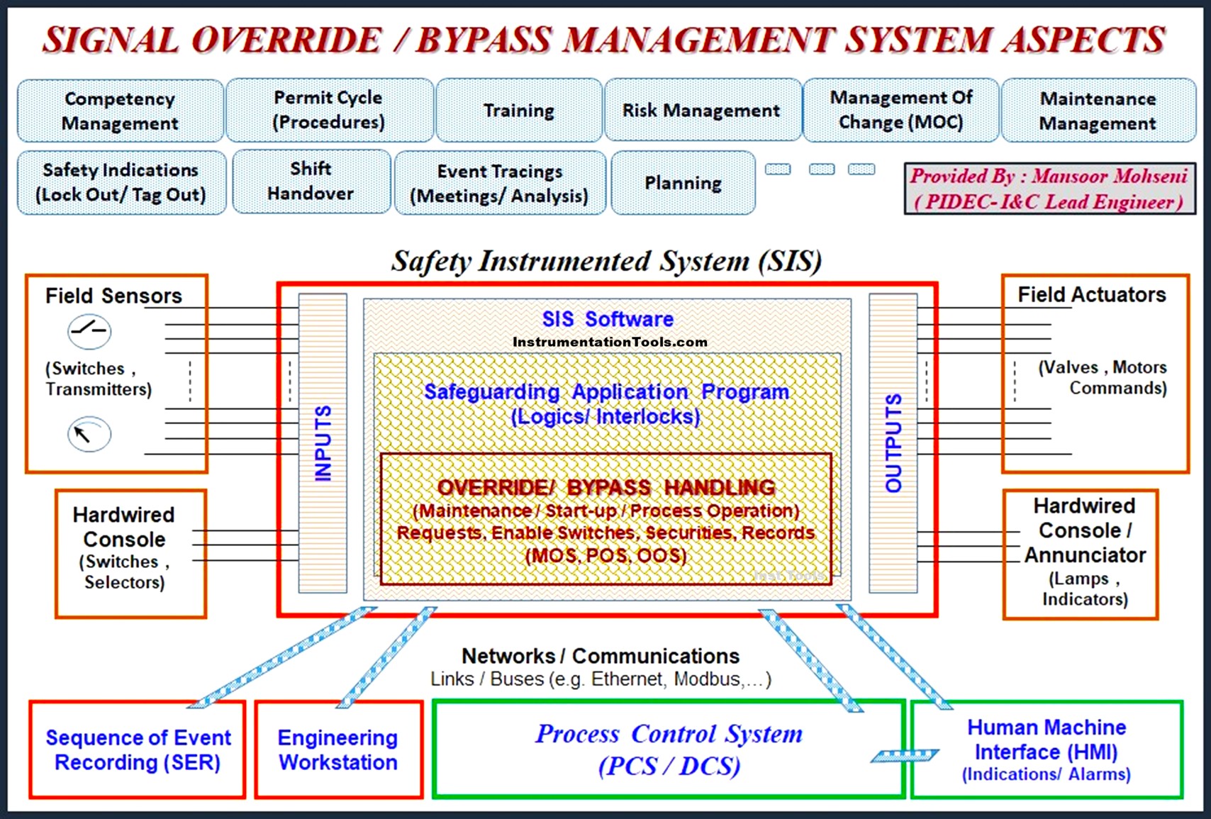

Managing Signal Override (in Combined Process Control & Safety Systems) as a Basic Core for Safety Bypass Program
If we focus on different aspects and targets of the Safety Bypass Program, we find that the basic core (tools) for providing systematic management (on Safety Bypass) are very relevant to those interactions and interfaces implemented in Combined Process Control & Safety Systems, as shown in Figure-4. As simple words, all mentioned elements of the Safety Bypass Program are to be provided in conjunction with sequences of actions implemented in Combined Process Control & Safety Systems.
Figure 4: Signal Override Interfaces/ Interactions as a Basic Core for Safety Bypass Management (Program).

It shall be strictly noted that the Bypass/ Override Management document as part of SRS is basically provided to help DCS/ESD Vendors for how to implement such facilities (i.e. the contents of this document provides basic essential facilities for applying the Maintenance Override Switches by the functionalities implemented in DCS/ESD Systems).
However, according to IEC-61511 Standard, it will be as a part of the Project Safety Requirements Specification (SRS) documents, which providesthe basis facilities in the Bypass/Override System (procedure) established at the project site by the end user (due to their organization charts and further administrative controls).”
Project Management/ Safety System at the project site shall provide a bypass procedure, according to safety standards and rules (as an example, OSHA 1910.119), and considering project site organization/ responsibility charts, and especially in order to define the exact sequence of making override, following actions to remove it, and finally disable action (via administrative controls).
End users may use extra management systems in conjunction with the implemented Override Management in Combined Process Control & Safety Systems (MOS in DCS/ESD) to guarantee the maximum safety and increased performance of project site activities. (For more study on Maintenance Override Switch (MOS) implementation in DCS/ESD, refer to the reference article)

Based on the overall requirements mentioned above, the details of the Safety Bypass Program/ Management shall be stablished by more details. As an example, at the first step, Figure-6 shows some more detailed titles of such requirements aspects.
At the second step, we may define the sequence of such titles as requested targets in the Safety Bypass Program/ Management.
The following sequence description may be considered a good practice for such a program.
The critical task of bypass management necessarily includes a program for review and approval prior to entering the bypass state (potentially including risk analysis), procedures for administrative compensating measures (if required), annunciation and tracking of active bypasses, and auditing of the proper use of bypasses. These tasks are greatly facilitated through the use of automation equipment and bypass management software, but manual activity logs are also effective when properly applied.
The first step in bypass management is the authorization process. Before placing a device into bypass, the rationale for why the device must be bypassed should be reviewed to ensure that bypass is appropriate. Part of this process needs to be a review of the risk associated with the bypass, which will consider the duration of the bypass, the type and effectiveness of compensating measures, the degree of risk associated with the hazard that the bypassed component is protecting against, and the reason for the bypass.
Bypasses that exceed the maximum allowable repair time of a component or are performed for reasons other than common repair or maintenance should be subjected to a bypass risk assessment. After the bypass has been implemented and all compensating measures have been put in place, the status of the bypass needs to be reviewed regularly.
This is commonly done through an operator hand-off process from shift-to-shift, where all bypasses are reviewed and confirmed for continued application as required. If bypasses exceed their allowable time duration, the continued use of the bypass must be escalated, potentially requiring additional bypass risk assessment. This process continues until the bypass is cleared and documented.”
Figure 6: Some more detailed titles of Safety Bypass Program/ Management aspects.

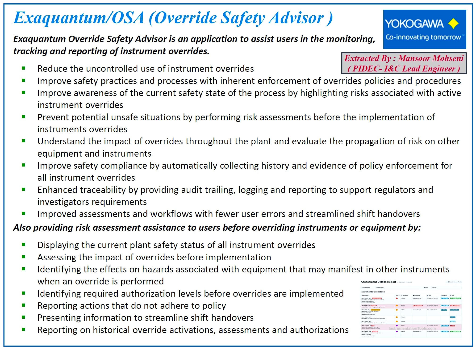

Systems Vendor’s Support for Safety Bypass Program/ Management
Some famous vendors of Control and Safety Systems, further to supporting Bypass Override facility through system software and project application program, they provide some extra software (option) facility for better arranging and establishing Bypass Safety Management at project site. As an example, Yokogawa suggests one part of Exaquantum as the Override Safety Advisor (OSA), which provides very good facilities and tools for Safety Bypass Management (see Figure 12). Figure 13 shows some of these facility titles, which are provided by OSA.
Figure 12: Yokogawa Exaquantum as an extra Process Plant Management Software (having different facilities such as Override Safety Advisor).
Figure 13: Some Facilities of the Override Safety Advisor (OSA) of Yokogawa Exaquantum for Safety Bypass Management.
