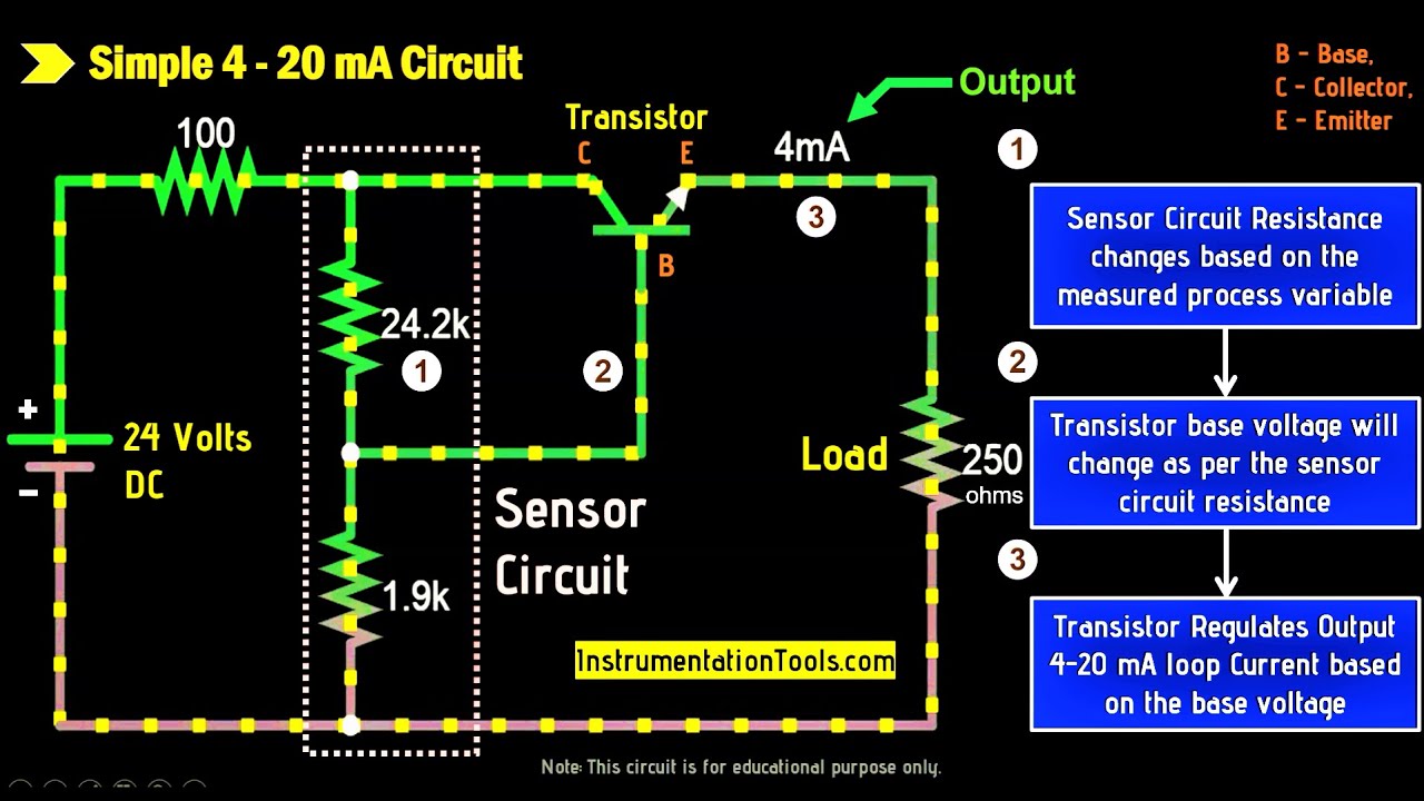

Assumptions : Standard +24V DC with 20mA
In General PLC / DCS Analog Input card channel supplies more than 20mA current to power the loop.
Case 1 : Process Variable @ 0%
The PLC / DCS Analog Input card transmits a standard +24 V DC, 20 mA signal to Power the Transmitter.
A one pair cable is used to power the transmitter and the same cable is used to receive the data in the 4-20mA current range.
Transmitter receives +24V DC, more than 20mA signal in the loop. A minimum +5V DC, 20mA signal is required to proper functioning of transmitter. In Practical there will be a voltage drop in the loop.
Transmitter have an inbuilt voltage regulator function which is used to regulate the loop current. The Transmitter will be configured with LRV, URV and other details of Process variable. The loop current will be varied / changed by the transmitter as per the measured Process variable.
The 4-20mA current will be converted into standard 1 – 5 V DC using a precision 250 ohms resistor. The Analog to Digital converter will be used to convert the voltage into digital signal which is used to indicate the Process Variable value in the DCS / PLC HMI.

4-20ma circuit schematic

      4-20mA is a common 24V instrumentation signal standard which equates with a 1-5V DC input signal when a 250ohm resistor is connected in parallel (shunt) configuration.
      Using ohms law IxR=V
      eg…..4mA(0.004)X250=1V
      ……..20mA(0.020)X250=5V
      • Bryon Lewis, PE, CMfgE - ISA Expert Subject Matter Author says:
        December 4, 2016 at 6:32 am
        The 250 ohm resistor is in series with the 4-20mA loop. Current loops are series circuits only!
        The resistor is in parallel with the high impedance VOLTAGE input to the signal input to the PLC/DCS card or data acquisition card.
    December 4, 2016 at 6:45 am
    Also I would like to mention that the 4-20mA loop only draws what the transmitter output is. All current that leaves the power supply (sourced) has to return to the power supply. The transmitter will not draw more than the alarm amount above 20mA (e.g.: 20.5 or 22.5 mA) and it will only deliver to the input card and back to power supply negative what it draws.
    What leaves the power supply, returns to the power supply!
    Very Important! Most transmitters require 10.5 to 13.8 volts to operate after calculating the voltage drop in the circuit. e.g.: 1.2 volts in wire VD + 10.5 volts for transmitter to operate = 11.7 volts minimum supply voltage.
