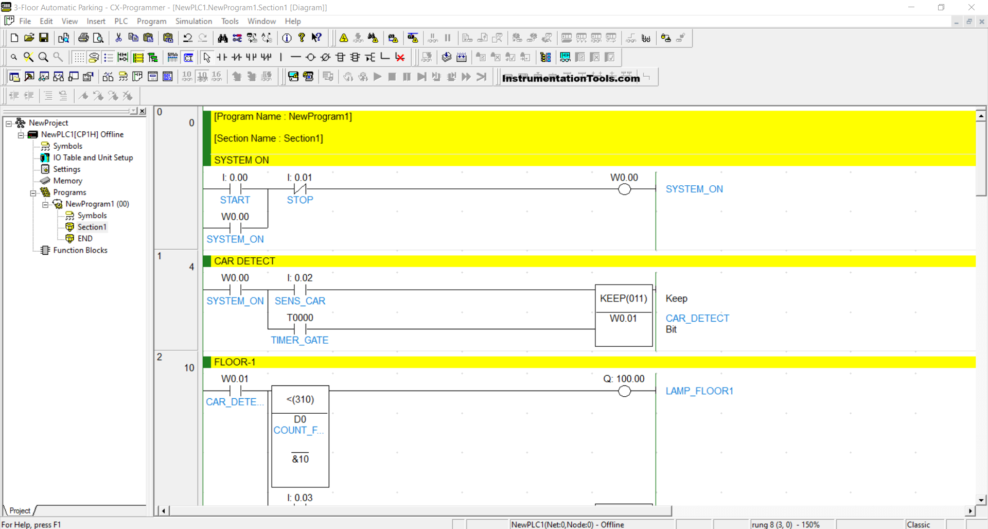

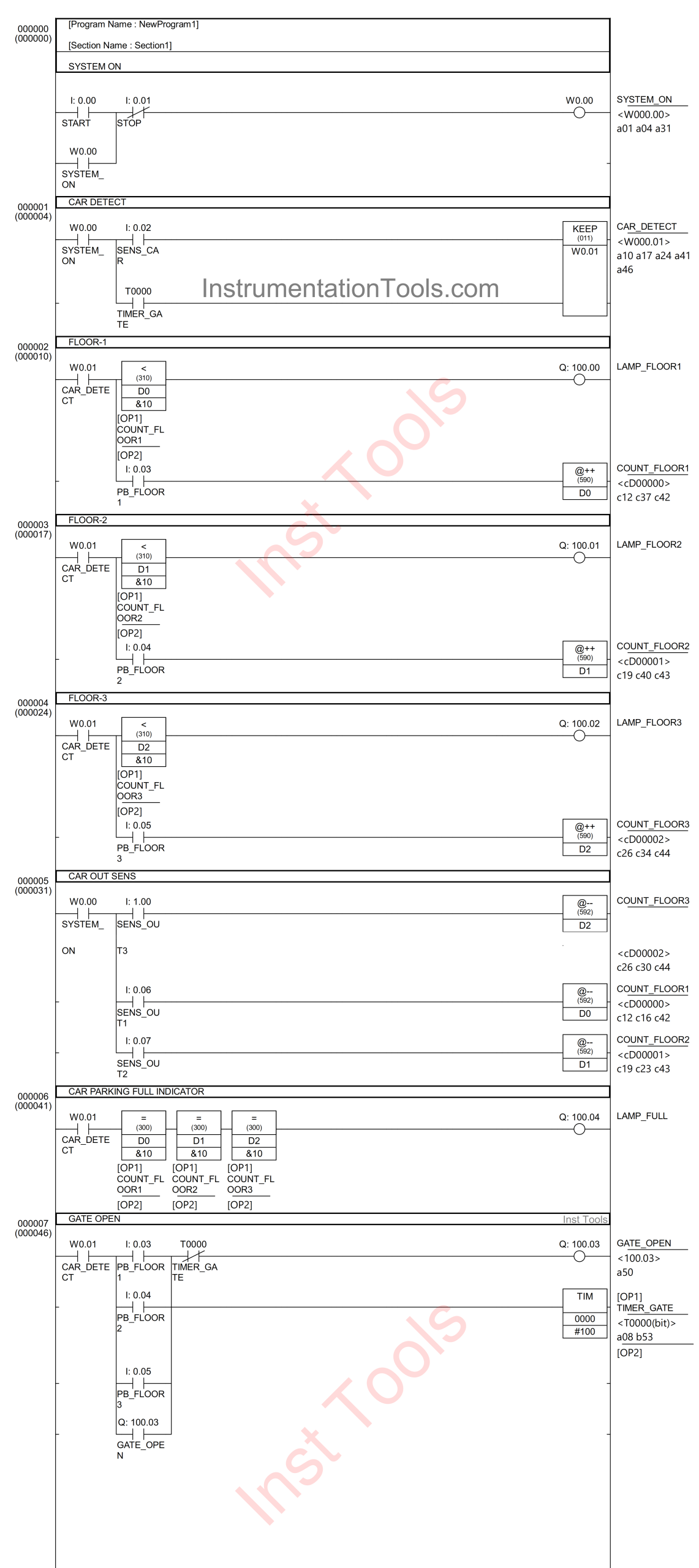

RUNG 0 (SYSTEM ON)
In this Rung, if the START (0.00) button is pressed, the memory bit SYSTEM_ON (W0.00) will be in a HIGH state. Because it uses Latching, the memory bit SYSTEM_ON (W0.00) will remain in a HIGH state even though the PB_START (0.00) button has been released.
The memory bit SYSTEM_ON (W0.00) will return to a LOW state if the STOP (0.01) button is pressed.
RUNG 1 (CAR DETECT)
In this Rung, when the NO contact of the memory bit SYSTEM_ON (W0.00) and the SENS_CAR (0.02) sensor are in a HIGH state, the memory bit CAR_DETECT (W0.01) will be in a HIGH state. Because it uses the KEEP(011) instruction, the memory bit CAR_DETECT (W0.01) will remain in the HIGH state even though the NO contact of the SENS_CAR (0.02) sensor has been in the LOW state. The memory bit CAR_DETECT (W0.01) will be in the LOW state if the NO contact of the TIMER_GATE (T0000) timer has been in the HIGH state.

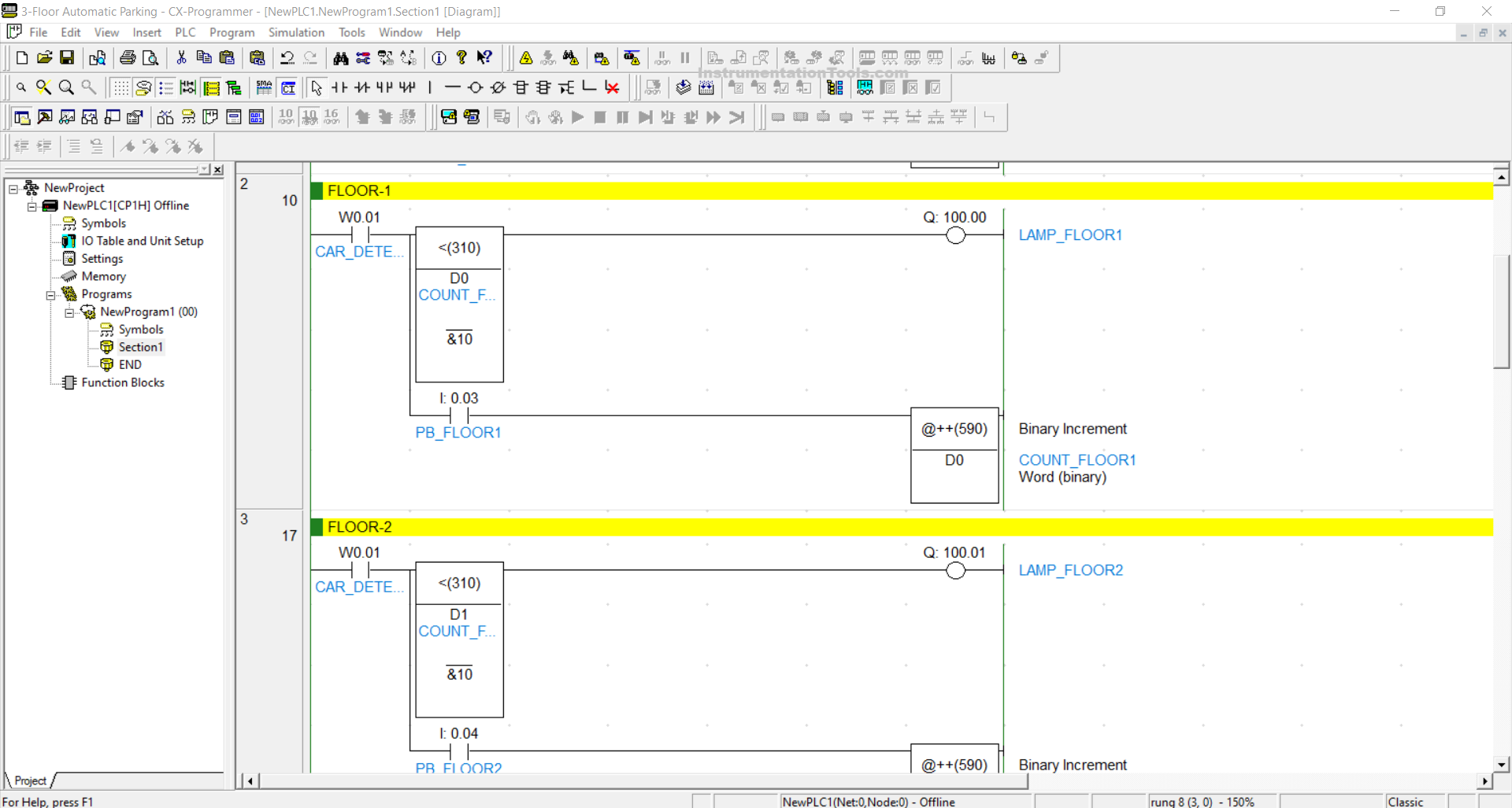

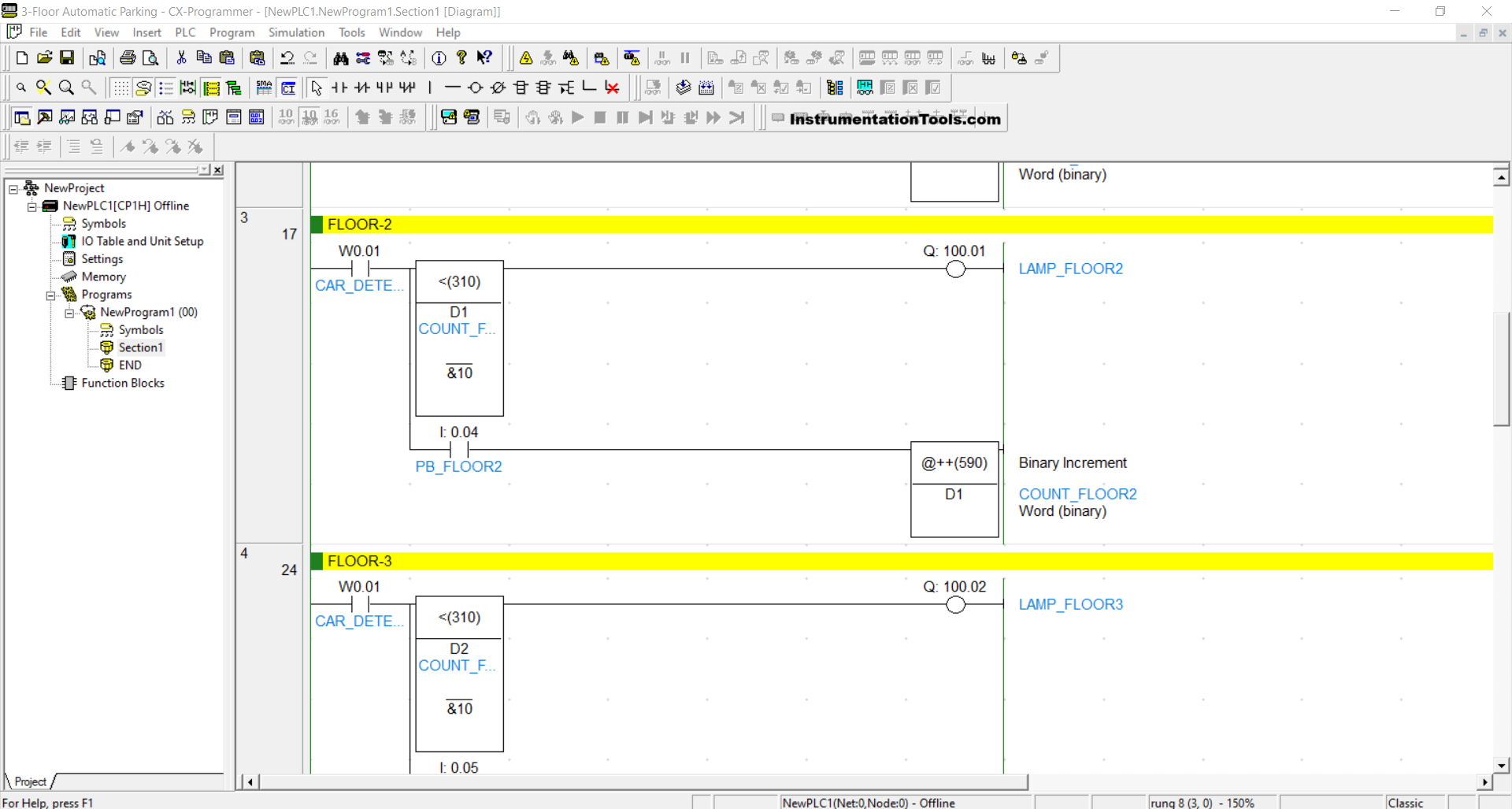

RUNG 2 (FLOOR-1)
In this Rung, when the NO contact of the memory bit CAR_DETECT (W0.01) and the memory word COUNT_FLOOR1 (D0) is Less Than “10”, the LAMP_FLOOR1 (100.00) output will be ON.
When the PB_FLOOR1 (0.03) button has been pressed, the value of the memory word COUNT_FLOOR1 (D0) will increase (+1) because it uses the Binary Increment / @++(590) instruction.
RUNG 3 (FLOOR-2)
In this Rung, when the NO contact of the memory bit CAR_DETECT (W0.01) and the memory word COUNT_FLOOR2 (D1) is Less Than “10”, the LAMP_FLOOR2 (100.01) output will be ON.
When the PB_FLOOR2 (0.04) button has been pressed, the value of the memory word COUNT_FLOOR2 (D1) will increase (+1) because it uses the Binary Increment / @++(590) instruction.

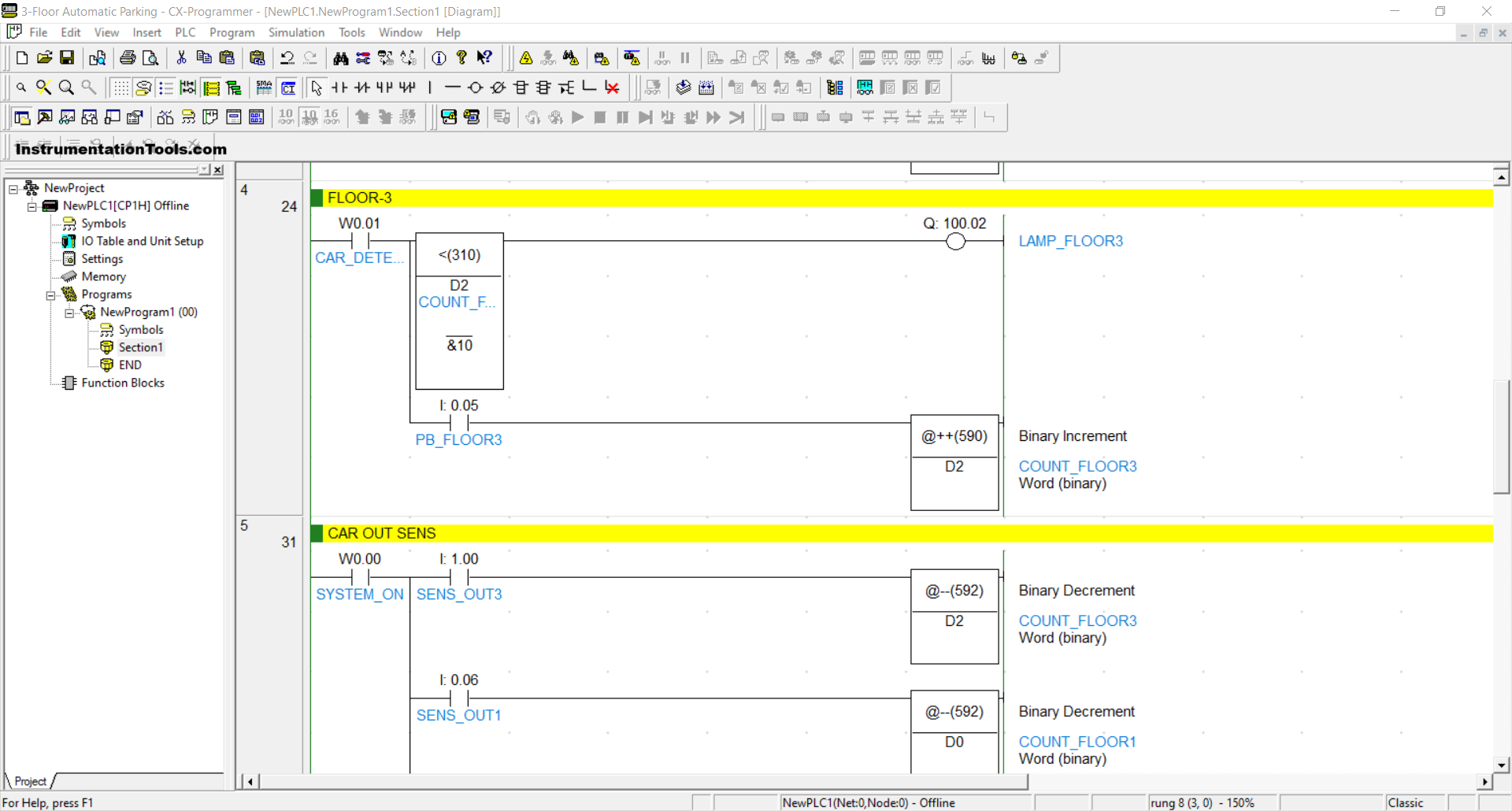

RUNG 4 (FLOOR-3)
In this Rung, when the NO contact of the memory bit CAR_DETECT (W0.01) and the memory word COUNT_FLOOR3 (D2) is Less Than “10”, the LAMP_FLOOR3(100.02) output will be ON.
When the PB_FLOOR3 (0.05) button has been pressed, the value of the memory word COUNT_FLOOR3 (D2) will increase (+1) because it uses the Binary Increment / @++(590) instruction.

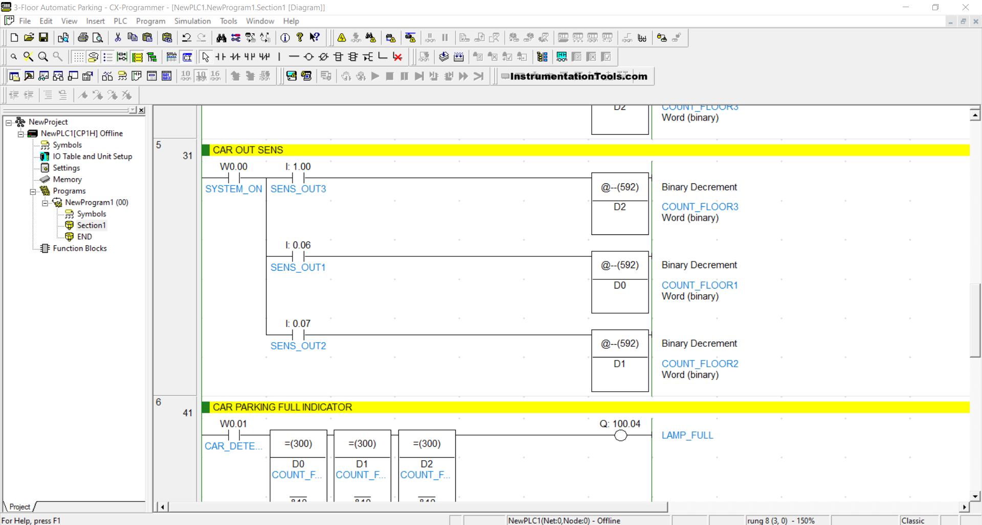

RUNG 5 (CAR OUT SENS)
In this Rung, when the NO contact of the memory bit SYSTEM_ON (W0.00) and the SENS_OUT1 (0.06) sensor are in the HIGH state, the value in the memory word COUNT_FLOOR1 (D0) will decrease (-1) because it uses the Binary Decrement/@++(592) instruction.
When the SENS_OUT2 (0.07) sensor is in the HIGH state, the value in the memory word COUNT_FLOOR2 (D1) will decrease (-1) because it uses the Binary Decrement/@++(592) instruction.
And, when the SENS_OUT3(1.00) sensor is in the HIGH state, the value in the memory word COUNT_FLOOR3 (D2) will decrease (-1) because it uses the Binary Decrement/@++(592) instruction.

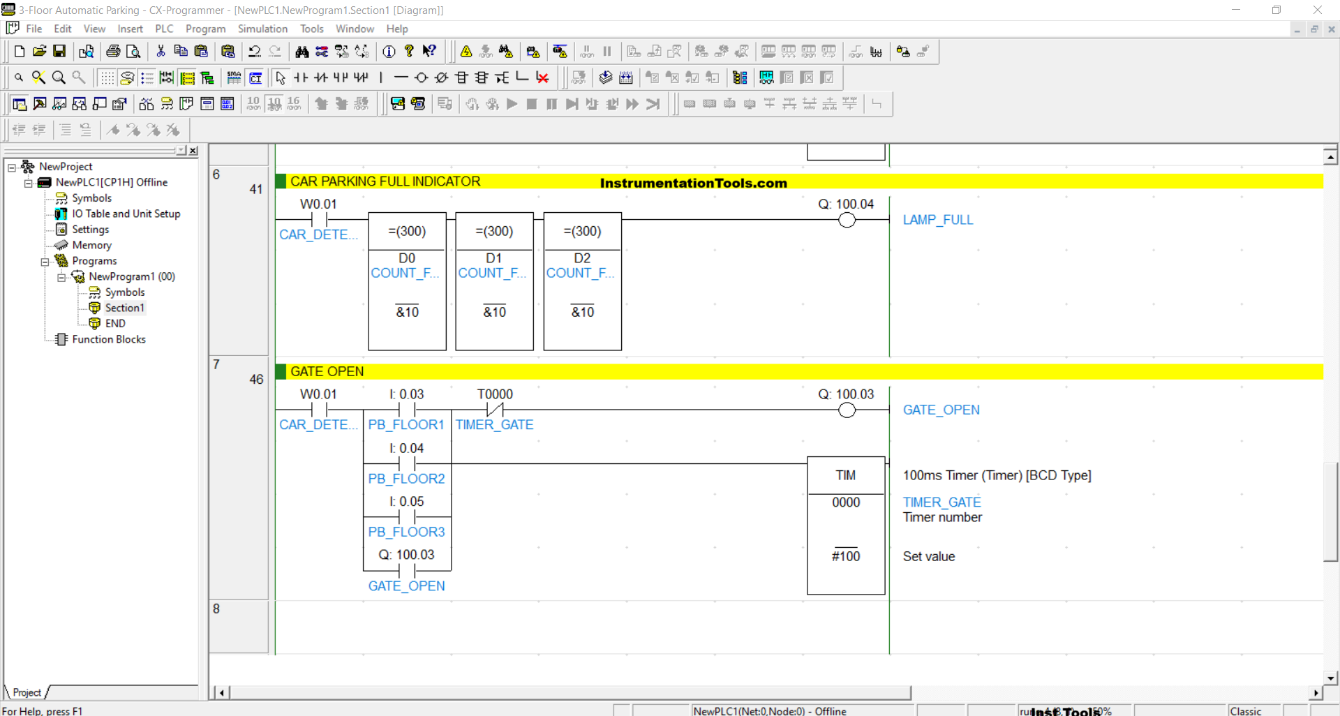

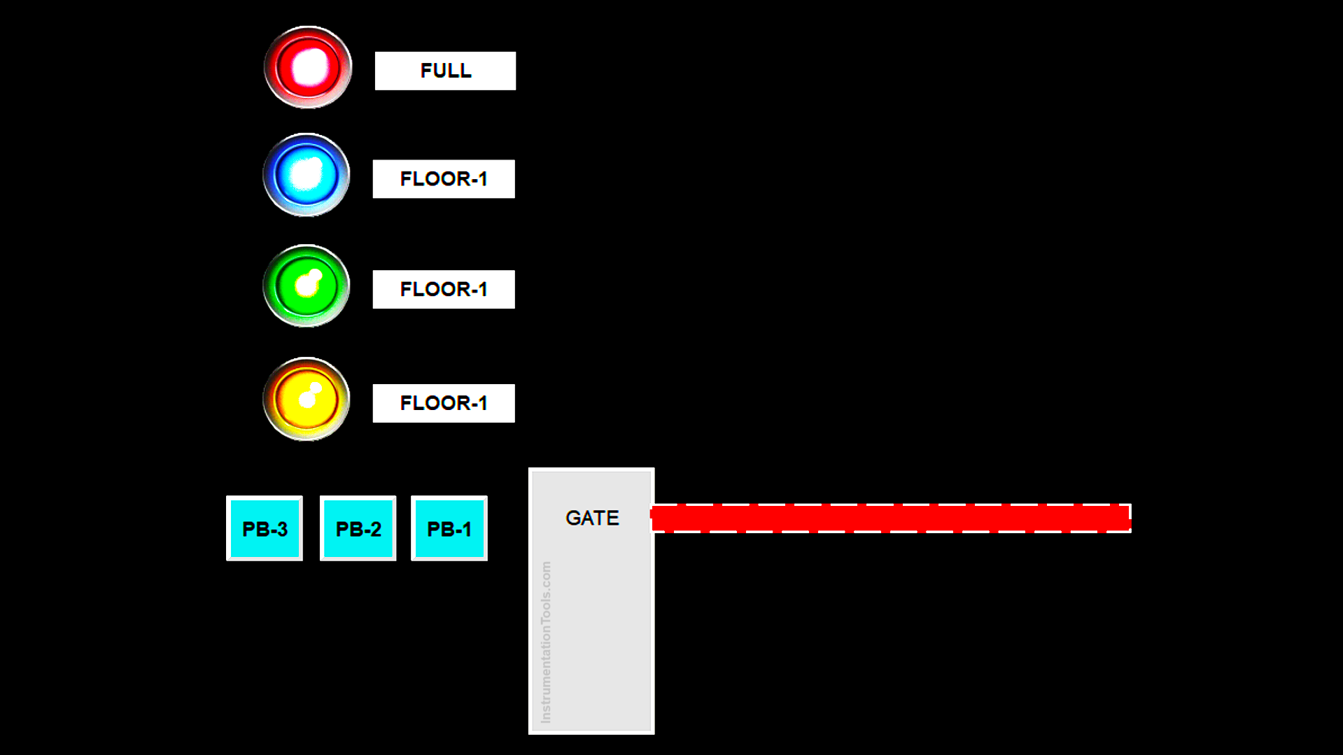

RUNG 6 (CAR PARKING FULL INDICATOR)
The output LAMP_FULL (100.04) will be ON if the NO contact of the memory bit CAR_DETECT (W0.01) is in the HIGH state and the value of the memory words COUNT_FLOOR1 (D0), COUNT_FLOOR2 (D1), and COUNT_FLOOR3 (D2) is Equal To “10”.
RUNG 7 (GATE OPEN)
When the NO contact of the memory bit CAR_DETECT (W0.01) is in the HIG state and any of the buttons PB_FLOOR1 (0.03), PB_FLOOR2 (0.04), or PB_FLOOR3 (0.05) is pressed, the output GATE_OPEN (100.03) will be ON and the TIMER_GATE (T0000) timer will start counting up to 10 seconds.
The GATE_OPEN (100.03) will remain ON even if any of the buttons PB_FLOOR1 (0.03), PB_FLOOR2 (0.04), PB_FLOOR3 (0.05) have been released. When the TIMER_GATE (T0000) timer has finished counting, the GATE_OPEN (100.03) output will become OFF due to the Interlock.
