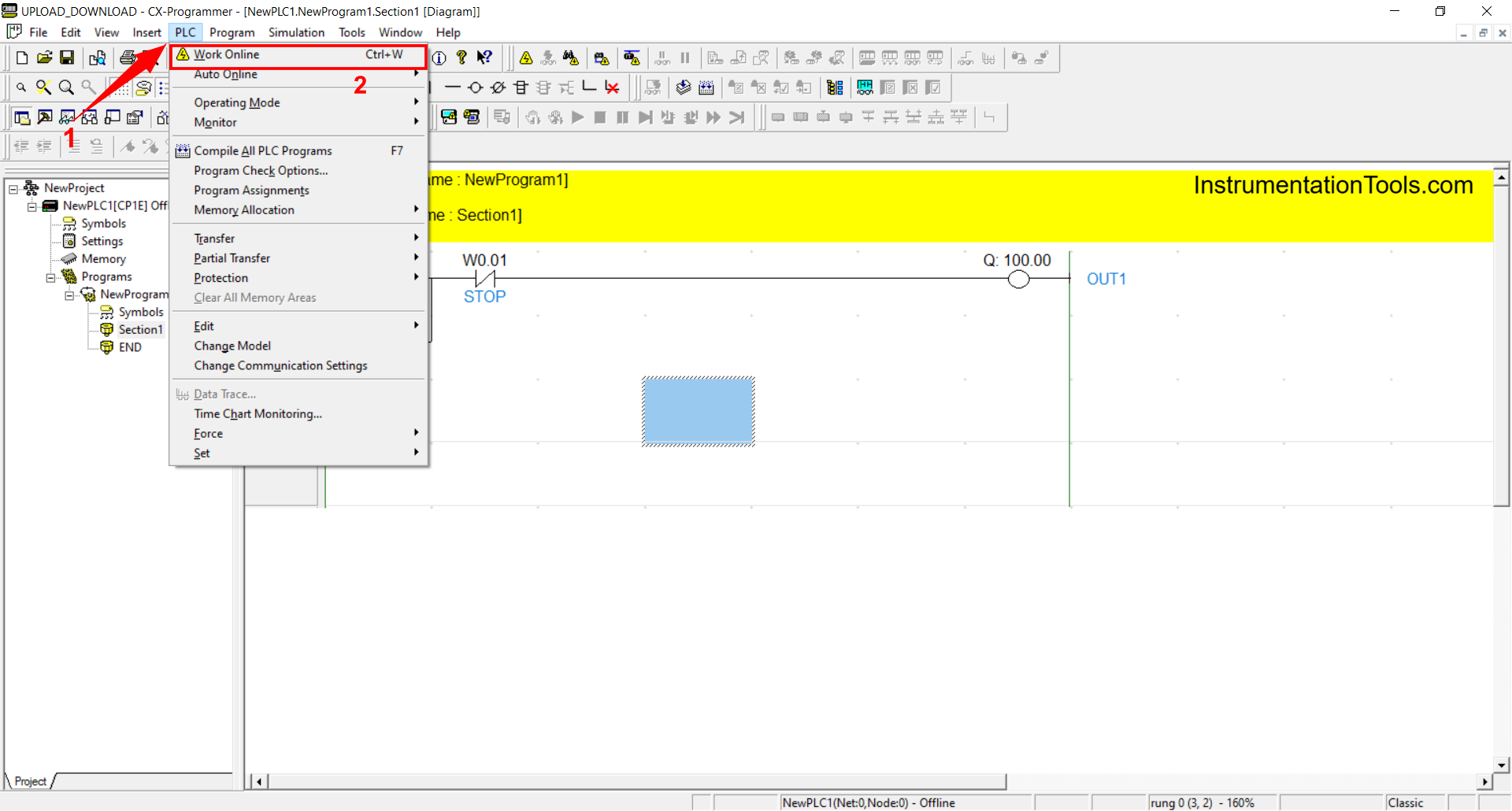

1. Open the project you want to download.

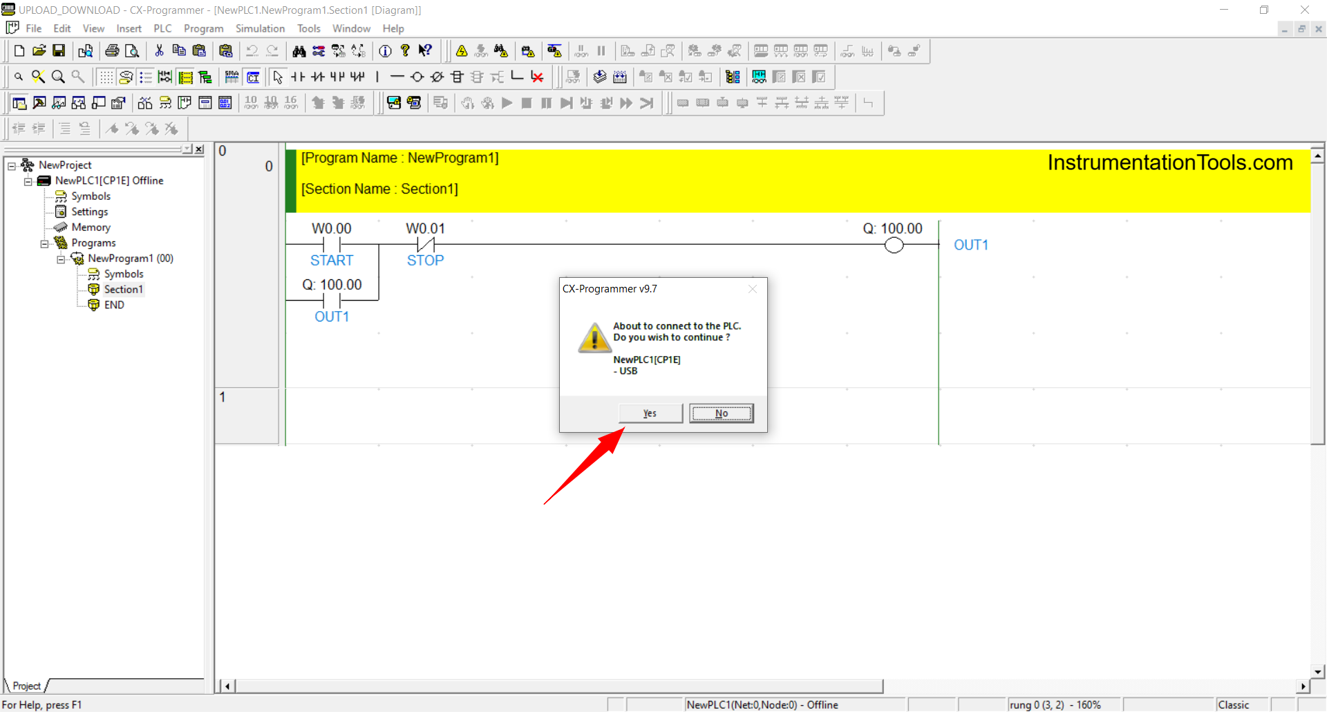

2. Click the “PLC” menu → Select “Work Online” (or use the CTRL+W shortcut).
3. Select “Yes” if prompted with: “About to connect to the PLC. Do you wish to continue?”

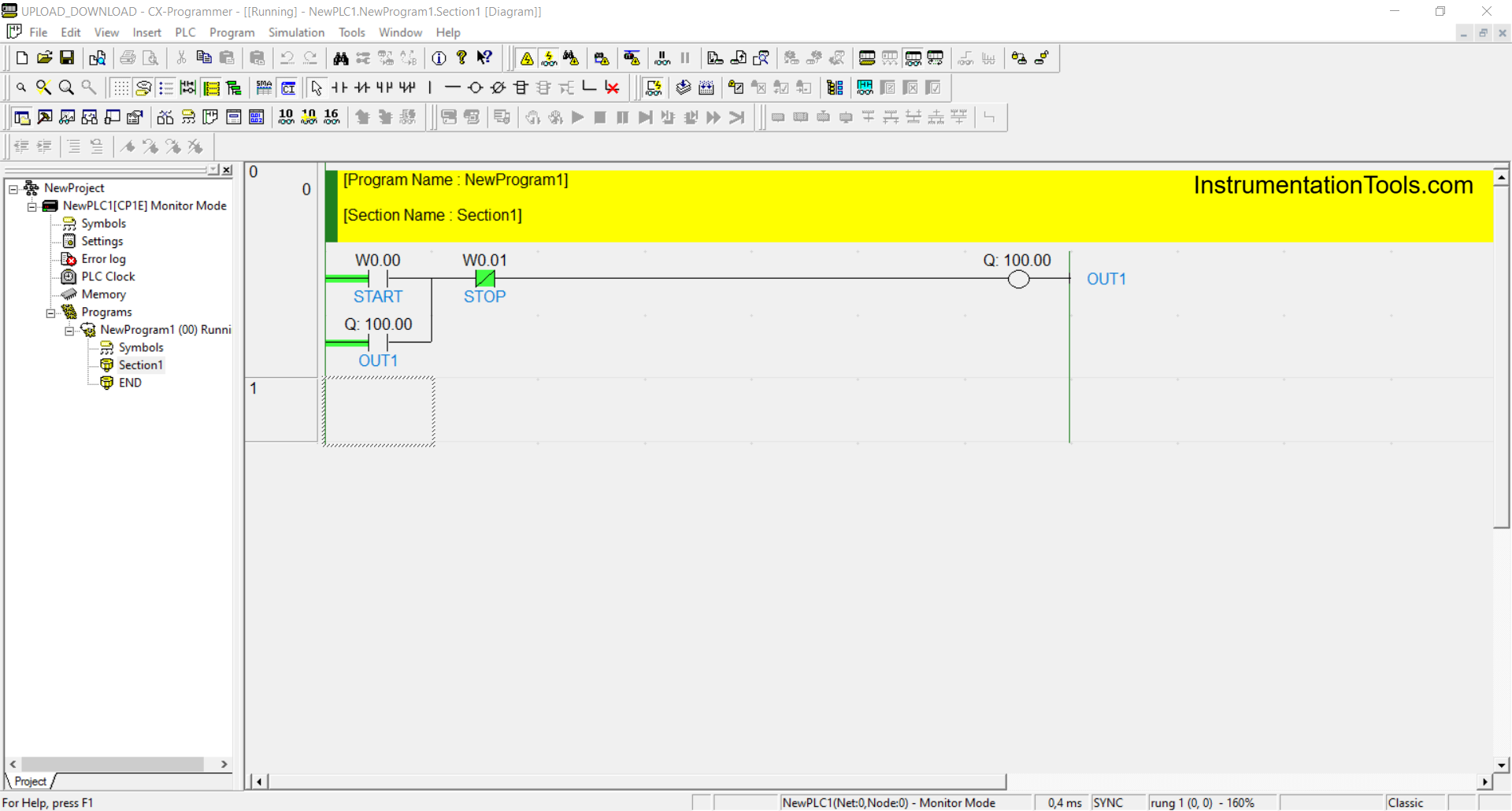

4. Once the interface changes as shown in the image below, the PLC is connected to the PC.

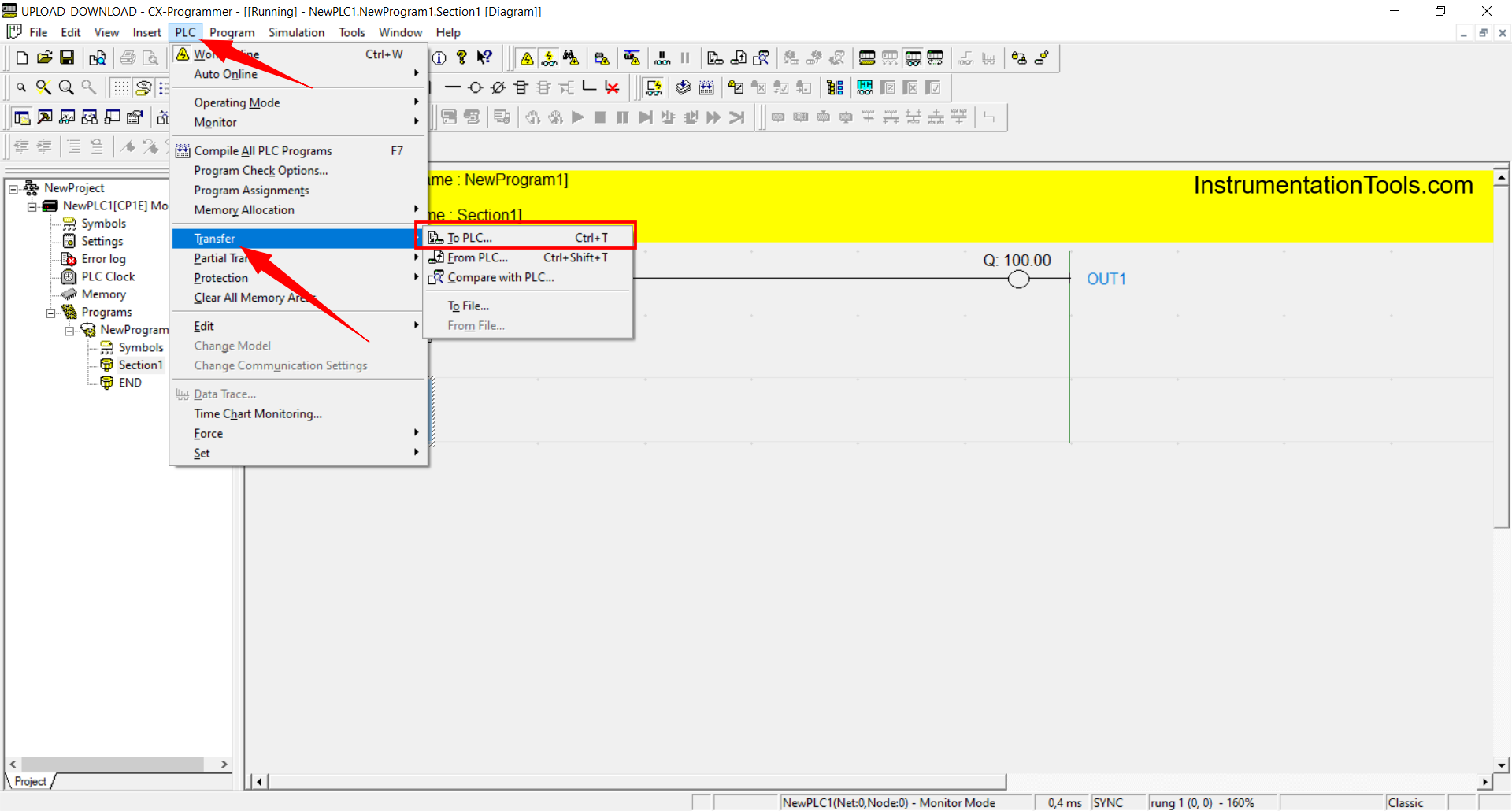

5. To transfer the program to the PLC: Go to “PLC” menu → Click “Transfer” → Select “To PLC” (or use CTRL+T).

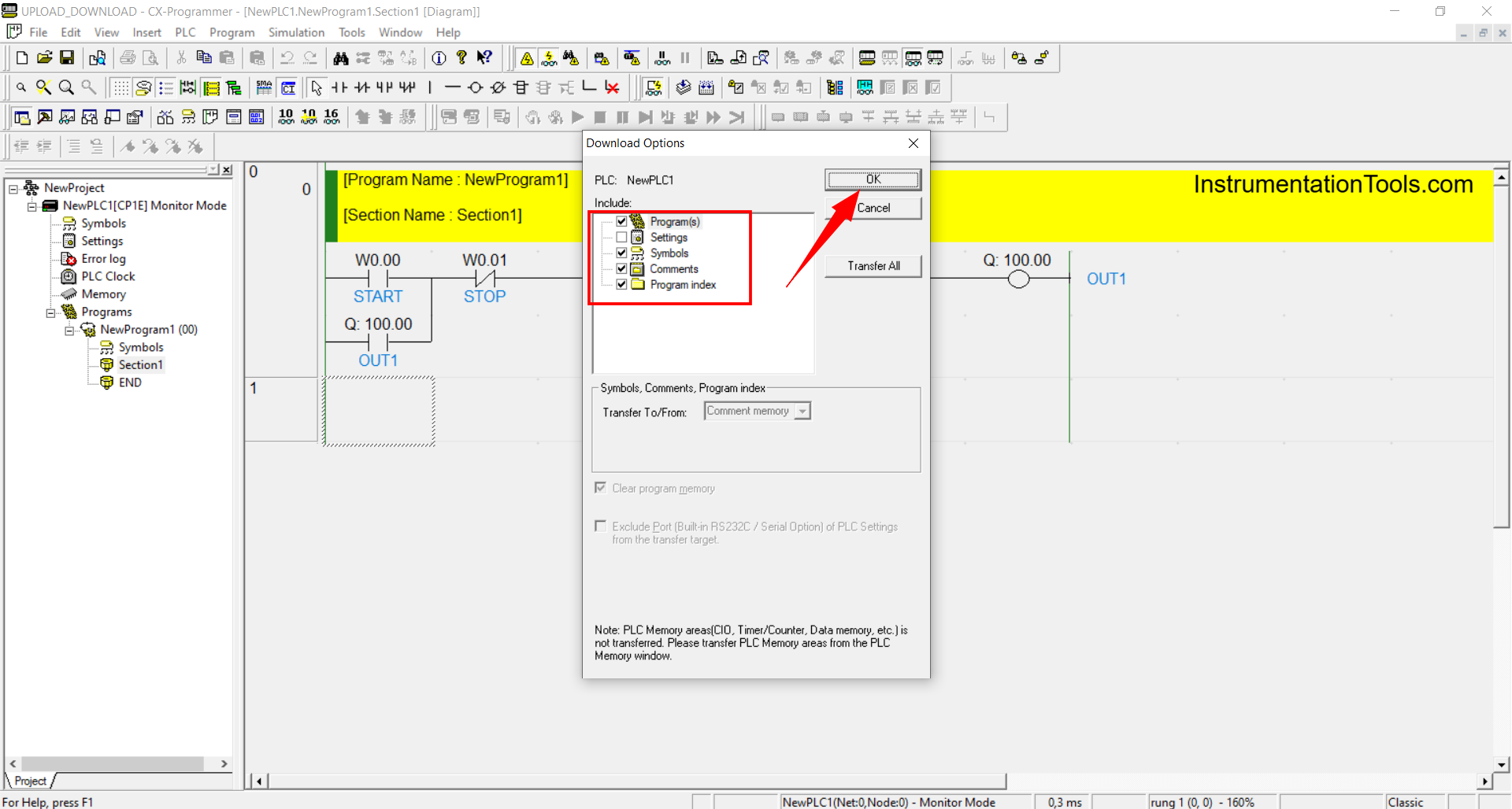

6. Select the Program section to be transferred, then select “OK”

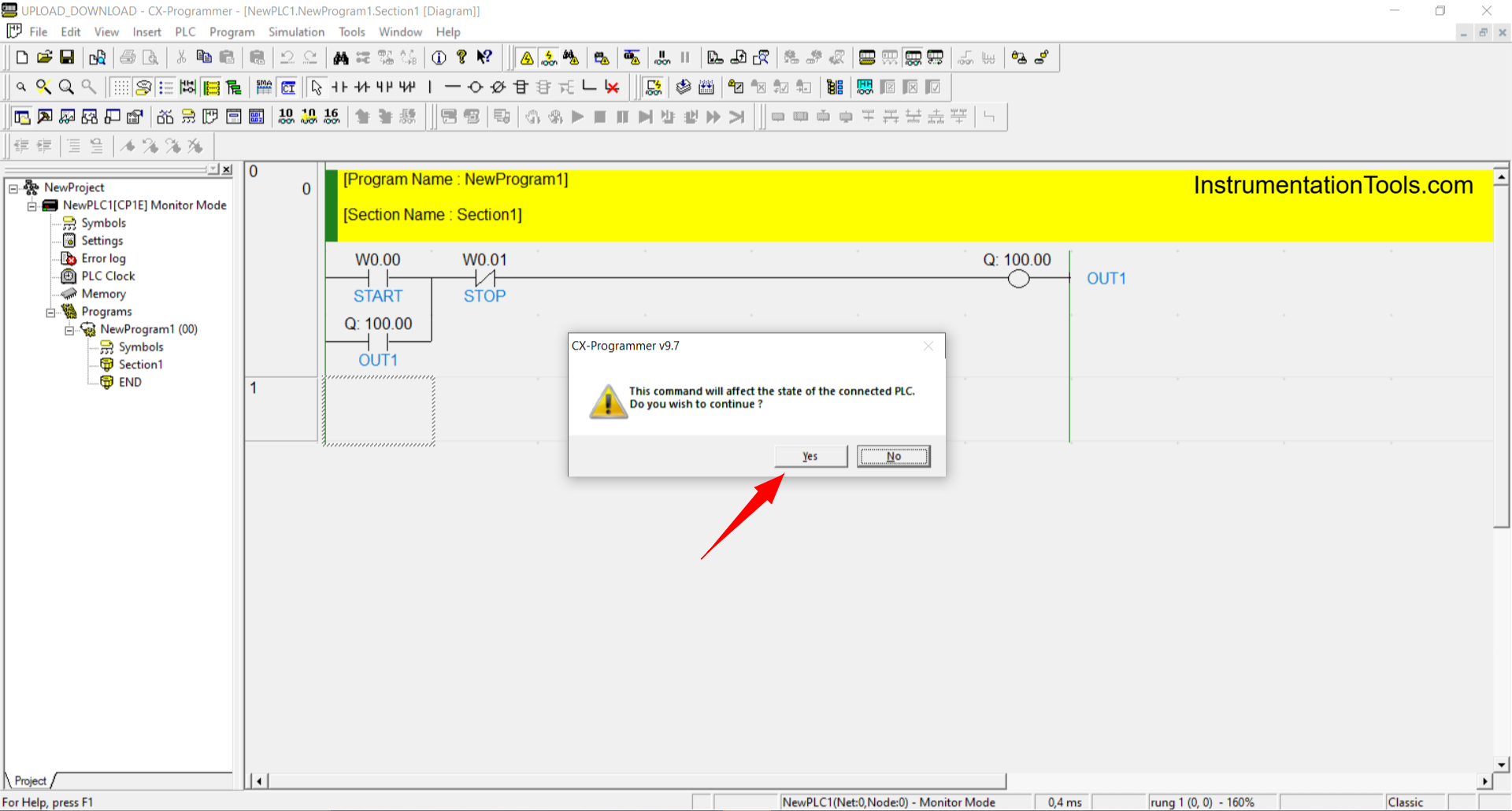

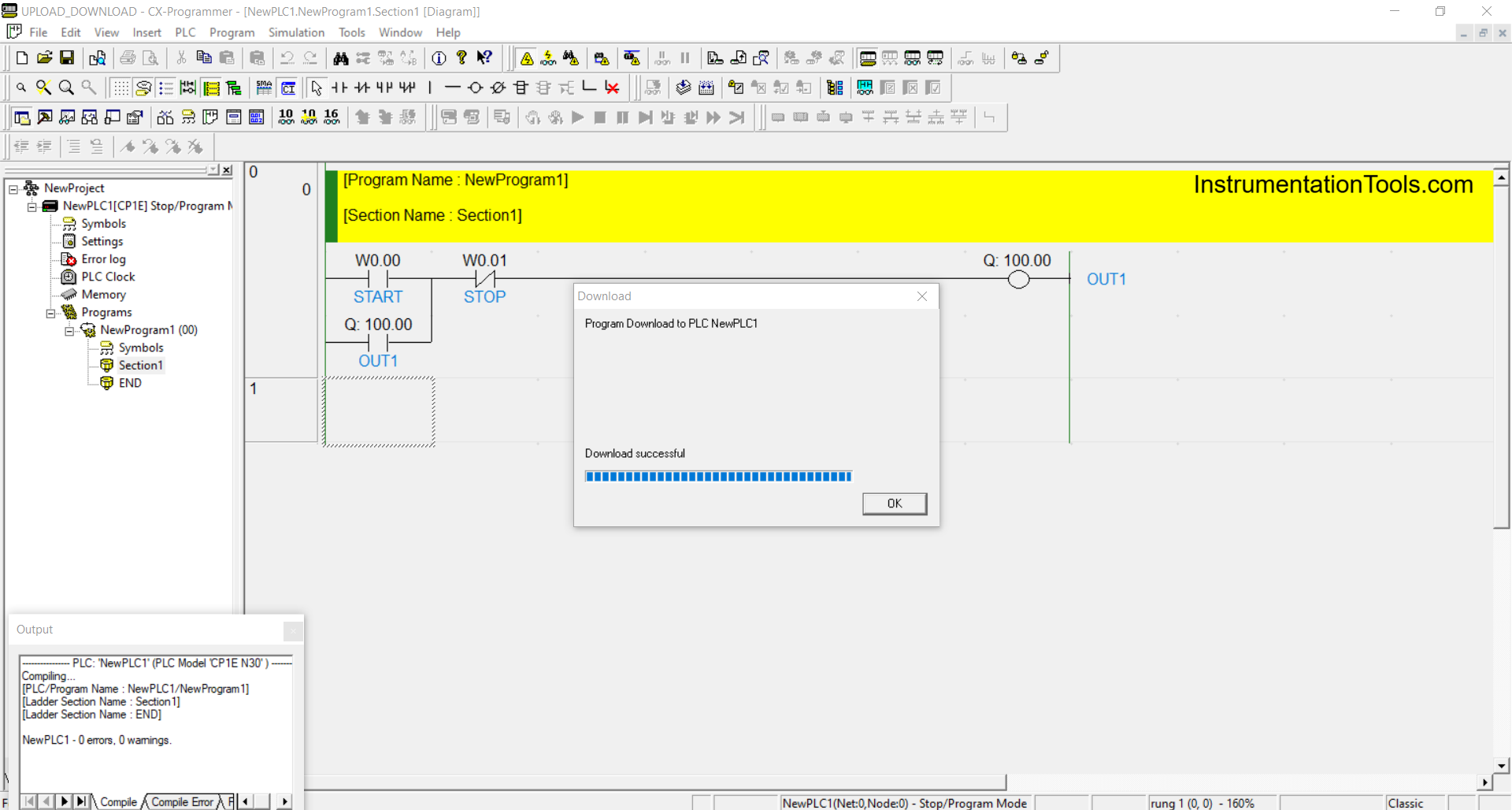

7. Select “Yes” if prompted with: “This command will affect the state of the connected PC. Do you wish to continue?”

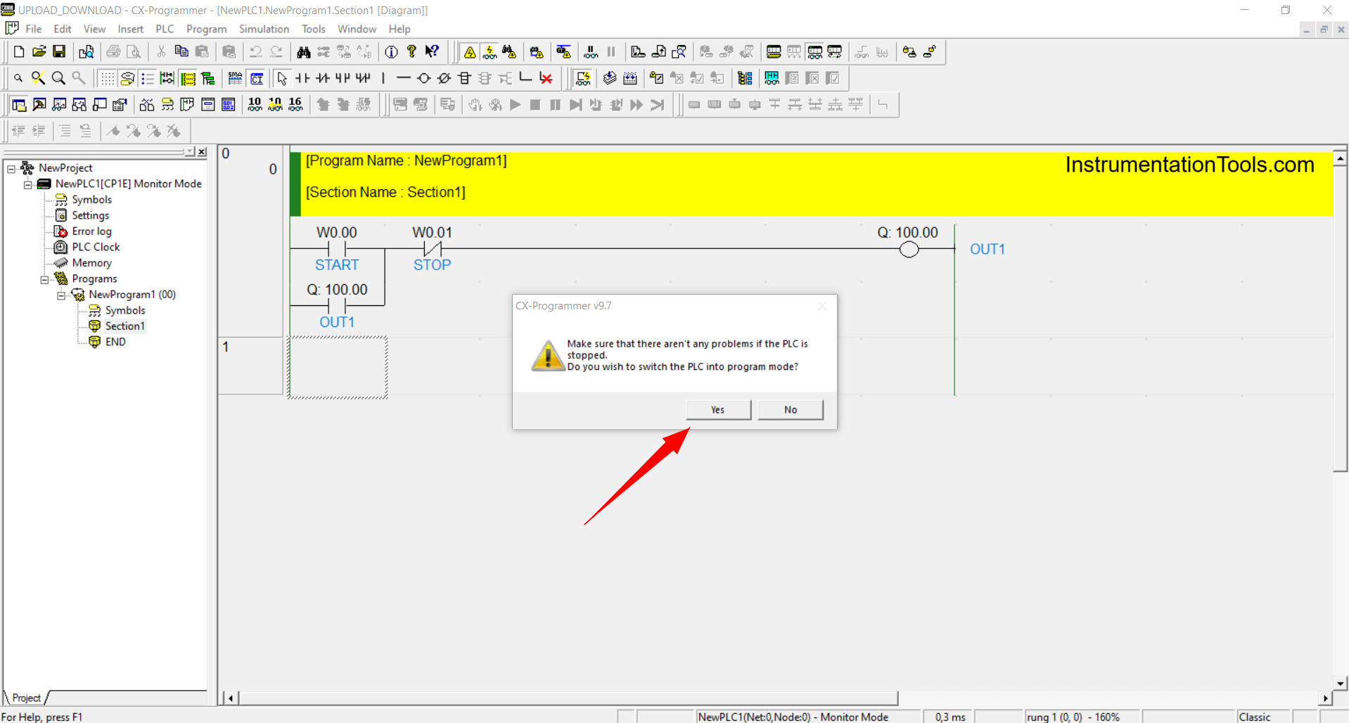

8. Select “Yes” if prompted with: “Do you wish to switch the PLC into Program Mode?”
9. Click “OK” when the notification “Download successful” appears.
10. Select “Yes” if prompted with: “Do you wish to return the PLC to Monitor Mode?”
11. The program download process is complete.

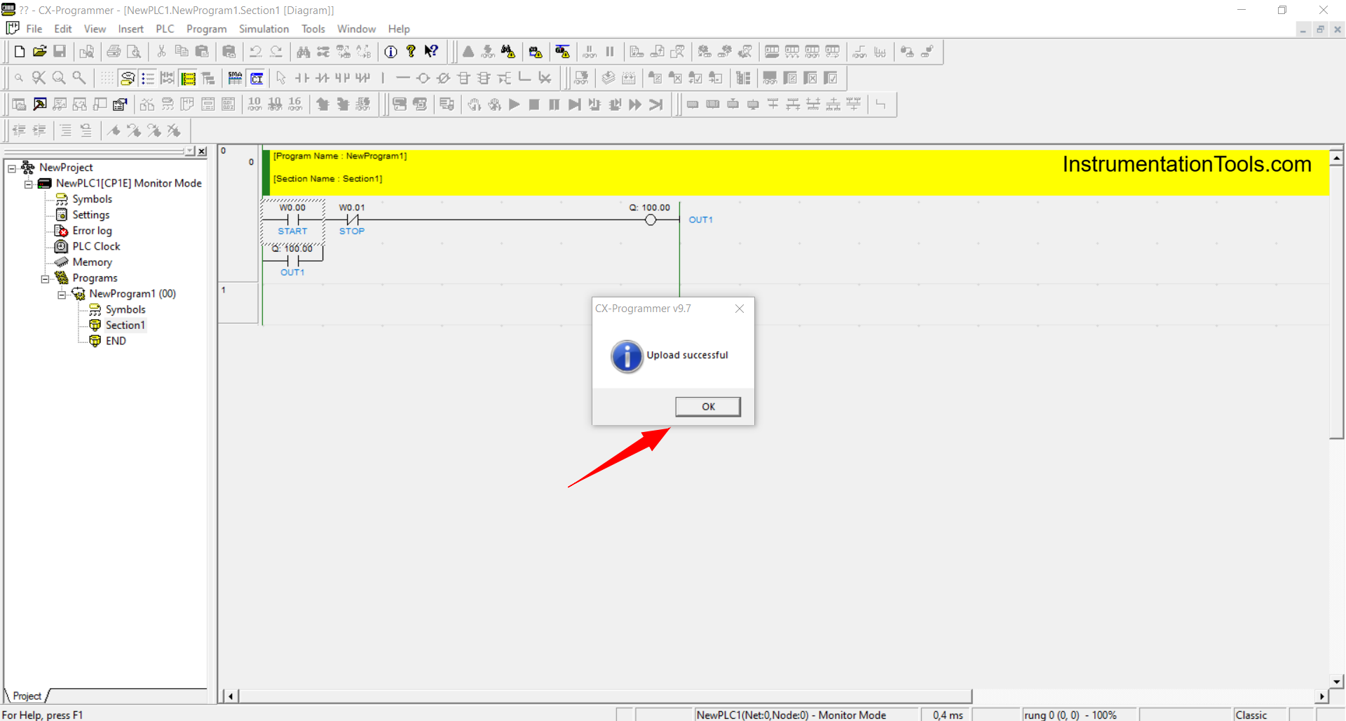

Upload PLC Program
1. Open CX-Programmer.

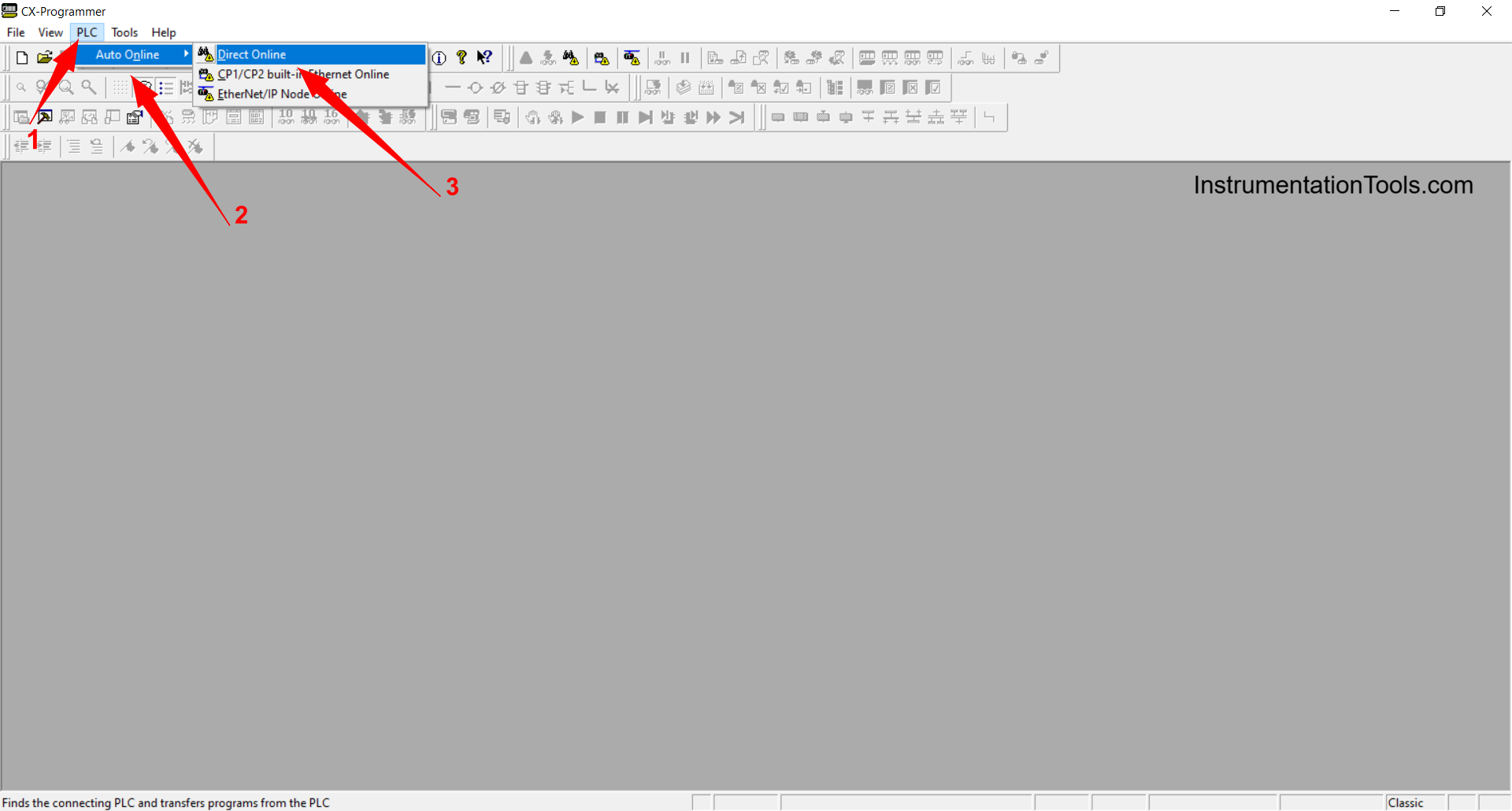

2. To connect the PC to the PLC: Select the “PLC” menu → click “Auto online” → click “Direct Online”.

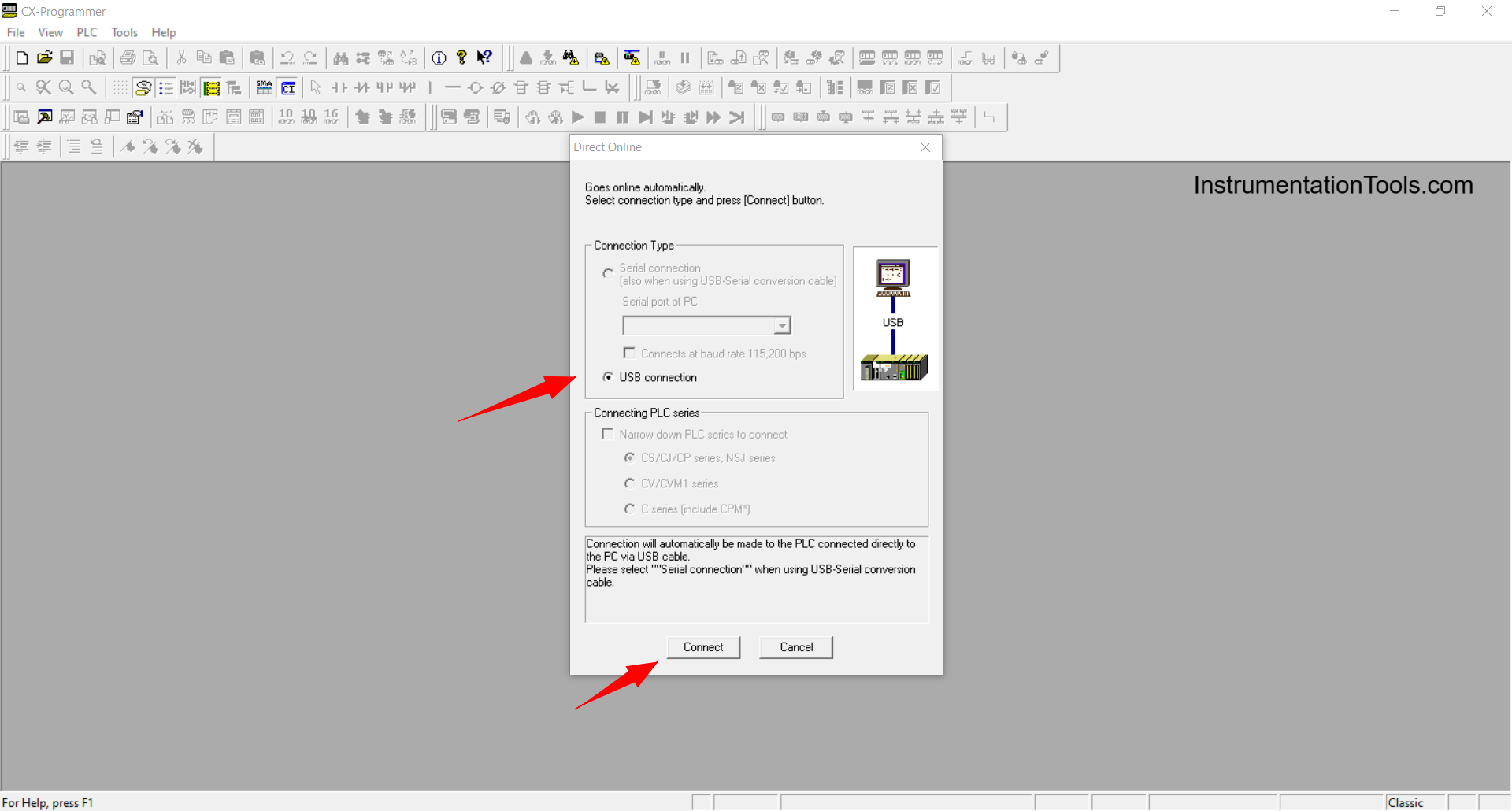

3. Select “USB Connection” → click “Connect”.

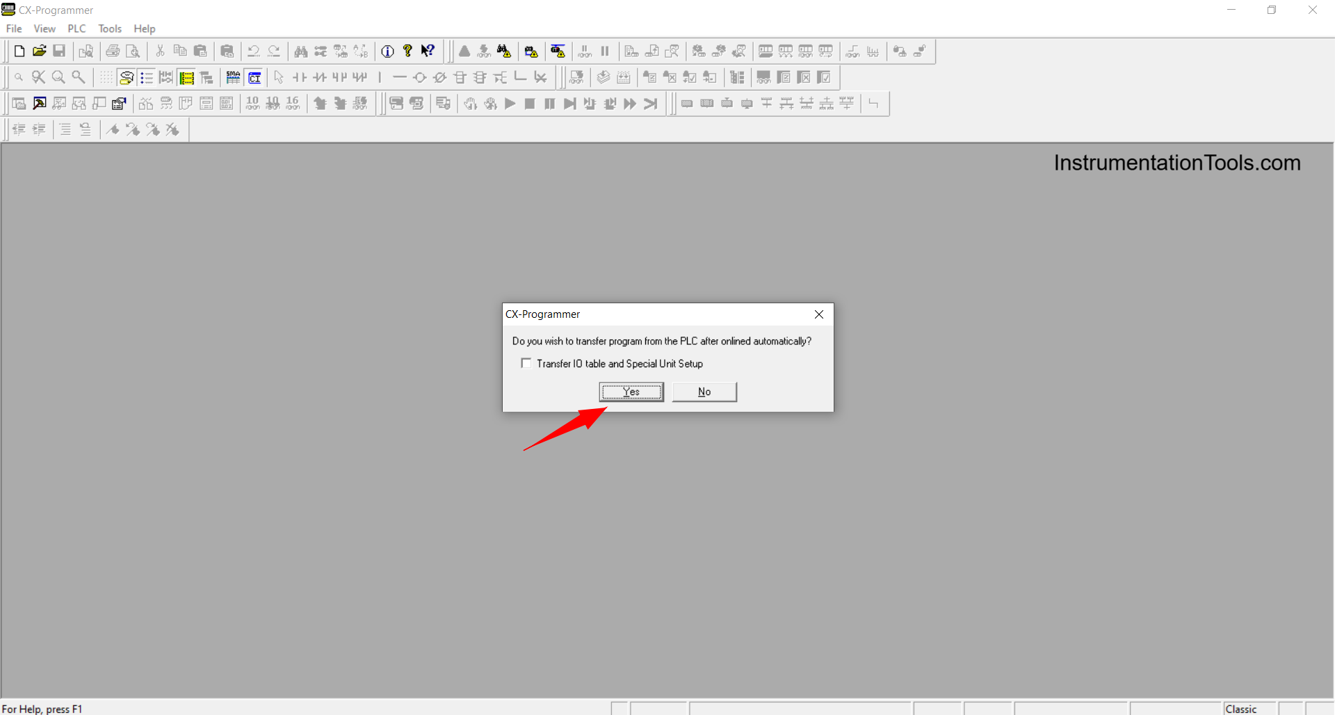

4. Select “Yes” if the notification appears: “Do you wish to transfer the program from the PLC automatically after online?”
5. The system will search for PLCs connected to the PC.
6. When the program has been successfully uploaded, a notification will appear: “Upload successful“.
