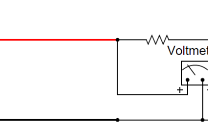

As discussed above, an external cable is used to connect the thermocouple and the temperature transmitter. This extra cable can be made from copper or from the respective thermocouple type material.
So, if we use the extra cable made from copper, then two more junctions will form because the thermocouple material is different from this cable as shown in the above figure. This will affect the generation of milli volts and thus we get the wrong temperature measurement readings.
So, in this case, we will require a special type of cable called thermocouple extension cable or thermocouple compensation cable in order to avoid measurement error.
