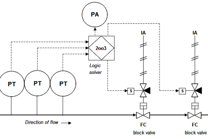

Hardware Fault Tolerance (HFT)
Hardware fault tolerance provides protection against Random failures. If it would result in additional failures and lead to decreased overall process safety, then the HFT may be reduced. This shall be justified and documented.
The justification shall provide evidence that the proposed architecture is suitable for its intended purpose and meets the safety integrity requirements.

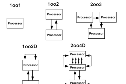

The HFT requirements in below table represent the minimum system or, where relevant, the SIS subsystem redundancy.
Depending on the application, device failure rate, and proof-testing interval, additional redundancy can be required to satisfy the failure measure for the SIL of the SIF.

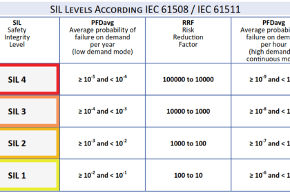

SIL LevelMinimum required HFT
SIL 1 (Low/High/Continuous demand mode)0
SIL 2 (Low demand mode)0
SIL 2 (High/Continuous demand mode)1
SIL 3 (Low/High/Continuous demand mode)1
SIL 4 (Low/High/Continuous demand mode)2
As per IEC: 61511 “For all subsystems (for example, sensor, final elements, and non-PE logic solvers) excluding PE logic solvers the minimum fault tolerance specified in the above table may be reduced by one”.
