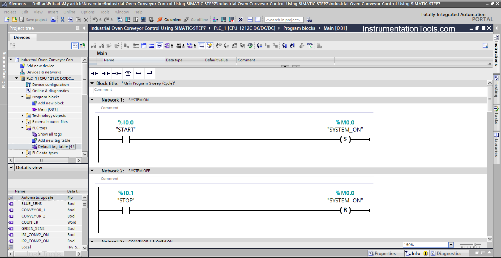

NETWORK 1 (SYSTEM ON)
In this network, the memory bit SYSTEM_ON (M0.0) will be in a HIGH state when the START (I0.0) button is pressed. Even if the START (I0.0) button is released, the memory bit SYSTEM_ON (M0.0) will remain in a HIGH state. This is because it uses the SET OUTPUT instruction.
NETWORK 2 (SYSTEM OFF)
In this network, if the STOP button (I0.1) is pressed, then the memory bit SYSTEM_ON (M0.0) will be in a LOW state. This is because it uses the RESET OUTPUT instruction.

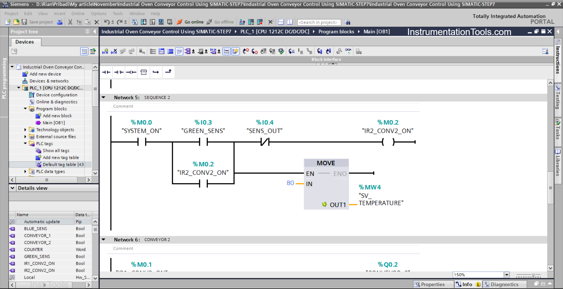

NETWORK 5 (SEQUENCE 2)
In this Network, the memory bit IR2_CONV2_ON (M0.2) will be in a HIGH state when the NO contact of memory bit SYSTEM_ON (M0.0) and Sensor GREEN_SENS (I0.3) are in a HIGH state.
The memory word SV_TEMPERATURE (MW4) will have a value of “80” due to the MOV instruction.
The memory bit IR2_CONV2_ON (M0.2) will remain in a HIGH state even if the sensor GREEN_SENS (I0.3) is in a LOW state. Because it uses Latching.
And the memory bit IR2_CONV2_ON (M0.2) will become LOW when the NC contact of Sensor SENS_OUT (I0.4) is in a HIGH state.

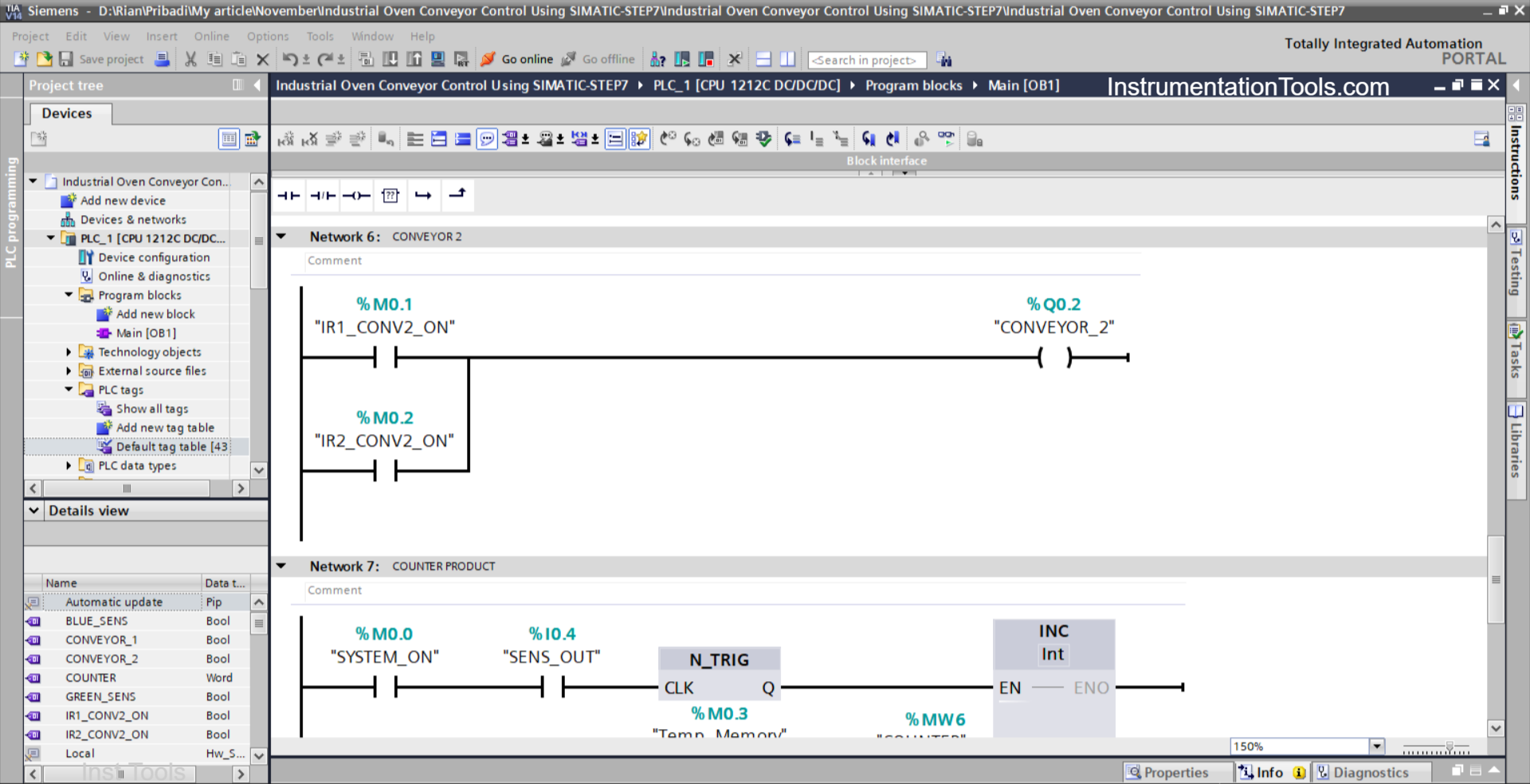

NETWORK 6 (CONVEYOR 2)
In this Network, if the NO contact of memory bit IR1_CONV2_ON (M0.1) or IR2_CONV2_ON (M0.2) is in a HIGH state, then Output CONVEYOR_2 (Q0.2) will be turned ON.
NETWORK 7 (COUNTER PRODUCT)
In this Network, the value in the memory word COUNTER (MW6) will increment (+1) if the NO contact of the memory bit SYSTEM_ON (M0.0) and the sensor SENS_OUT (I0.4) are in a HIGH state.
NETWORK 8 (RESET COUNTER)
In this Network, the MOV instruction will move the value “0” to the memory word COUNTER (MW6) when the RESET_COUNTER button (I0.5) is pressed.
