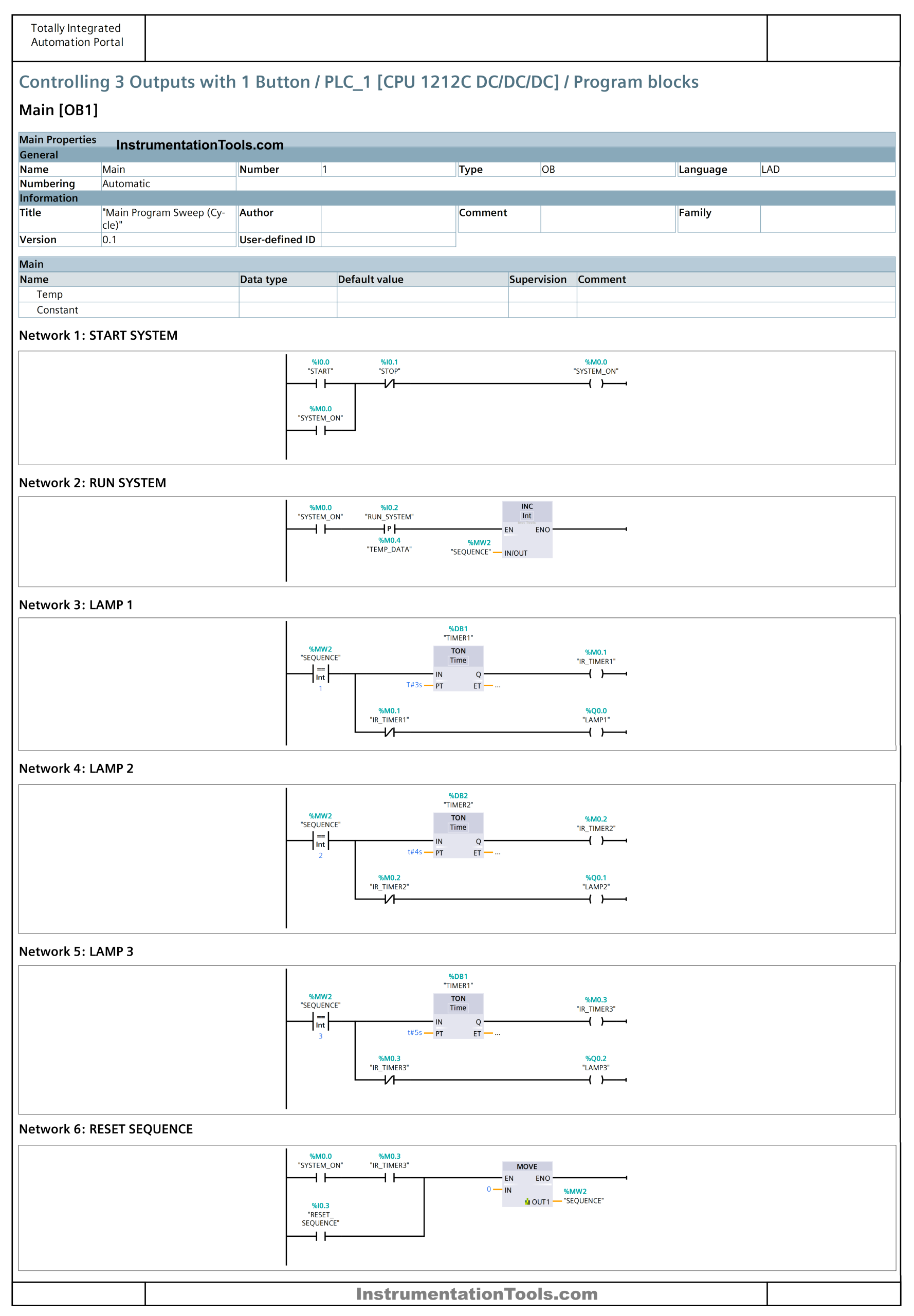

NETWORK 1 (START)
In this Network, the memory bit SYSTEM_ON (M0.0) changes to a HIGH state when the START (I0.0) button is pressed. Even though the START (I0.0) button has been released, the memory bit SYSTEM_ON (M0.0) will remain in a HIGH state. Because it uses Latching.
If the STOP (I0.1) button is pressed, the memory bit SYSTEM_ON (M0.0) will be in a LOW state.
NETWORK 2 (RUN SYSTEM)
The value in the memory word SEQUENCE (MW2) will increase (+1) when the NO contact of the memory bit SYSTEM_ON (M0.0) is in a HIGH state and the RUN_SYSTEM (I0.2) button is pressed.
The INC instruction will add (+1) to the data in the memory word SEQUENCE (MW2).

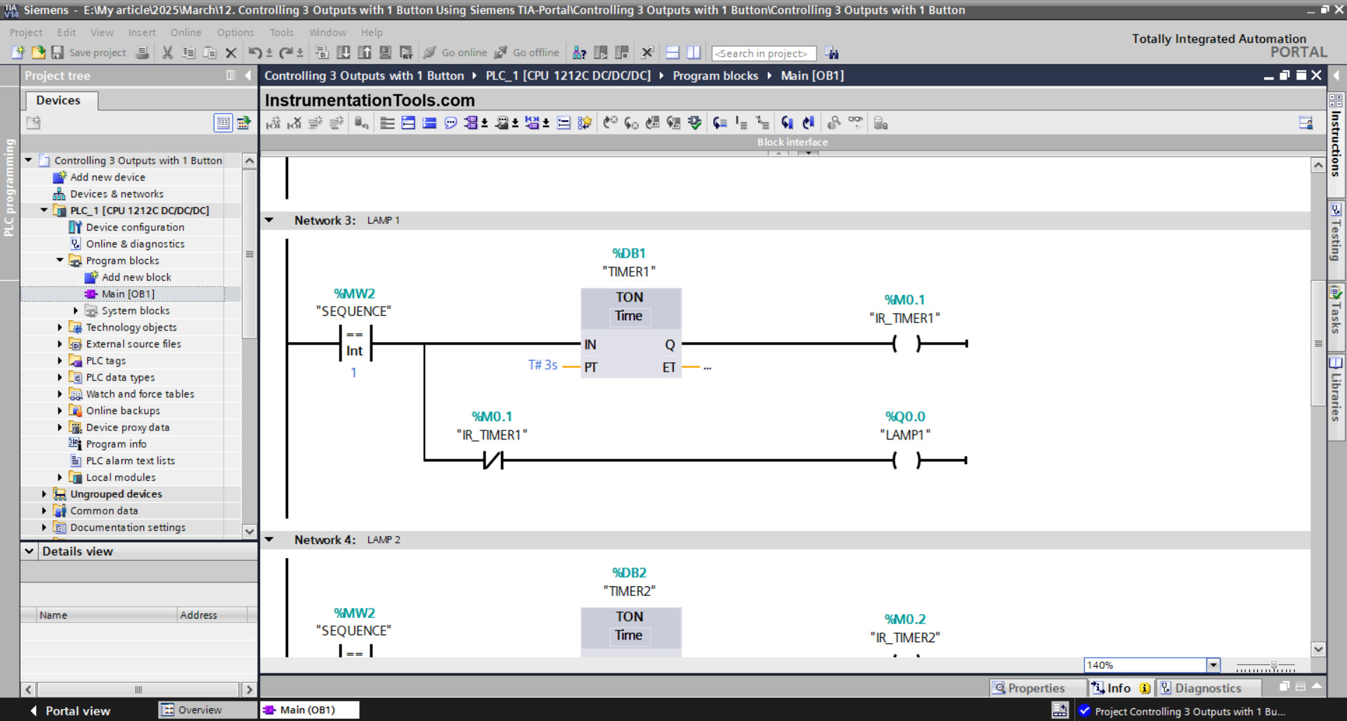

NETWORK 3 (LAMP 1)
The output LAMP1 (Q0.0) will be ON when the value in the memory word SEQUENCE (MW2) is Equal To “1.
The TIMER1 (DB1) timer will count up to 3 seconds, and when the timer has finished counting, the memory bit IR_TIMER1 (M0.1) will be in a HIGH state.
Next, the output LAMP1 (Q0.0) becomes OFF due to the Interlock of the memory bit IR_TIMER1 (M0.1).

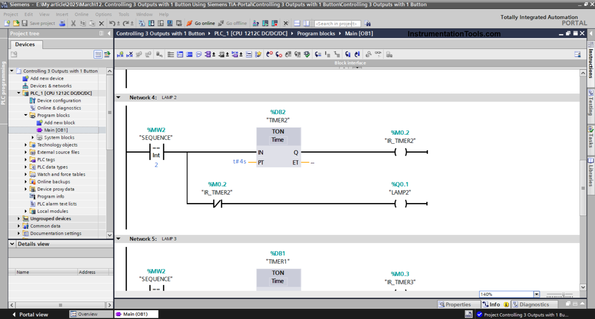

NETWORK 4 (LAMP 2)
The output LAMP2 (Q0.1) will be ON when the value in the memory word SEQUENCE (MW2) is Equal To “2”.
The timer TIMER2 (DB2) will count up to 4 seconds, and when the timer has finished counting, the memory bit IR_TIMER2 (M0.2) will be in a HIGH state.
Next, the output LAMP2 (Q0.1) becomes OFF due to the Interlock of the memory bit IR_TIMER2 (M0.2).

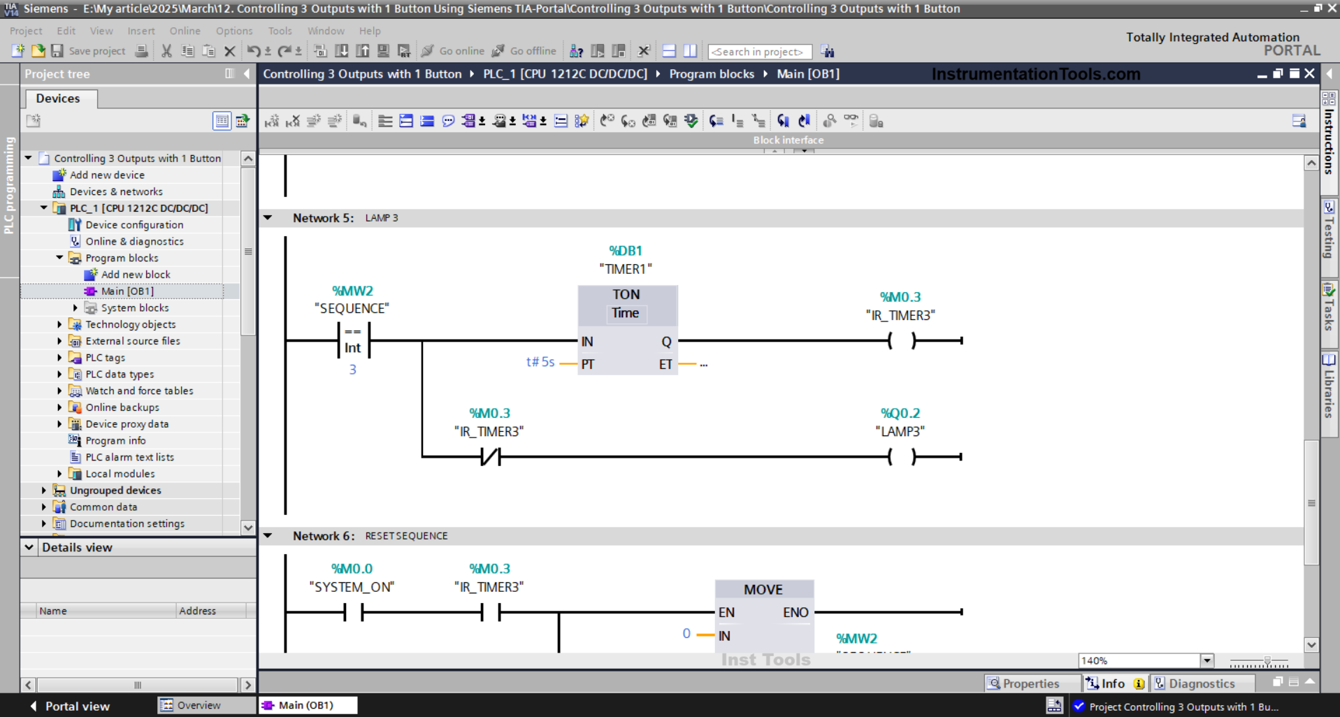

NETWORK 5 (LAMP 3)
The output LAMP3 (Q0.2) will be ON when the value in the memory word SEQUENCE (MW2) is Equal To “3”.
The timer TIMER1 (DB2) starts counting up to 5 seconds, and when the timer has finished counting, the memory bit IR_TIMER3 (M0.3) will be in a HIGH state.
Next, the output LAMP3 (Q0.2) becomes OFF due to the Interlock of the memory bit IR_TIMER3 (M0.3).

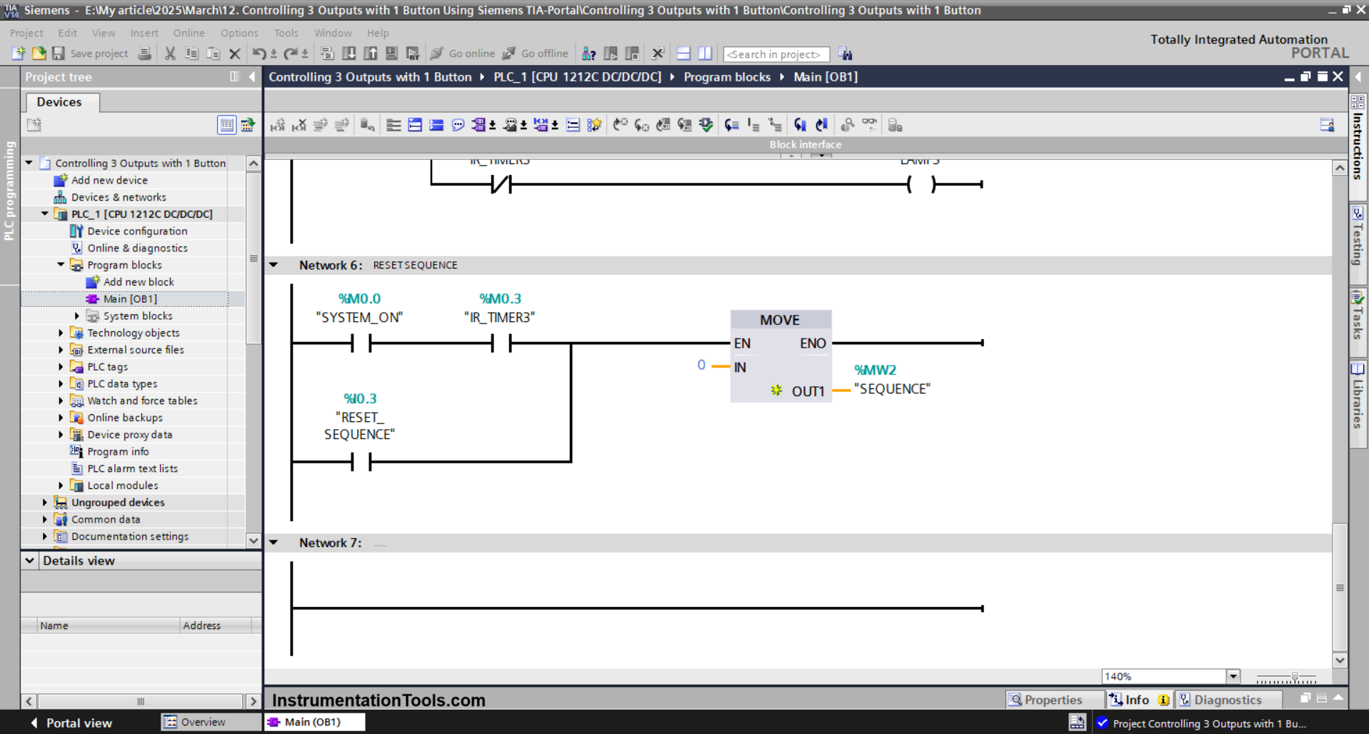

NETWORK 6 (RESET SEQUENCE)
In this Network, the memory word SEQUENCE (MW2) becomes “0” when the NO contact of the memory bits SYSTEM_ON (M0.0) and IR_TIMER3 (M0.3) are in HIGH state, or if the RESET_SEQUENCE (I0.3) button is pressed.
The MOVE instruction will move the value “0” to the memory word SEQUENCE (MW2).
