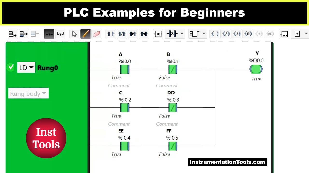

Design a PLC ladder logic for the following Logic Circuit.
We are using toggle Inputs to control the output.

Program I/O Details
Digital Inputs:
  • A: I0.0
  • B: I0.1
  • C: I0.2
  • D: I0.3
  • E: I0.4
  • F: I0.5
Digital Outputs:
  • Y: Q0.0
Ladder Logic
Here is the answer to the given PLC problem.
Example of PLC Programming based on Logic Circuit
PLC Program Description
  • For this application, we have used EcoStruxure Machine Expert Basic software for programming.
  • In the above program, Normally Open Contacts are used for inputs A, C, and E and Normally Closed Contacts are used for inputs B, D, F.
  • Input A and Input B are connected in series, thus implementing AND Logic Gate.
  • AND Logic Gate is implemented with Input C and Input D as these Inputs are connected in series.
  • Input E and Input F are connected in series, thus implementing AND Logic Gate.
  • AB, CD, and EF are connected in parallel, thus implementing OR Logic Gate.
  • For the output Y (Q0.0) to be ON, either Input A should be ON and Input B should be OFF or Input C should be ON and Input D should be OFF or Input E should be ON and Input F should be OFF.
  • If Input B, Input D, and Input F are turned ON, output Y (Q0.0) will not turn ON as Normally Closed Contacts used for these Inputs will be in True state and does not allow the signal to flow and pass to the output.
