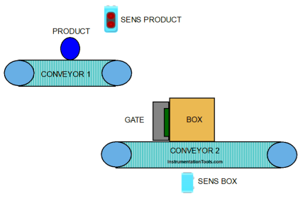

Problem Description
  1. Objects are moving on the conveyor
  2. We need to pack five objects in the empty box. When the empty box is filled. It is carried to the storage via a conveyor belt
  3. Implement this automatic cycle in PLC using ladder language.
Problem Diagram
PLC Program to Count and Pack Objects from Conveyor
Problem Solution
Mostly inductive and proximity sensors are used to detect objects. Here we mount proximity sensor for the object detection and empty box detection.
Inductive sensor are mostly used to detect metal objects and proximity sensors are used to detect metal objects and other objects.
Here one proximity sensor is for object detection and other is for box detection. Objects are moving on conveyor 1 and boxes are moving on conveyor 2.
We will write automatic cycle for this application in PLC. So when empty box is detected on conveyor 2, conveyor 1 will be ON automatically.
And when box is filled with five objects, conveyor belt 2 will start automatically.
Note:- Here we consider simple application for counting and packaging application. We considered an proximity sensor for simplicity. Proximity sensor will sense the object and counter will count the total objects.
