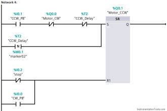

Network 1:
In this network we have used ON delay timer (generate on delay) for MOTOR 1(Q0.0).
When the status of the SWITCH 1(I0.0) changes from 0 to 1 the timer instruction will be executed and it will activate the MOTOR 1(Q0.0) after 10s delay.
Network 2:
In this network we have used off delay timer (generate off delay) for MOTOR 2(Q0.1).
When the status of the SWITCH 2(I0.1) changes from 0 to 1 the timer instruction will be executed and it will activate the MOTOR 2(Q0.1) immediately.
Also when the SWITCH 2(I0.1) status changes back to 0 then programmed time (PT) will start and after time MOTOR 2(Q0.1) will be OFF.
Network 3:
In this network we have used pulse timer (generate pulse) for MOTOR 3(Q0.2).
When the status of the SWITCH 3(I0.2) changes from 0 to 1 the timer instruction will be executed and it will activate the MOTOR 3(Q0.2) immediately.
In this case even new positive edge is detected, the status of the MOTOR 3(Q0.2) is not affected as long as programmed time (PT) is running.
Network 4:
In this network we have used accumulator timer (accumulator time) for MOTOR 4(Q0.3).When the status of the SWITCH 4(I0.3) changes from 0 to 1 the timer instruction will be executed and MOTOR 4(Q0.3) will start after 10s.
The MOTOR 4(Q0.2) will remain ON, even when the input status changes back to 0.The Reset (I0.4) is necessary to reset the timer or accumulated time.
