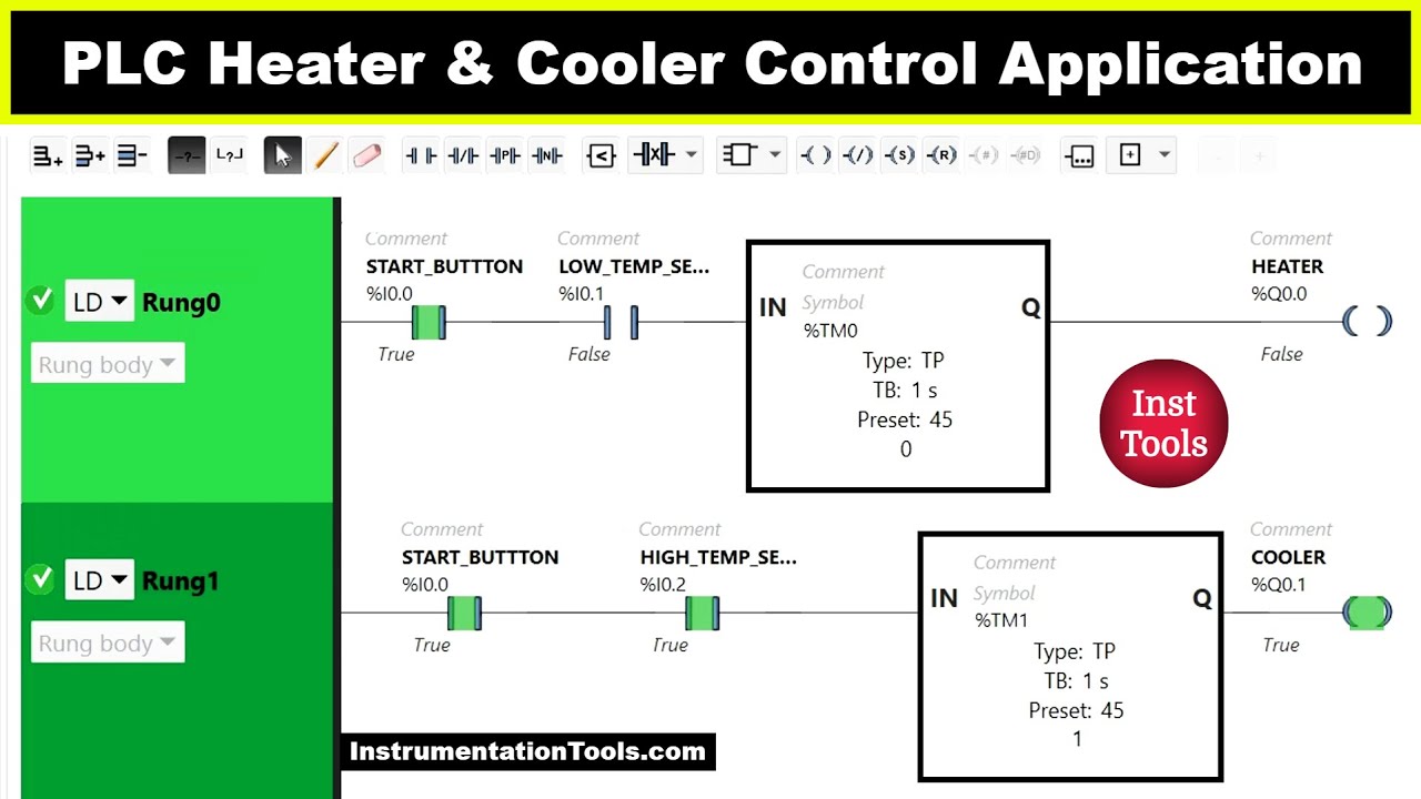

Problem Statement:
We are using one toggle switch and two Sensors to control the Heater and Cooler.
If the Low-Temperature Sensor gets activated (temperature is below 25 degrees), a heater should run for 45 seconds.
If the High-Temperature Sensor gets activated ( Temperature is above 30 degrees), a cooler should run for 45 seconds.

We have used Normally Open Contact for the Start Button(I0.0), Low-Temperature Sensor (I0.1), and High-Temperature Sensor (Q0.2).
In Rung 0:
  1. Normally Open Contact is used for Start Button (I0.0) and Low Temperature Sensor (I0.1) to turn ON the output Heater (Q0.0).
  2. Timer-type TP is used to Turn ON the output Heater (Q0.0) for a limited time.
In Rung 1:
  1. Normally Open Contact is used for the Start Button (I0.0) and High Temperature Sensor (I0.2) to turn ON the output Cooler (Q0.1).
  2. Timer-type TP is used to Turn ON the output Cooler (Q0.1) for a limited time.

Rung 0:
Heating and cooling Ladder Logic
When the Start Button (I0.0) is turned ON and the Low-Temperature sensor (I0.1) gets activated, the signal will flow through the Start Button (I0.0) and Low-Temperature Sensor (I0.1) as Normally Open Contact is used for the Start Button (I0.0) and Low-Temperature Sensor (I0.1).
Temperature Control Systems PLC Logic
The output Heater (Q0.0) turns ON for 45 seconds because Timer Function Block type TP is used to turn ON the output Heater (Q0.0) for a limited time and the time is set to 45 seconds. After 45 seconds, the output Heater (Q0.0) will turn OFF.
Rung 1:
High Temperature Sensor PLC Program
When the Start Button (I0.0) is turned ON and the High-Temperature sensor (I0.2) gets activated, the signal will flow through the Start Button (I0.0) and High-Temperature Sensor (I0.2) as Normally Open Contact is used for the Start Button (I0.0) and High-Temperature Sensor (I0.2).
Low Temperature Sensor PLC Programming
The output Cooler (Q0.1) turns ON for 45 seconds because Timer Function Block type TP is used to turn ON the output Cooler (Q0.1) for a limited time and the time is set to 45 seconds. After 45 seconds, the output Cooler (Q0.1)  will turn OFF.
